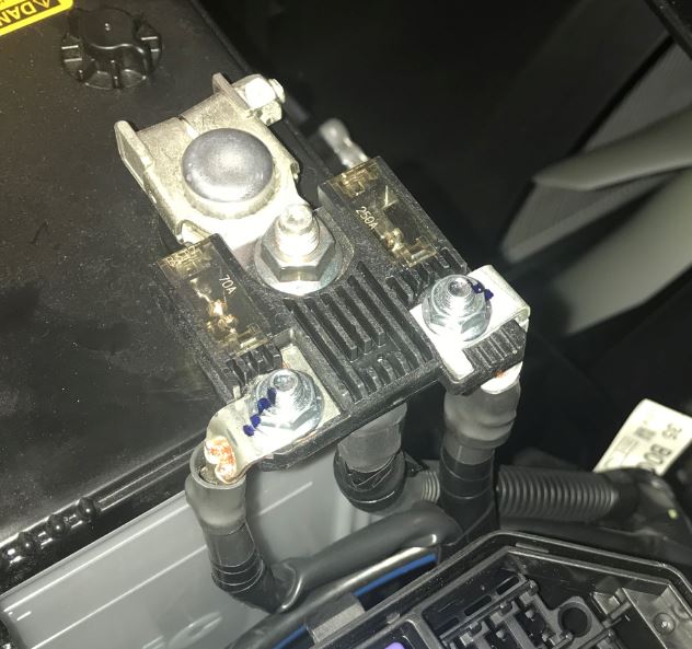

I'm planning something similar but I can't figure out a great way to pull power off the battery terminal on my 2021 ORP. Perhaps this fancy fused terminal connector in my photo may be new? I haven't found even one photo like it using Google image search.
How did you connect the thick red cable supplying your Aux circuit to the battery terminal? I can't tell because it is hidden behind the red plastic protector in your photo. Did you tie in behind the existing 70amp or 250amp fuses? Or did you figure out something that connected your cable to the battery without going though these fuses?
Here's a picture of mine without the protective red cover.

When I first looked under the red protective cover, I thought the same thing....
How am I going to connect with these fuses!
I told myself I don’t want to jeopardize any part of my electrical system!
I did not go thru those fuses!
When you take the positive cable off, you will notice that all are actually 3 separate parts.
I made a small little copper buss bar with 2 holes drilled in it. It is long enough after it is connected under the positive cable that I can connect my red cable that goes to my auxiliary circuit.
Don’t tie your auxiliary to either of those fuses!
You don’t want to draw power from those.
Thanks! I'm definitely wanting to tap the battery directly. I've never yet taken the positive terminal off the battery. I'll do that today and figure out what you're saying about 3 parts and fabricating a buss bar. This topic is probably worth a dedicated thread but I'm still working through my required initial 15 posts. :-/

[MENTION=628603]WakeTime[/MENTION],
These photos may help you a little more.
In the first photo, notice at the end of the crude arrow, there is the small buss bar under the OEM fuse terminal to make the connection to the battery terminal for the cable to the auxiliary circuit.
This way all power to the auxiliary circuit is bypassing those fuses.
Hope these help.
