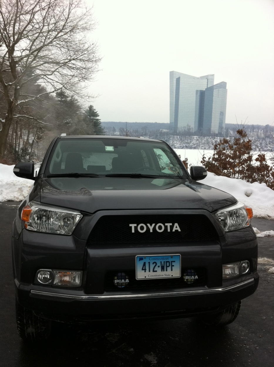

What a PITA it is to get off that grill! Anyway, the Satoshi Grill is officially finished and I'll be sure to post some pictures tomorrow! :bigok:

Is that the grill from the previous links (I think Jesse1983 posted it), or is it a grill craft?
Yes it is the same grill as they used (and not the GrillCraft). Takes some time to cut it down and get it just right, but the time spent was def worth it. :D
Here ya go...
Wow ThirdToy! You nailed it! Great job:bravo:
Thanks Gary! Hope ya don't mind I copied you with the Piaa 510's as well :hello:

Thanks Kevin! Yea I actually live less than 2 minutes from Mohegan Sun. That picture I posted is from the end of my driveway. :banana:
