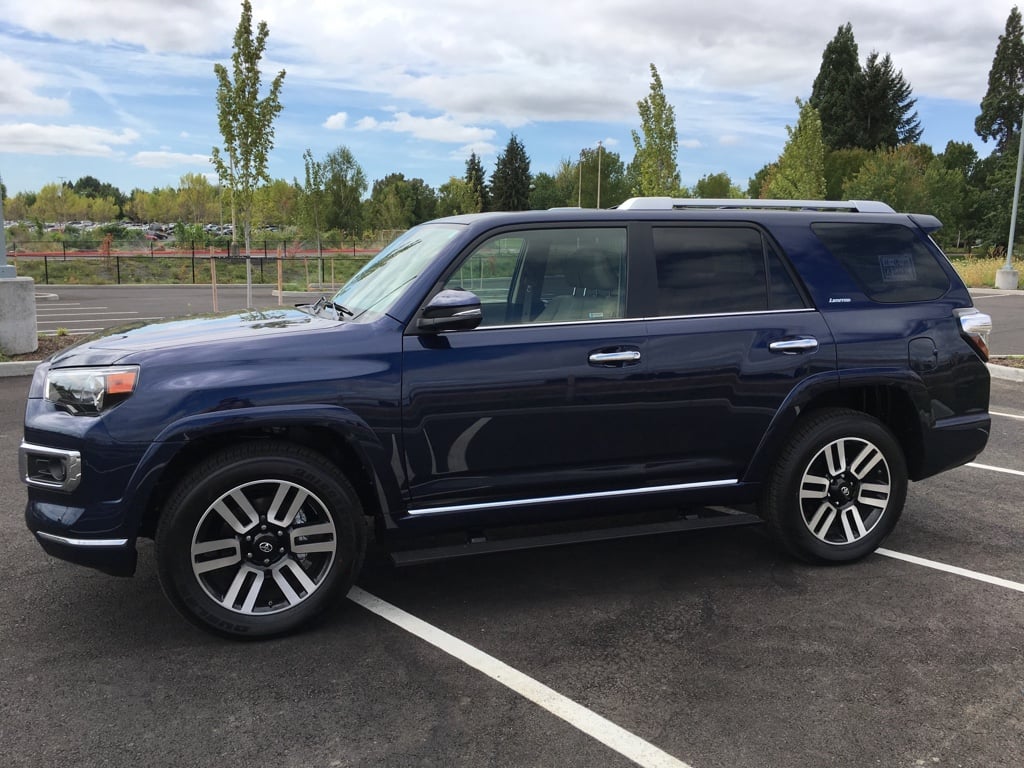

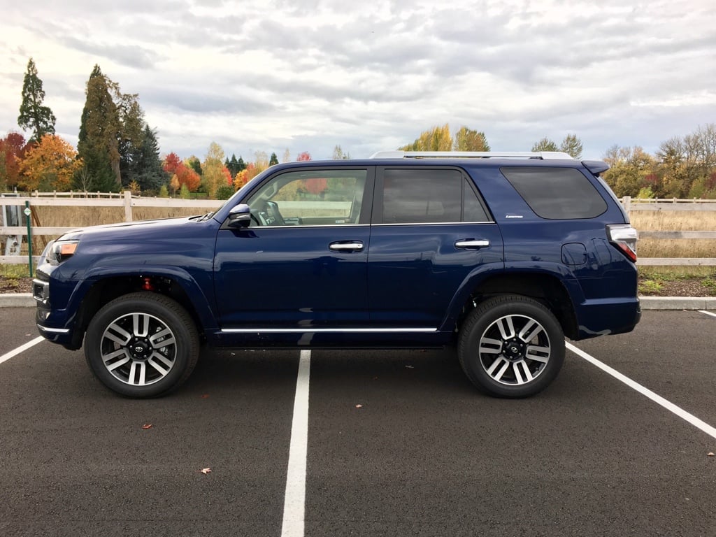

Below are before and after the lift, and pics of the installed components

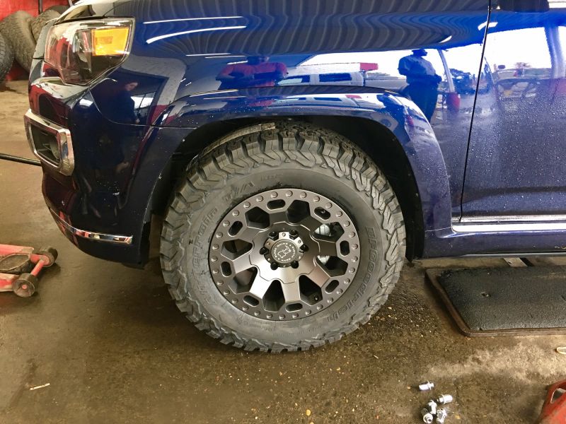

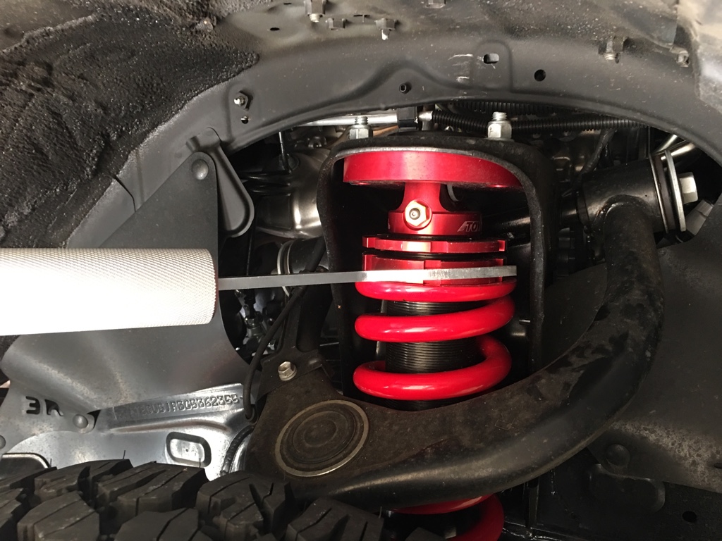

Wheel/Tire fit test
Went to Les Schwab to do a fit test on the front left wheel/tire combo and of course it rubbed really bad. Has been raining lately, so I hadn't went out and removed the mud flaps and pushed the fender liner forward. Will have to do that tonight.
Went with LT285/65-18 BFG KO2's, and 18x9 Black Rhino Warlords in Gunmetal.
Also my Toytec Boss Ultimate lift(with the 2.5 upgrade in front, as the normal ones are on back order) should be in tomorrow or Saturday. Will prob try to put that on first before having the wheels and tires installed, just to be safe.
The UCA's looked ok, and weren't too close to the tire, so should be ok there too.
Here is what it looked like:

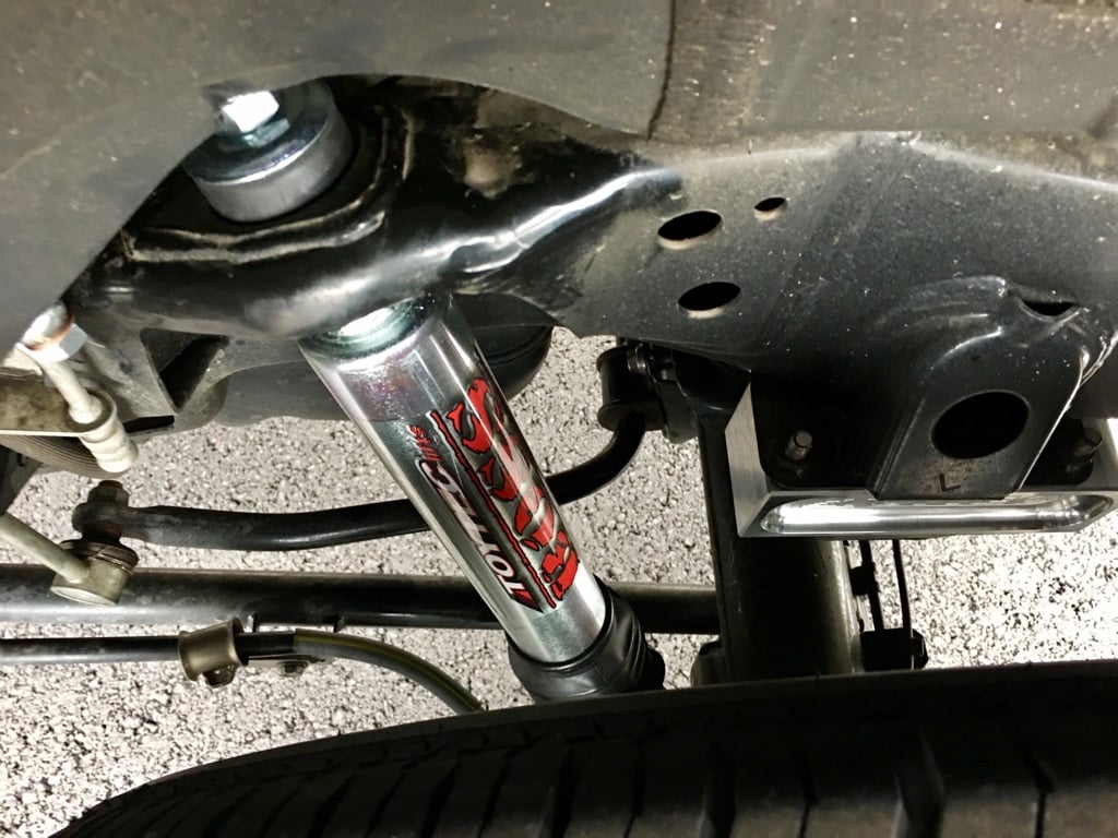

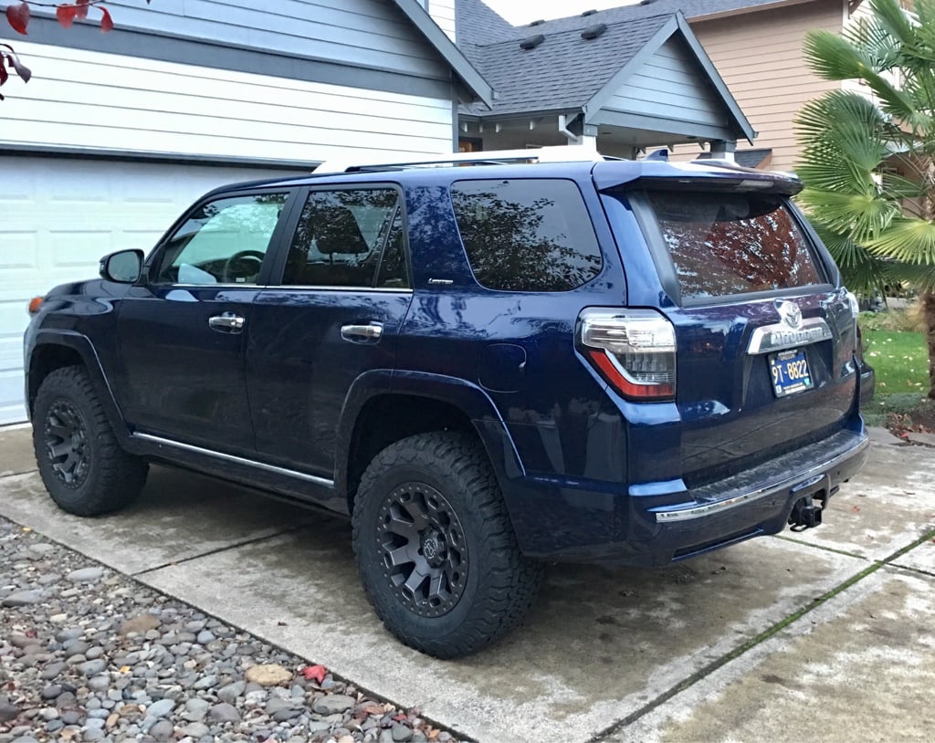

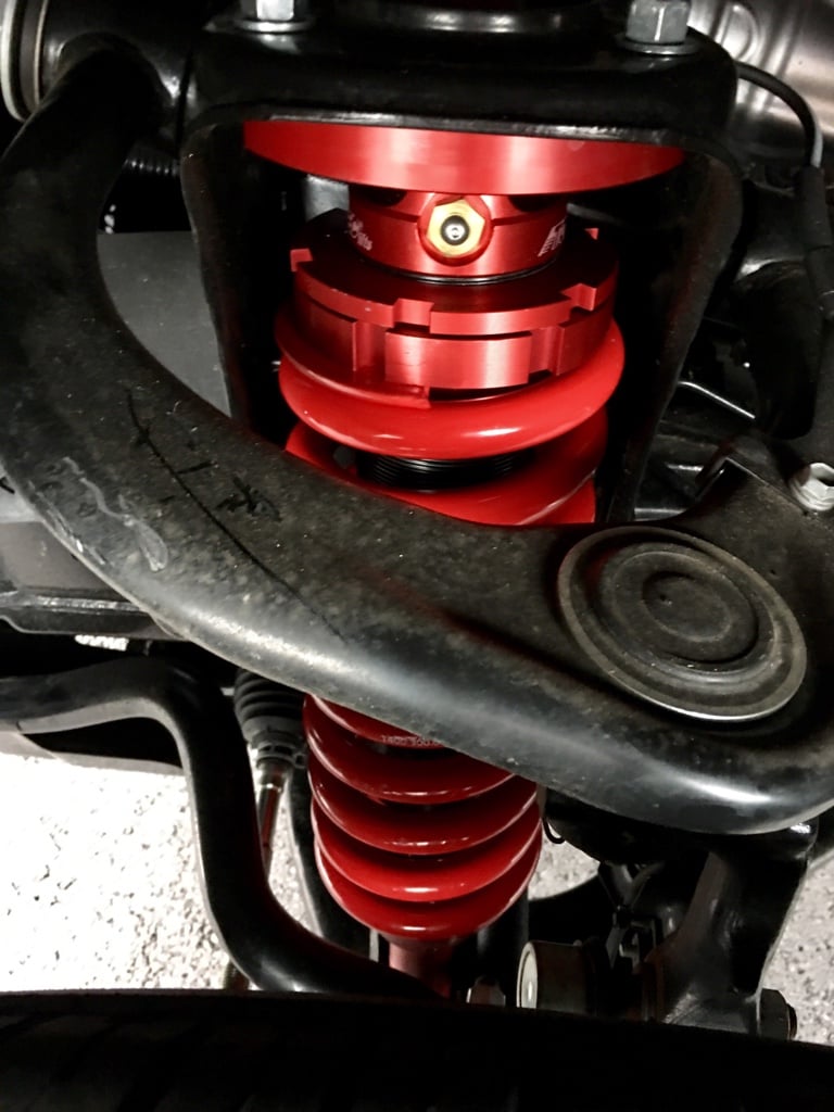

Had the lift installed today. Added 1.25" in the front(set at 2.5" from factory, but adjustable) and 2" in the back(non-adjustable)
Looks a little wierd with the stock wheels, and I think two kids in a lifted Tacoma were laughing at me when they drove by. :)
Getting the wheels and tires installed tomorrow, and probably an alignment Monday at an alignment shop that does alot of offroad alignments.

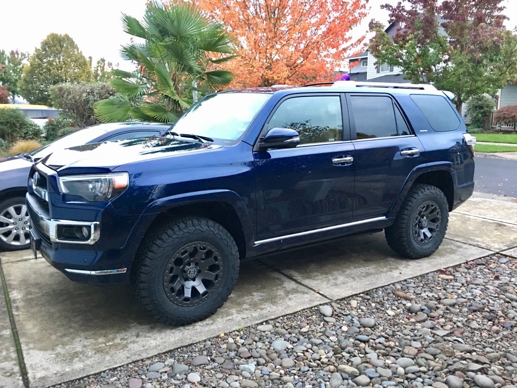

Ok had the tires and wheels installed today. Will get more info and pics but is it normal for a new lift to have weird squeaks? Didn't notice them until I put bugger tires on and now it sounds like the suspension is creaking. I'm hoping it just needs to settle.

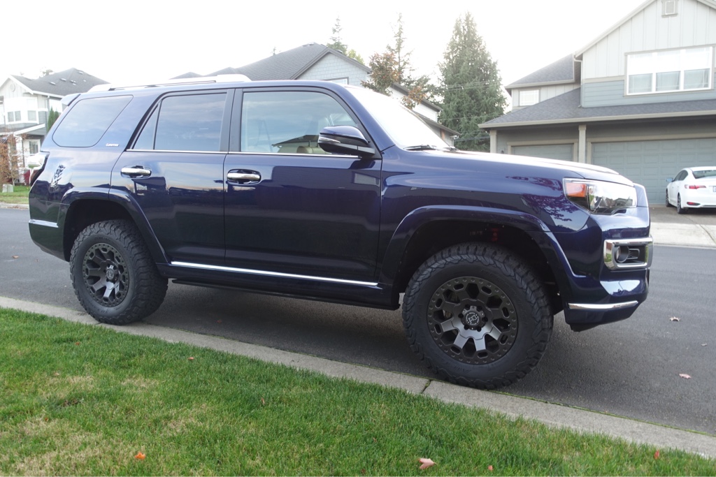

Will get better pics but here is what it looks like tonight

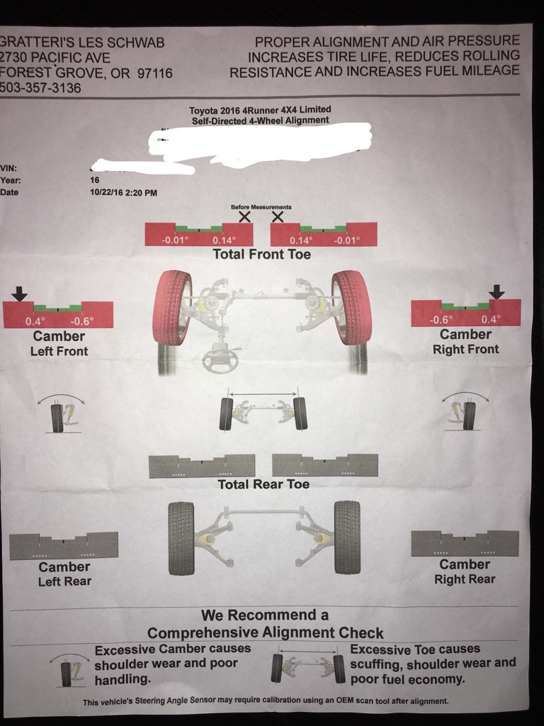

Les Schwab did an alignment check today also. Pic below. Was told to use a real alignment shop instead of les schwab. Also heard to get a lifetime alignment at Firestone. Will be looking at both Monday
Still getting a bit of rubbing in reverse with full lock to left. So adjusted lift up about another half inch on both front sides. 38" from ground to fender above wheel on left and 38.25" on right.
Going to get an alignment on Monday. Getting the lifetime alignment at Firestone. Esp. Since it is $20 off right now.

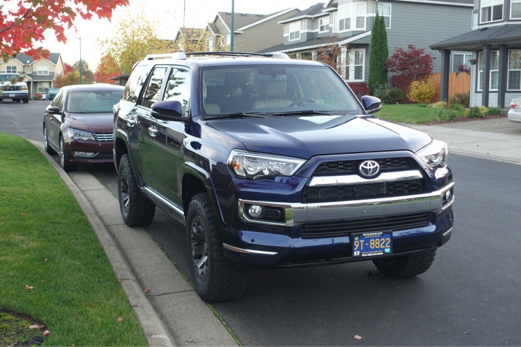

This is what it looks like now.
First alignment and first MPG after lift
Finally had an alignment done today at Firestone(Lifetime alignment was $30 off, or 169.99 Not sure how long the sale is)
Took them about an hour, and seemed to get everything in spec. Drives nice and steering wheel is straight. Will find out Friday when I drive 350 miles and after 4wheeling a bit in North Central Washington.
Here is the alignment spec sheet, before and after: (can just click No Thanks and it will let you view without signing up)
Also today was my first fillup on the new lift and tires. 15.6 mpg this tank, but not sure how much of that was needing alignment, driving, or lift and tires. Will know more over the next few weeks.
