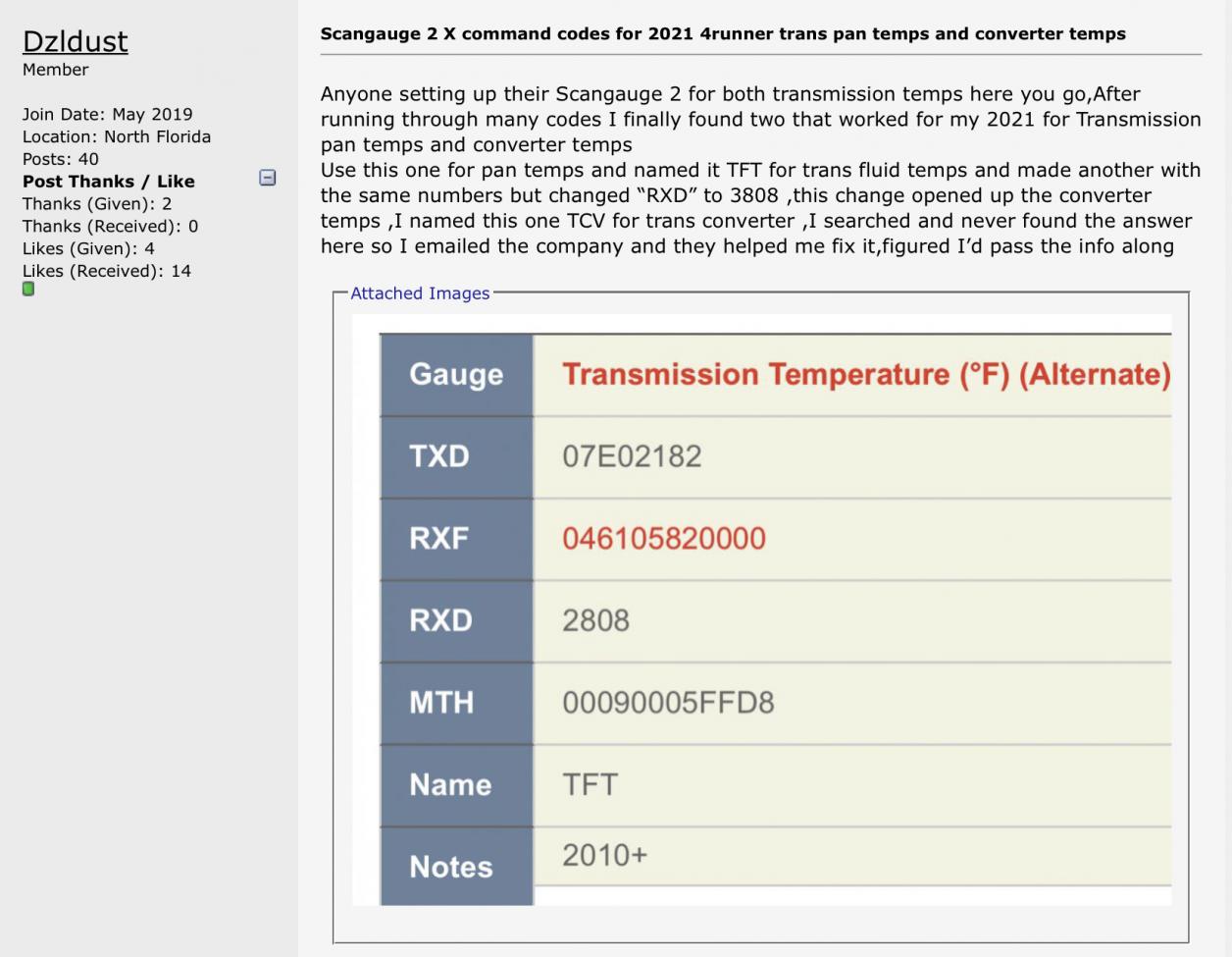

Just got my scan gauge in the mail. Tried all 4 input codes for my 2016 4runner and couldn't get my tranny temp to display. I called in and they provided a working code. Nice friendly customer service!

I made a thread about the codes that worked for me ,here is a screen shot
Yup. [MENTION=375097]Dzldust[/MENTION] got ‘em.
ScanGauge Codes
Transmission Temperature (Pan) - 07E02182 046105820000 2808 00090005FFD8 TFT
Transmission Temperature (Torque Convertor) - 07E02182 046105820000 3808 00090005FFD8 TCT

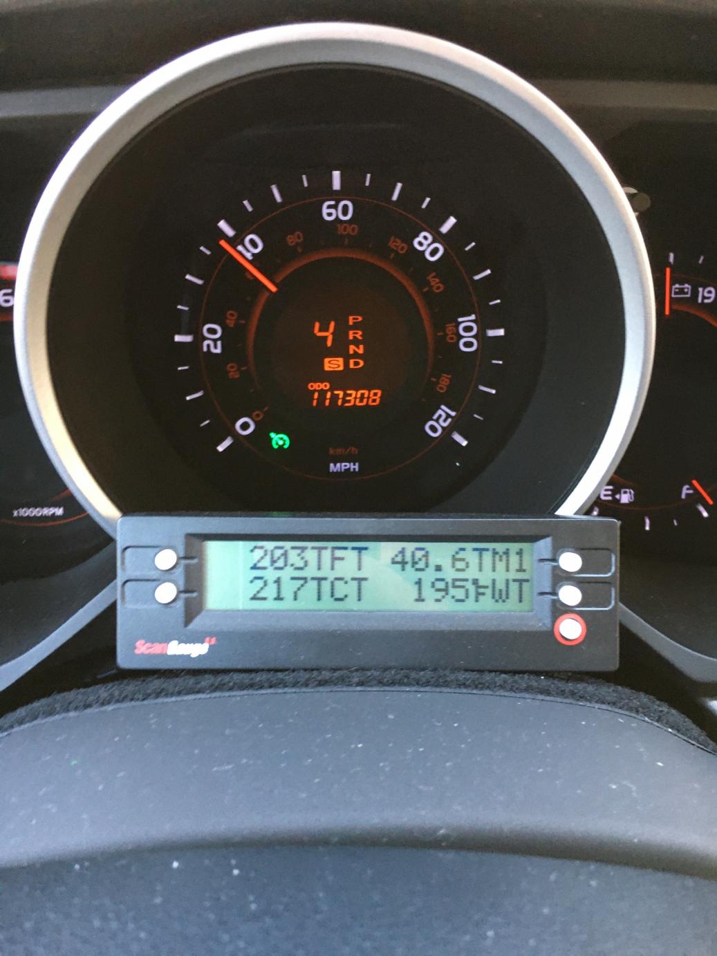

Managed to heat up my transmission pretty well yesterday. 95° temps and a long winding uphill, known as Kern River Canyon Road.
