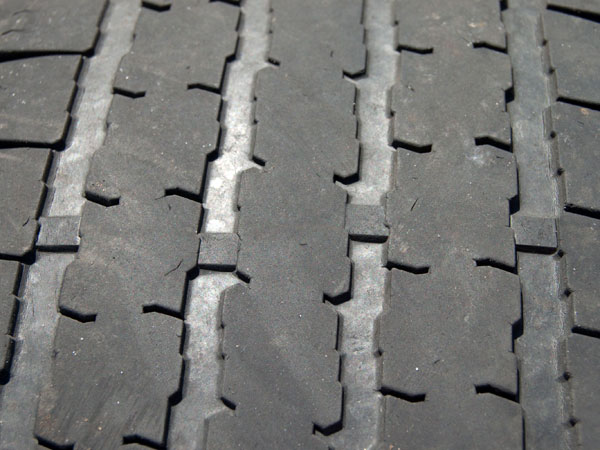

For what it's worth, are you wanting an AT tire for looks, or functionality? Most "service roads" can easily be handled by decent all-season or M+S tires. With the 4runner's excellent A-Trac system, the OEM tires will usually handle what most people would consider "light wheeling". This would include the occasional wash-out, deep rut, and hard-bottom creek crossing found on some "service roads". But your definition may be different, and AT tires may be fully justified. Nothing you've said indicates you need MT tires.
As for your current tires, look for the tread wear indicators. Usually small triangles embossed on the sidewall near the tread aligned with small humps about 2/32" tall. When the tread gets down to about 2/32" the top of the tread will be level with the top of the humps forming a continuous line across the tire. This is the absolute bare minimum for reasonably safe wet-weather driving. With a pregnant wife, living in Chicago, and with winter approaching, I'd personally replace them much sooner. Sell them to a used tire shop for a few bucks if you think there is a little tread left.

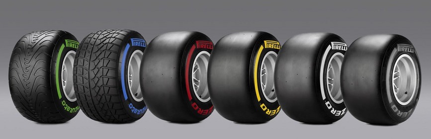

To add to my previous comment, I have some visuals:
Below we have range of F1 tires. From left to right:
Intermediates, Wet, Hard, Medium, Soft, and super soft.
The intermediates and the wets have channels and sipes to allow water to move through and evacuate the tire. Pay close attention to the Wet.
Here's a close up.
Now look at the AT3. Notice something. Channels and sipes
And here is the KO2... Notice the lack of channels?
Every KO and KO2 that I see, this thread included, that goes through mud or snow seems to hold onto the surface it just went through. It doesn't appear to clear or disperse very well. That said, it likely has deeper tread to mitigate this issue.
Hopefully this explains my logic flow.
