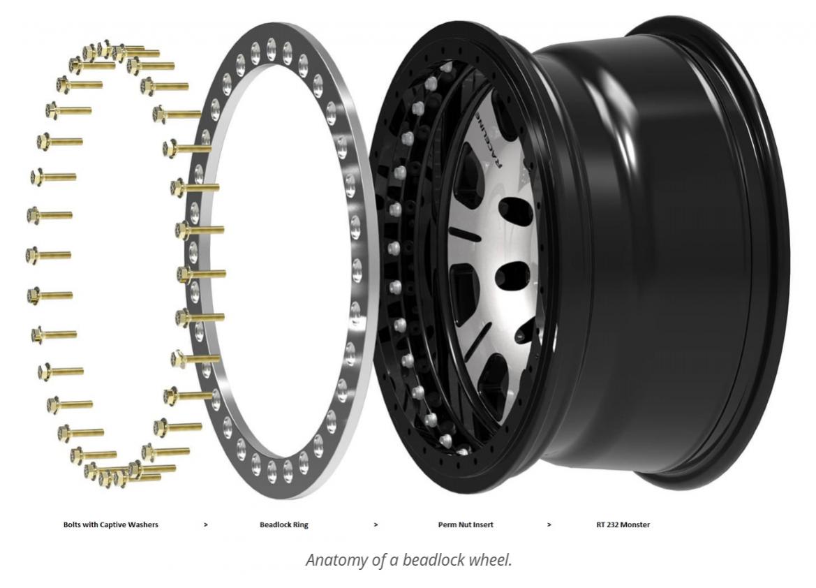

I found this website via quick search ...
What's The Bead Deal? The Importance of Beadlock Wheels - TREAD Magazine

2 no tire shop will mount your tires if you have beadlocks, mostly because of liability and also because it's a major pain in the ass. Lots of bolts that need to be torqued multiple times, 5 hours to mount 4 tires is about the norm I've heard with beadlocks if you know what you're doing.

For what it's worth, I've had true beadlocks (Walker Evans). I can't really say anything bad about them other than just being a PITA to put together. I bought them from an Ultra 4 guy that, at the time of sell, didn't know they were slightly out of round. Ultimately, I sold them cus I couldn't dd with them. Did I need them, probably not. Was just a pipe dream that came true b/c I got a really good deal on them. I don't typically find myself in situations that require such low tire PSI that have me wishing for another set. If you have good brand name, non stiff tires, you can safely run 10-15 psi without ever having an issue and still have optimal tire flex for 99% of the terrain out there.
