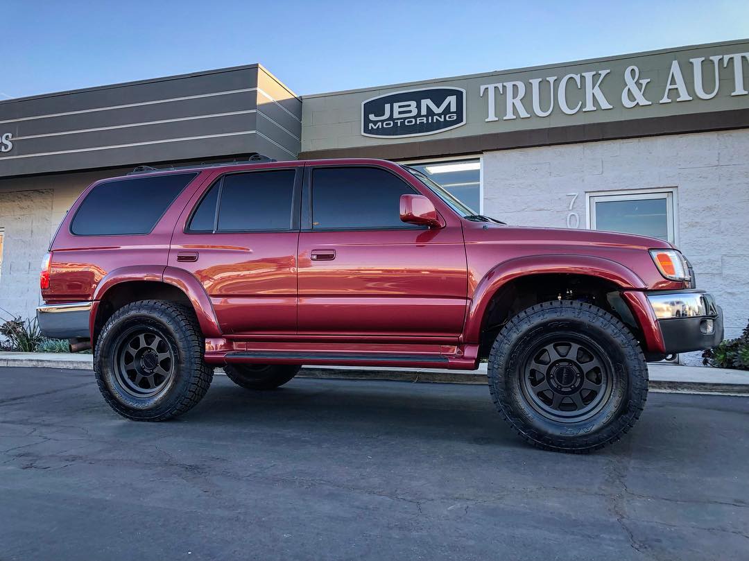

This is the only one I found:
"If I want to go with 285/75 R16 16x8 0 offset backspace 4.5"
This is what I ran on 96Red with 2.75" lift Cooper STT's, no issues with UCA.
Occasionally if turned just right and stuffed just right tire would scub rear plastic inner fender. If steering on lock turned and stuffed just right would scuff frame a bit, worked the same with fender opening nothing more than a scuff.
Believe extended bumps would have solved the issue. 0 offset 4.5" BS is a sweet spot.
Did not have running boards on, did have to remove front LtD bumper cladding and trim valance.
