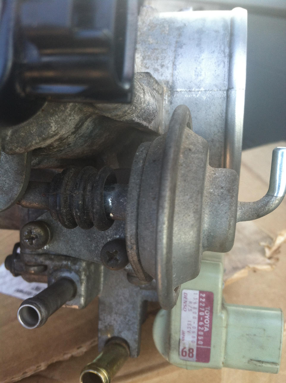

Belay my last, so going through shop manual said to check egr, said if you hook up vacuum pump should idle rough or stall, so I was going to use intake manifold to test this theory, when I disconnect the small hose from the side of the component mounted under the throttle position sensor, idle rpm when up but sounded great, smooth with no miss, before at running temp I could go 1/2 mile and throw P0302, after disconnecting that small tube I drove for at least 20 miles no probs and had good reaction (hardly any lag) good acceleration and no misses on any cylinder. So question what is that thing, what does it do and is that small tube supposed to have a hard vacuum to it? Say about 18-20inHg
Ok so little confusing on last couple posts, sorry was 2 am or so, yes I do not have an egr valve after closer look in book it was describing checking egr on 4cyl engine. Will post pic when I get home, site will not let me upload from my phone. I went to advance auto (for what that's worth) and they couldn't tell me what the questionable part is either. But like I said is mounted to throttle body on backside nearest windshield, mounted by two Phillips head screws directly under throttle position sensor, a small vacuum hose connects to barb on part then runs over to driver side on backside of plenum to another barb. Idles kinda poor when warm, but disconnect and idle rpm increases but can tell a def difference in operation of engine, doesn't sound like its choking. Pics to come later
Nope thats mounted under throttle body with two coolant hoses and another hose on bottom, this hose is pushed on from top down prob 1/8-1/4" hose, good thing is I think I eliminated all the fuel injection system and lies in the vacuum system somewhere, I mean I have a good vacuum just don't know if its in any of the vacuum valves or sensors, that's where I'll be looking today
Ok this is the part in question anyone know what it is?
That's the throttle-opener thingy only found on 5-speed V6's. If you leave that hose off, it will idle way high (~1300RPM) as it holds the throttle plate slightly open when vacuum is removed. Why 5-speeds need it, I have no idea.

2. Somebody swapped in a new TB from a 5-speed.
My info wasn't hard, just another poster, so if I was wrong I do apologize. Anyway, that's what it does. That I'm sure of, because I have one.
Here is the thread that led me to think that. That diaphragm thingy is what connects to the vacuum pipe in the thread. So I guess we just don't know what models use that thing and which do not.
http://www.toyota-4runner.org/3rd-gen-t4rs/163386-know-where-goes.html
Anybody want to clear this up for us?
