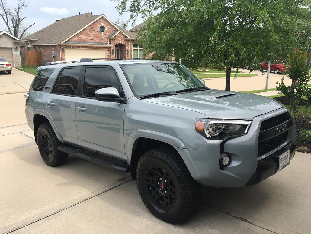

Put a deposit on a TRDP back in December last year after hearing that VW would buy back my diesel wagon. VW bought the car back last month on the 20th, while I was out of the country for work. My dealer could still not confirm a date when my TRDP was going to arrive, so I was getting a little anxious about not having a vehicle. After putting a little pressure on the dealer they sourced one from Gulf States Toyota which i picked up last Saturday 4/1, a day after I got back from my trip. (lucky) Of course not everything can be perfect and the truck had a bunch of options that I did not want such as OEM steps, remote start, glass break sensor. Anyways this thread will be of my build as I go. I'll start with a picture the day I picked it up.

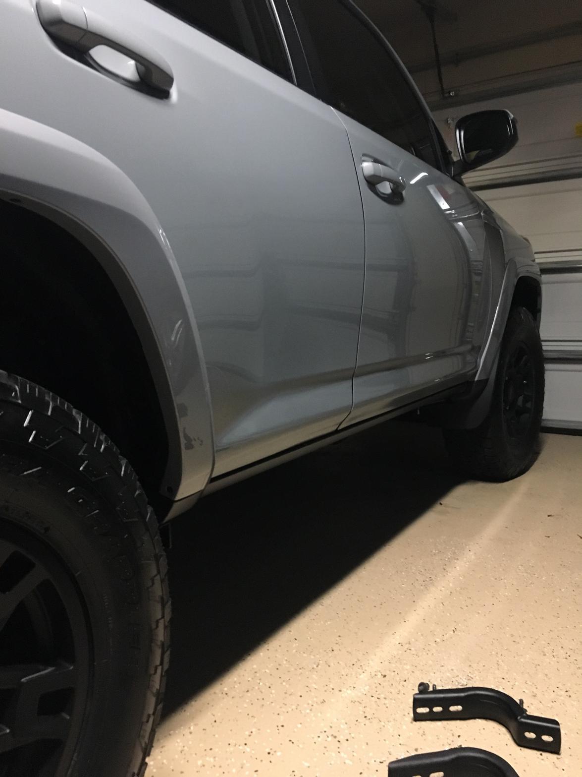

1st "mod" was to take off the OEM steps as I'm on the C4 sliders group buy.

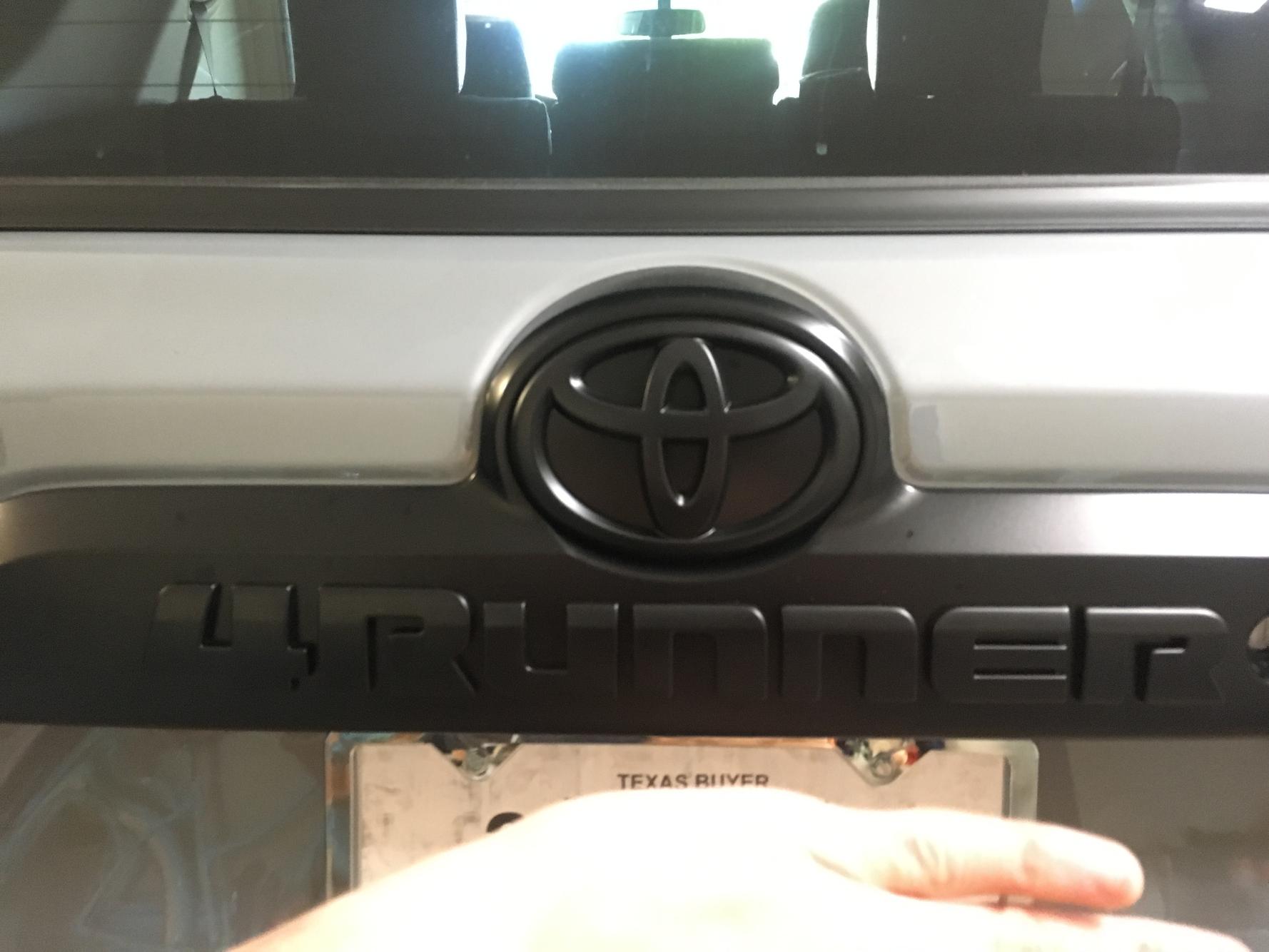

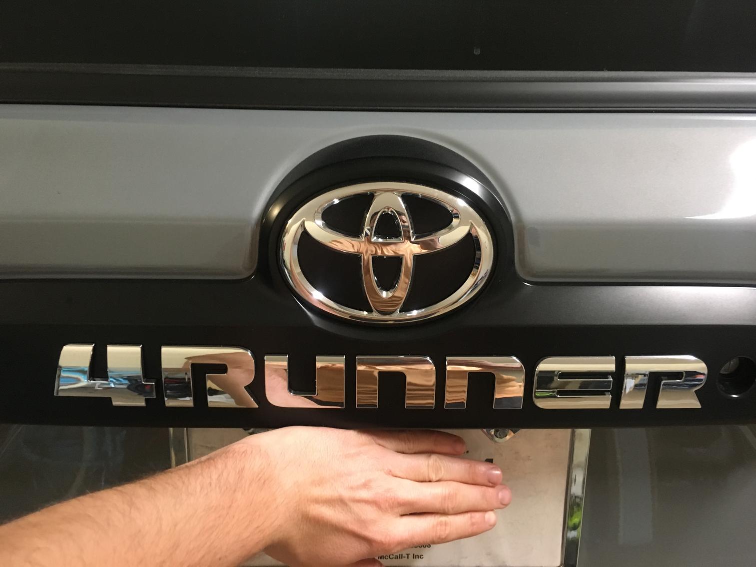

I ordered some overlays for the 4runner in the back. Looks much better IMO.

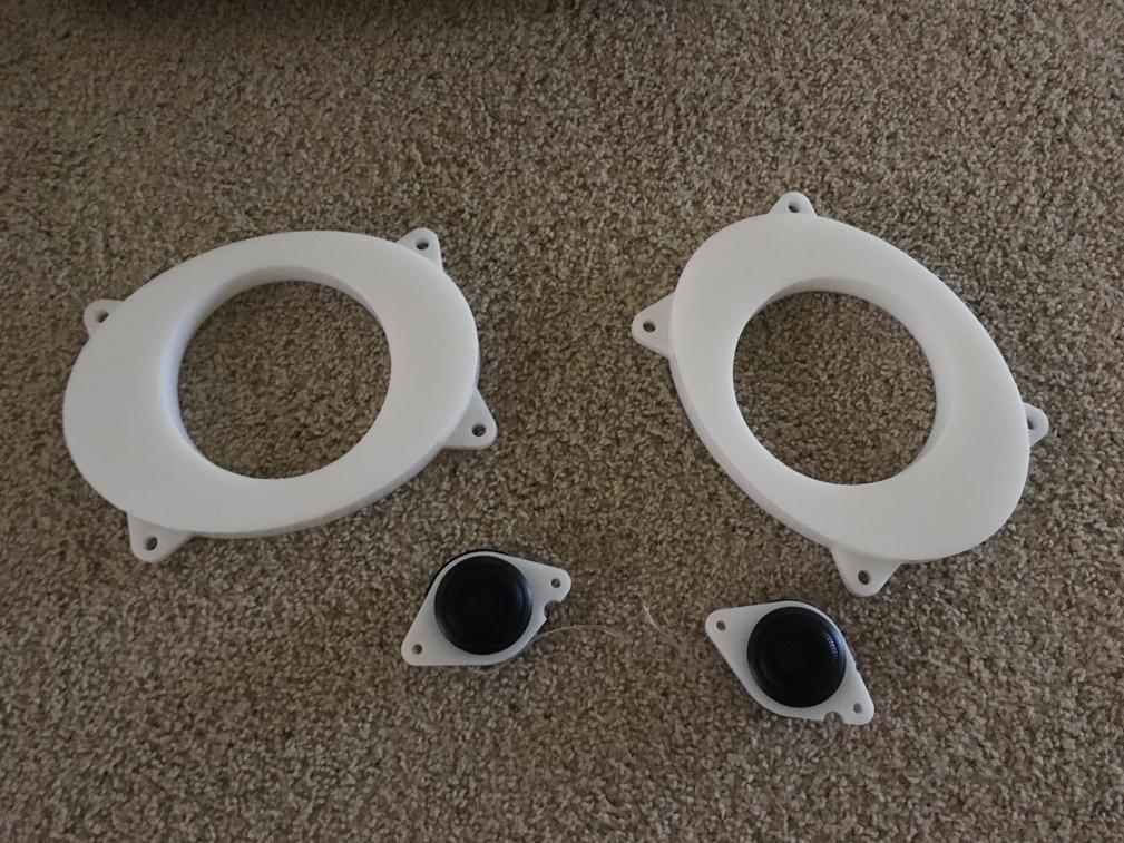

Tweeter/Speaker mounts from Taco Tunes

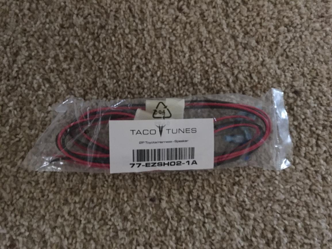

Wire Harness from Taco Tunes so I that I don't have to splice original wiring

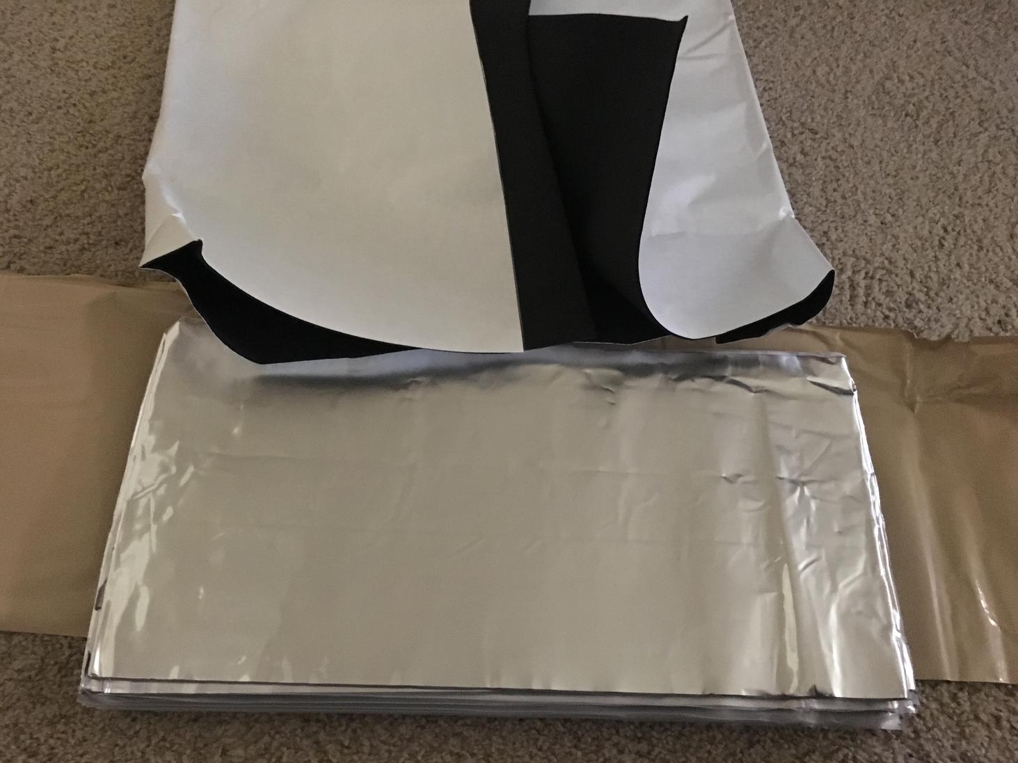

Raam Mat and Ensolite deadening material from RaamAudio

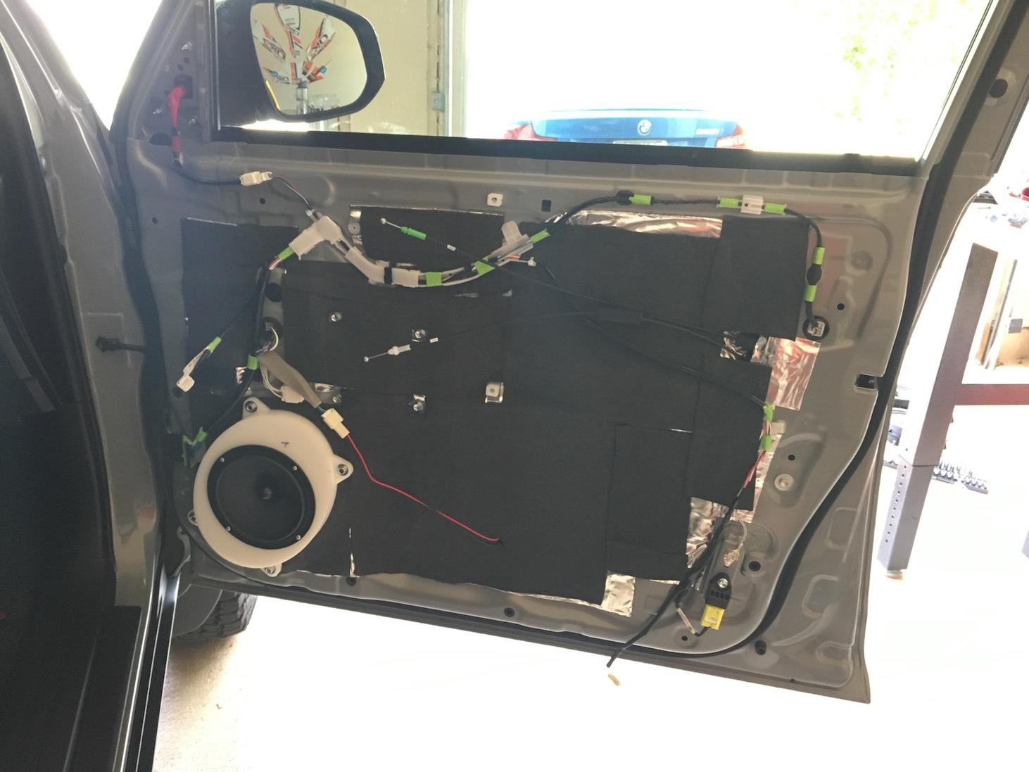

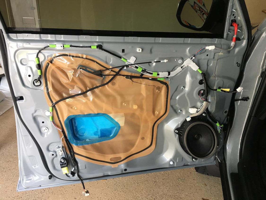

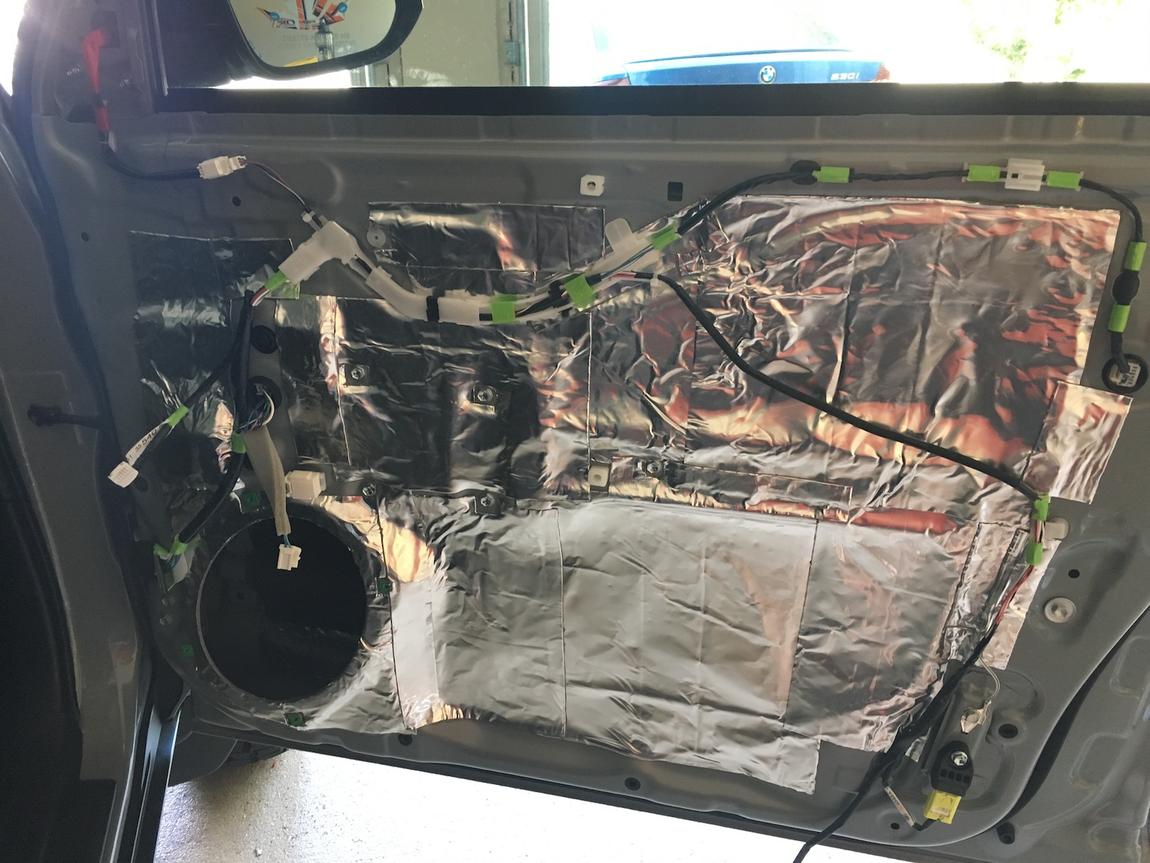

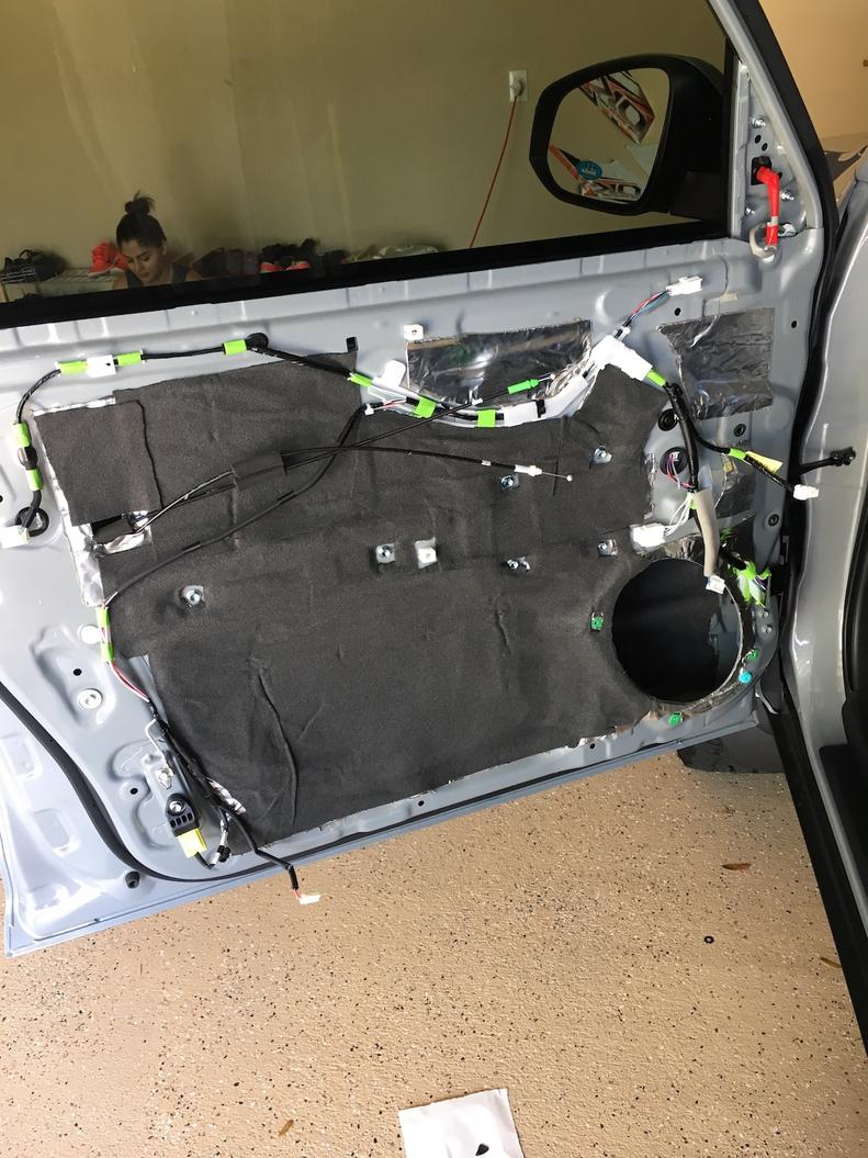

did the deadner and speakers at the weekend. sounds a lot better imo. took a few pics, but not very many. About halfway through the 1st door I asked myself why I didn't pay someone to do this.

thanks, i'm pretty happy with it so far! As far as the audio upgrade its pretty simple and you can do it, I wouldn't want to do it again to be honest, not that fun of a thing to do.
I used these videos to complete the job and it was pretty straight forward.
https://www.youtube.com/playlist?list=PLFuSO7p8sCy10Vk2DvJcxCy7xCidVhEXf
For the matting/deadening I bought this and still have a decent amount left over which I will probably use on the trunk at some point.
Package # 1 -------- 20 Sheets of RAAMmat BXT II (37.5 sq ft) and 3 yards of Ensolite IUO Peel and Stick Foam (41.625 sq ft) - RAAMaudio Inc.
Front speakers I bought this package and added the speaker and tweeter mounts, the speaker harness and the longer bolt kit. Also I found out after I should of ordered the tweeter harness which isn't on this page.
Toyota Tacoma Image Dynamics CXS64 Component Front Door Speaker Installation Kit
Rear speakers I bought this package and added the speaker mounts, harness and longer bolt kit. Didn't need the tweeter stuff as its a coaxial.
Toyota Tacoma Rear Door Image Dynamics CTX65 Coaxial Speaker Installation Kit
I looked around at the pricing for these speakers and found that the prices there were competitive enough to not warrant ordering from different places.
If you have any questions you can PM or ask here.
