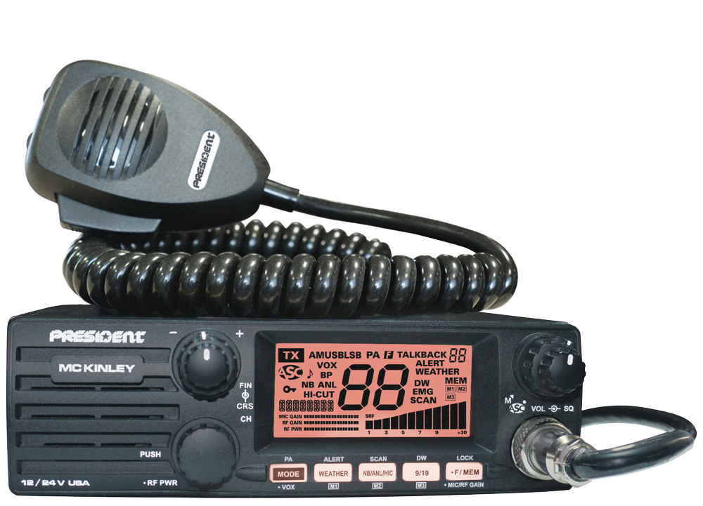

New update. My custom modified CB radio started to turn itself off and on intermittently. If you co back and look this was a BearCat880 with the case chopped down and the top 1/8" of the front bezel milled off and Orange Lighting Film over the internal LED's installed into the dash with a single din head unit.
Needless to say, I was not happy if this thing was going to crap out seeing how much work it took to get it in the first time.
Well I did a little shopping and found something awesome!
President CB Radio has a true single din model know. It is the McKinley.
Correct screen color, true single din, front speaker, PA capable, works with my current BearCat wireless mic.
This thing picks up and transmits way better than the 880. It has some patented "automatic squelch control" that is fabulous. I leave it on all the time and only hear the good stuff.
I Love it.
and come to find out when I took out the 880 I found the problem. The inline fuse holder. The plastic kind you slip together and quarter twist to lock. One of the lock tabs had broken off.
