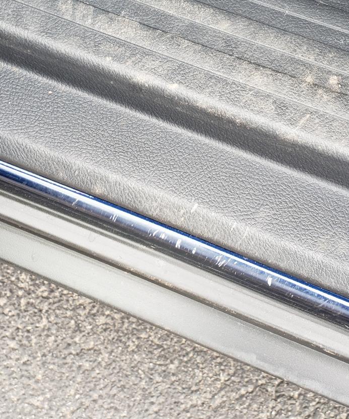

Mine is new, a 2023 with 5,500 miles currently. I didn't want to be stretching the side edges of the seat excessively while exiting the vehicle, so I put my foot on the door sill bottom to take the load off the seat as I exit. Unfortunately this is now wearing the paint there. I suppose I need to get nerf bars or rock sliders or something to be able to step on.

Here is where my door sill is scraped:
I see what you mean. I guess I am tall enough that I don't need to put my feet there. Also, I have running boards where I can put a foot if needed. (If you get running boards, be sure to get the ones with a rubber top, not plastic. The plastic ones can be very slippery when they get wet.)

I have put some 3M protective clear vinyl tape film (after touching up). Just this past winter, I noticed that there was some rust coming at the door sills trim where sand, etc. gets underneath and rubs over time. It wasn't too bad, but wanted to nip it in the bud now.
Spent a good part of the day removing trims, little bit of rust, touch up painting and once paint was dry, put the protective film enough to cover past the door sill trim and past the painted edge to protect the paint. Kinda wish I knew about this and would have put the protective film earlier on and then not have paint to touch up. Ah well, live an learn.

the tape is a great idea. actual PPF will be a pain to try and adhere properly when you've made touch up spots - it needs a smooth surface to adhere to
thinking something like this

I wonder how well it would stick though. especially around that curved part of the sill

I'm sure you could have it professionally done, but for how much I look down there and after touching up myself, I have to really be looking to notice. I guess it comes down to personal preference and skill and what I personally find acceptable to live with.
I don't like the toyota pen, but have used this Duplicolor touch up kit as there is a brush, clear coat and pen, but you can use a toothpick and let the paint fill into damaged space. There are lots of youtube videos out there and typically prep is key, but its not super complicated.
I picked it up from my local auto parts store; this is the product: Scratch Fix All-in-1™ Exact-Match Automotive Touch-Up Paint – Duplicolor
