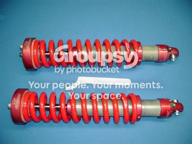

Got a little ahead of my schedule I planned, which is fine by me. I just placed an order for a set of TheRetrofitSource H1's Mini's, 5000k H1 bulbs and H4 Bi-xenon harness. I also have a set of ballasts coming my way. The grand total will be $140 for all the parts. I'm super excited as it's one of the mods I've been wanting to do for a while and will be very useful now that winter is coming. I plan on blacking out the bowls and probably using vinyl on the corners like Rickashay. I'll start at the end of October since my Fiance will be gone for the day and I won't get any nasty looks or yapping in my ear for using the oven. :hiding:
My other big update just happened today. I ended up picking up a set of SAW 2.0's. I wasn't planning on upgrading my suspension for a while, but for the price I couldn't pass them up. They are the older style, but everything I have read says they are the same as the new ones. They have been rebuilt with new oil, seals and bushings, as well as new Eibach 600lb coils.
These are a general picture of the SAW's. The guy deleted the for sale thread after I bought mine, but they are identical with silver Eibach coils.
saw-fs1.jpg~original
Some people might be wondering why I'm getting rid of my Tundra/5100 lift. I like the lift a lot, but it was a cheap lift for the time. The ride is great on road and feels very planted, but it's lacking the adjustability I was looking for. Right now I'm set at the 2 notch and it's not harsh at all, but it's a little too low. I could go to the 3rd notch, but that means the ride will get a little more harsh and it's more lift than I'm looking for. I think the SAW's will be perfect since I can level both sides out and reduce the rake. Plus the 600lb coils will ride a little softer, which is perfect for my DD.
Sup SCRunner - Were you running TRD Tundra springs with a Taco/4R 5100? Any plans to open up the SAWs and start tuning the valving at all? How are the SAWs doing? How many miles have you put on since the rebuild? Any issues with the seals leaking or corrosion on the rod?
I have to admit, for what I've spent on my parts-bin front lift, I was really tempted to just go with a SAW front. For what i spend in beer in a week, I could have just bought a new kit. Guess I was just worried about reliability and feared the need for unexpected rebuilds.
Great looking build, by the way. Just picked up some LX wheels and am torn between 265/285... I see 285s on your wish list. You still dreaming of going bigger, or are you still stuck on a regear? I was considering a supercharged 4R when I was shopping for used vehicles, but the premium gas turned me off. If you insist on one of the two, I'd pick the regear.
I was running them with the Tundra 5100's on the second setting. I don't really have any plans at the moment, but I want to get them checked for the nitrogen level. The PO of the SAW's rebuilt them and said they had 7k on the rebuild. I've put about 2k and see no leaks or issues besides the top bushings going bad. Overall I'm happy with them, but may be swapping them out in the future if things go my way...
I know what you mean. I'm actually only $400 into my front all together between the two different set ups. That's factoring in the resale of my Tundra/5100's. If I could have gone new I would have, but I'm working on a very limited budget and typically use money I profited from selling parts to fund my mods. You shouldn't have any issues with unexpected rebuilds on new coilovers. If you do it would be on the manufacturers or company you bought it from.
Thanks! It's been a slow build and nothing extreme, but more tuned towards my day to day needs. As before, budget is huge so bumpers will wait until I can design/build them myself. :D Go for 285's!!! While I'm fine with my decision to get 265's, I now wish I had 285's. I told myself I would get a s/c or gears before 285's as I can't stand the power loss already. Around town it's fine, but hill suck. So that is the reason I'm going with a s/c this winter instead of tires and other things I want. But from what I've heard 265's to 285's isn't that much of a difference so I say go for it. You don't want to be regretting it later and end up spending more money.
