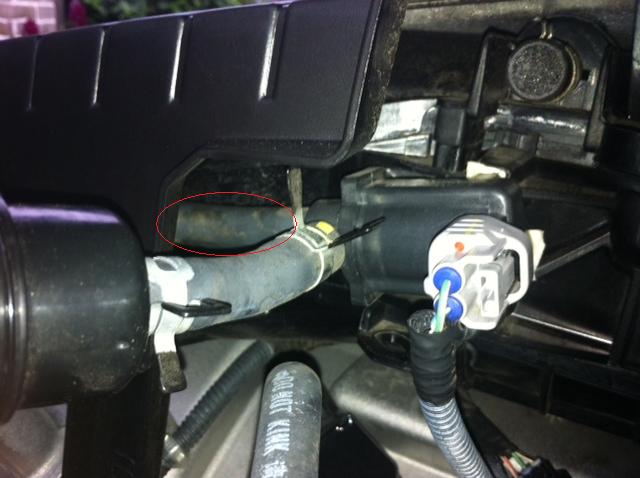

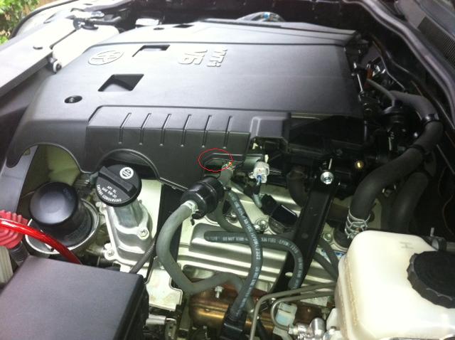

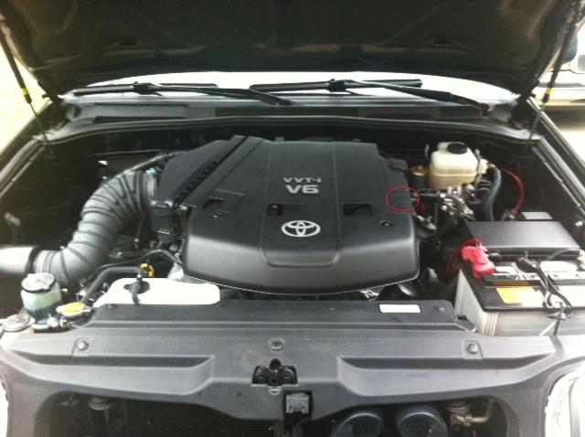

look towards the circled part, by the vsv valve
side view
you want to pull the hose on the front side of the vsv valve as shown
and if your confused, refer to this vacuum diagram
Hope this helps!!
side view
Hope this helps!!
