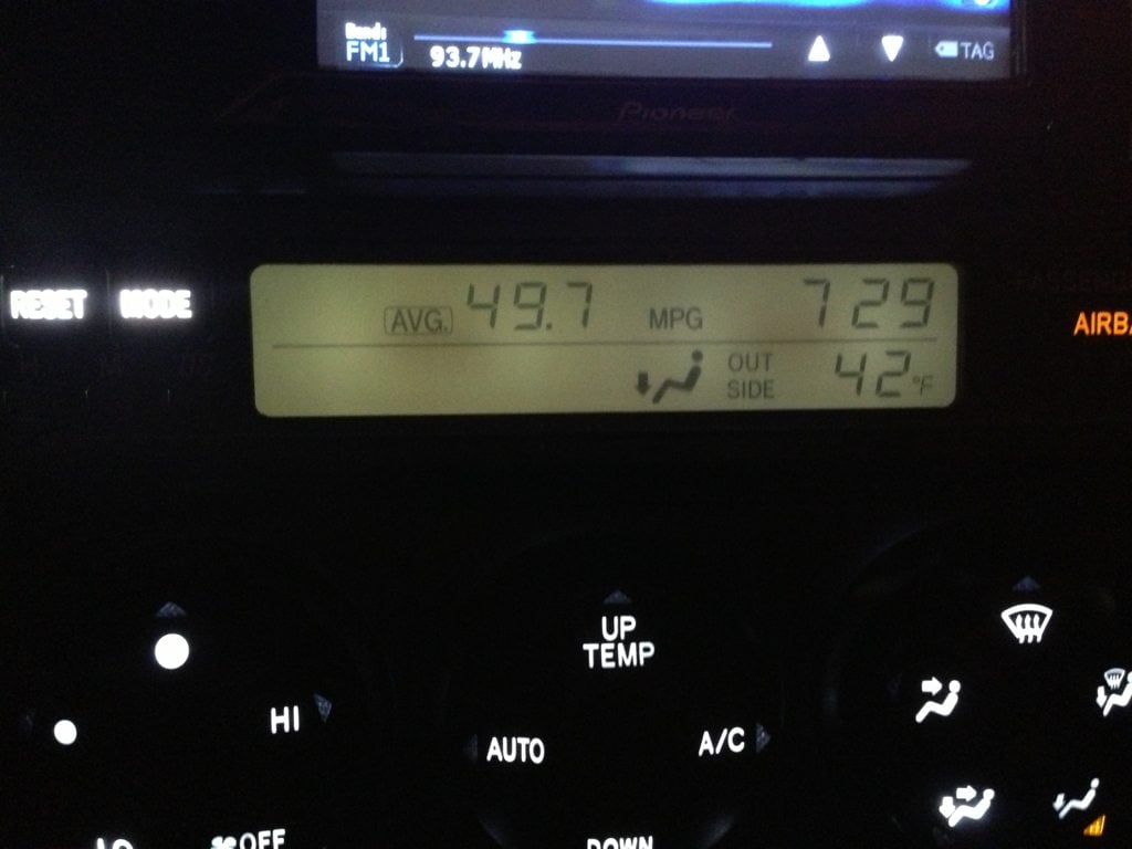

Fake news!
I can't believe the results!
Fake news! Its the Russians!
