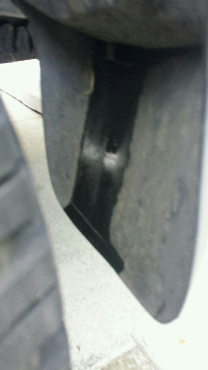

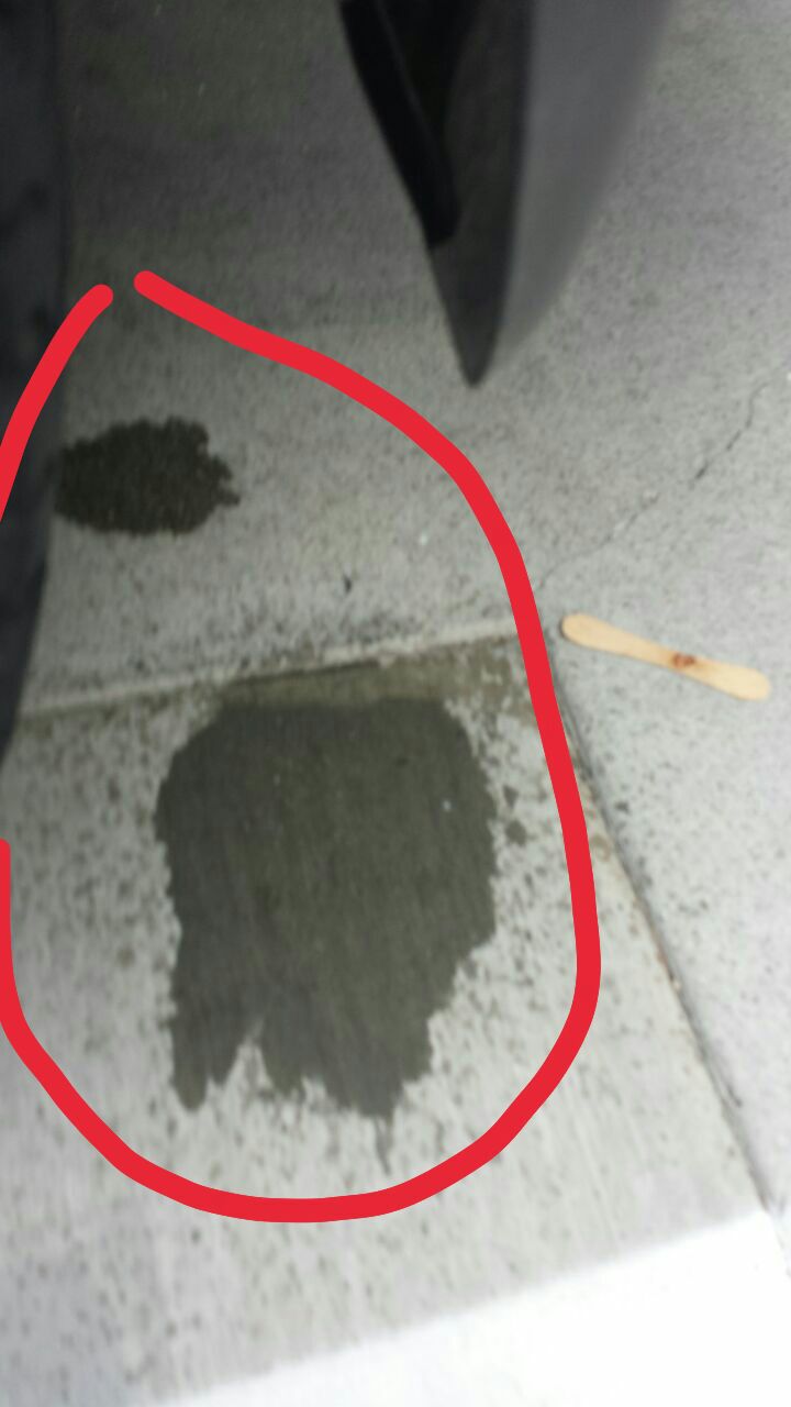

I added an entire can to half a tank and I haven't noticed any results whatsoever. I expected some smoking or something but nothing. I did notice that I may have a slight gas line leak but not sure exactly

You only see smoking when you add Seafoam in the vacuum line and see much better results. Did you use a funnel? Maybe some of it didn't go straight down the gas tube. If you have never noticed this upon fill ups I wouldn't worry much about it.

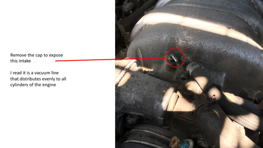

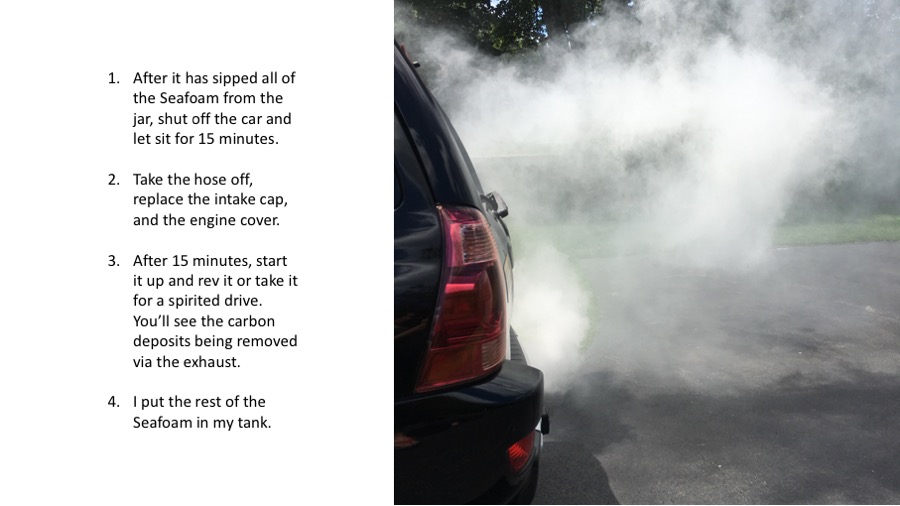

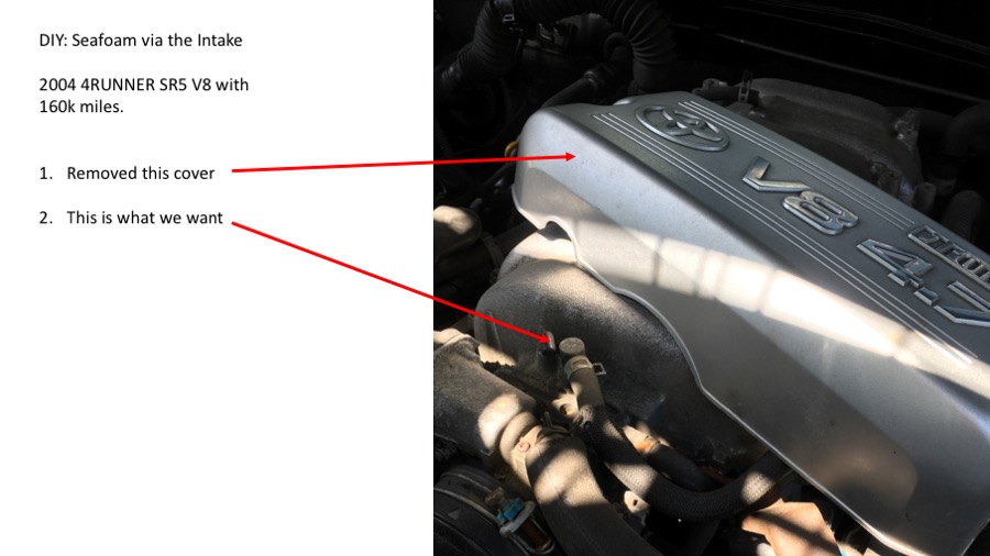

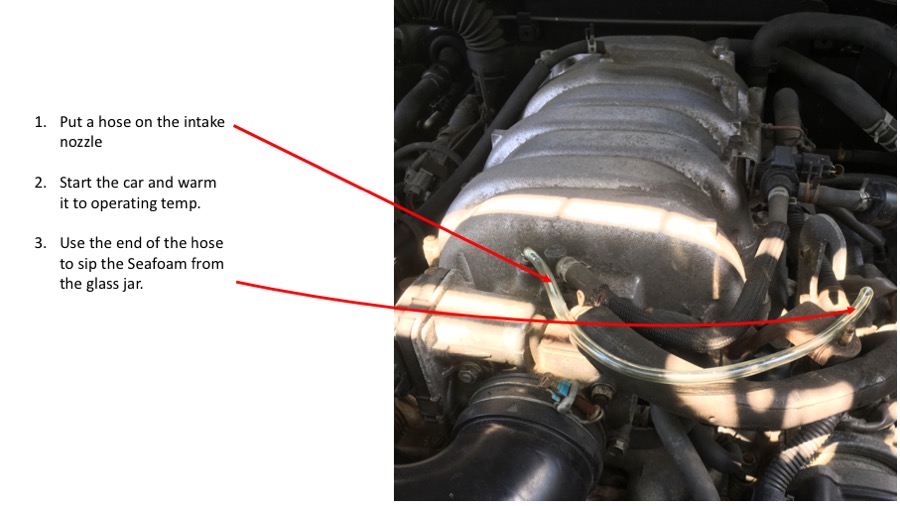

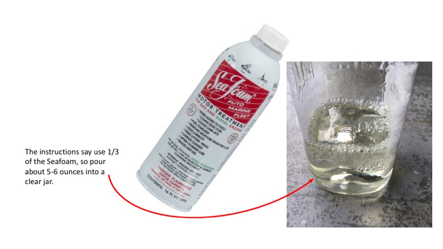

These pictures were EXACTLY what I needed to get this done on my V8. I've got about another 500 miles or so before my oil change. I'll probably wait until its time, seafoam it, then oil change. Just wanted to say thanks for the accurate photo documentary.
To anyone looking for hard evidence, this is one of those things where it's so cheap and you hear some guys talking about it, why not give it a try? Just my $0.02 on the matter.
I didn't get anything after the procedure, tons of smoke and all but that's it. Milage is the same if not worse.
