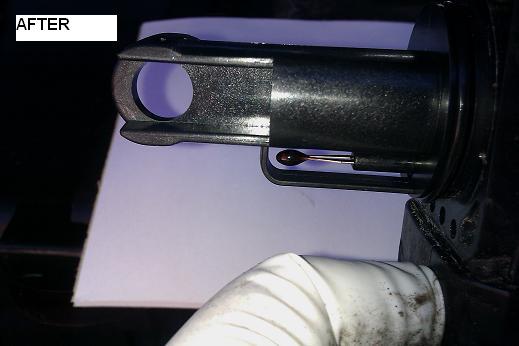

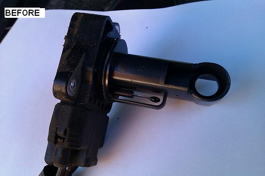

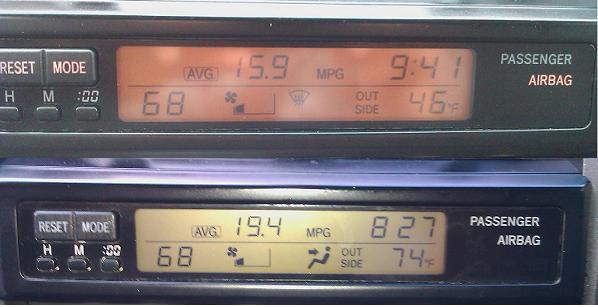

I seafomed my T4R this weekend. Only did the vaccum line and gas tank. Did not do oil yet, since I only have above 700 miles on this oil. I also went ahead and clean the MAF. Below are before and after pics of MAF and MPG (computer calculated). Thanks everyone for pics and ton of info :thanks:

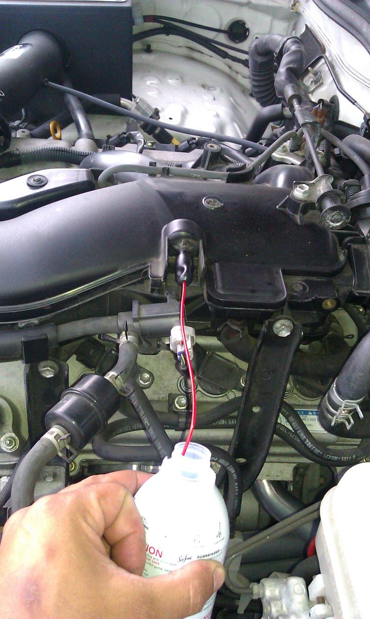

kylebacc,
Stop looking at the intake and look at the pcv valve on the driver's side valve cover.
Pull this hose off the pcv and pour seafoam into it so it sucks it into the intake.

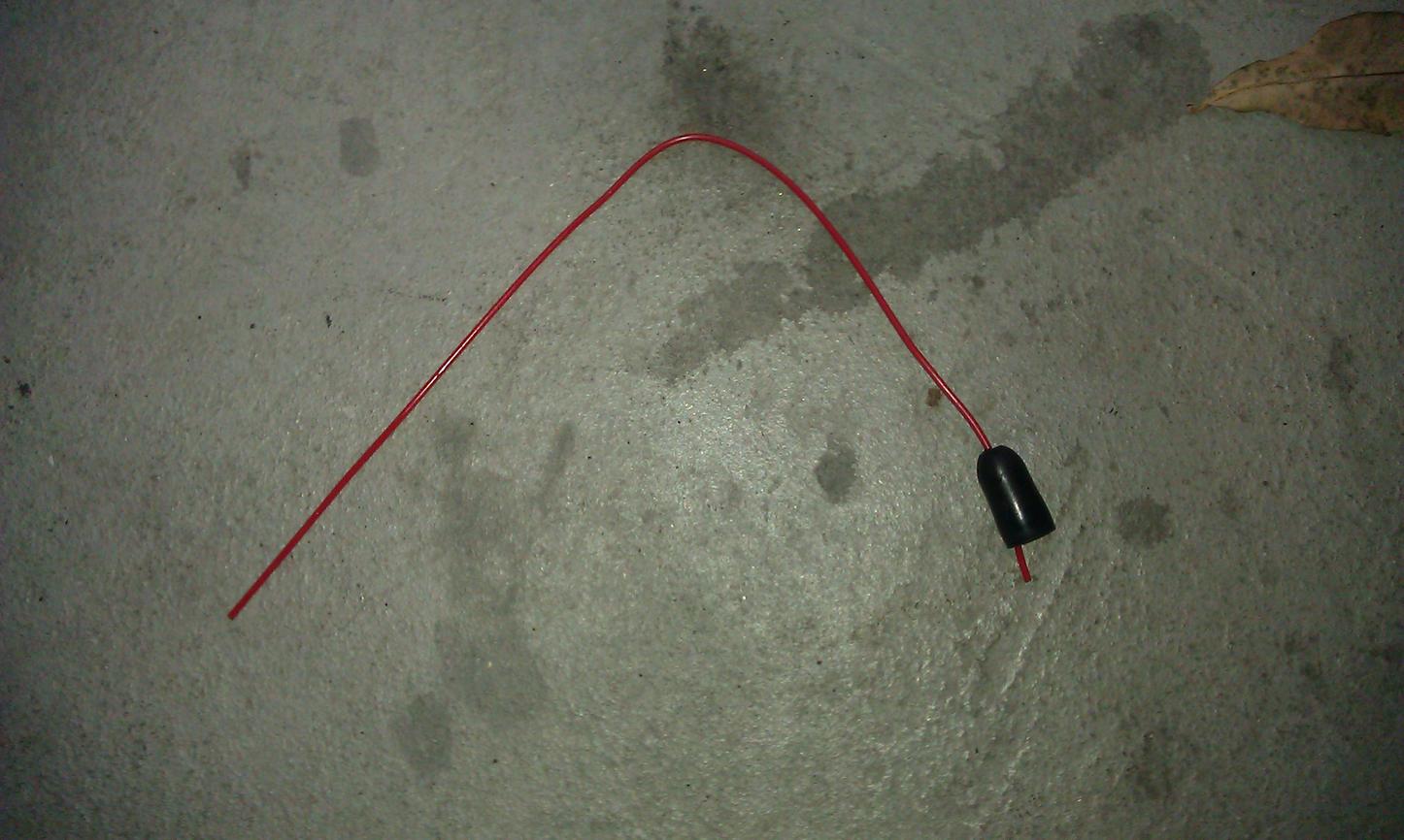

Just did this today finally....found a different port as well. I made a lil straw plug type deal so I wouldn't have to worry about flooding n all.. will post pics tonight..

you want to pull the hose on the front side of the vsv valve as shown
To be clear, because I'll be the guy the pulls the wrong hose and destorys half a city block, its the circled hose. Not the hose that is coming towards you. It the left hose under the cover, correct? And do I feed the hose, or that housing it connects to?
Also based on the what the can says and what I've read here, here's my plan;
1/2 can engine, 6oz oil when I'm 40mi from an oil change, and full can in the tank with the next full bag of gas.
Good to go?
