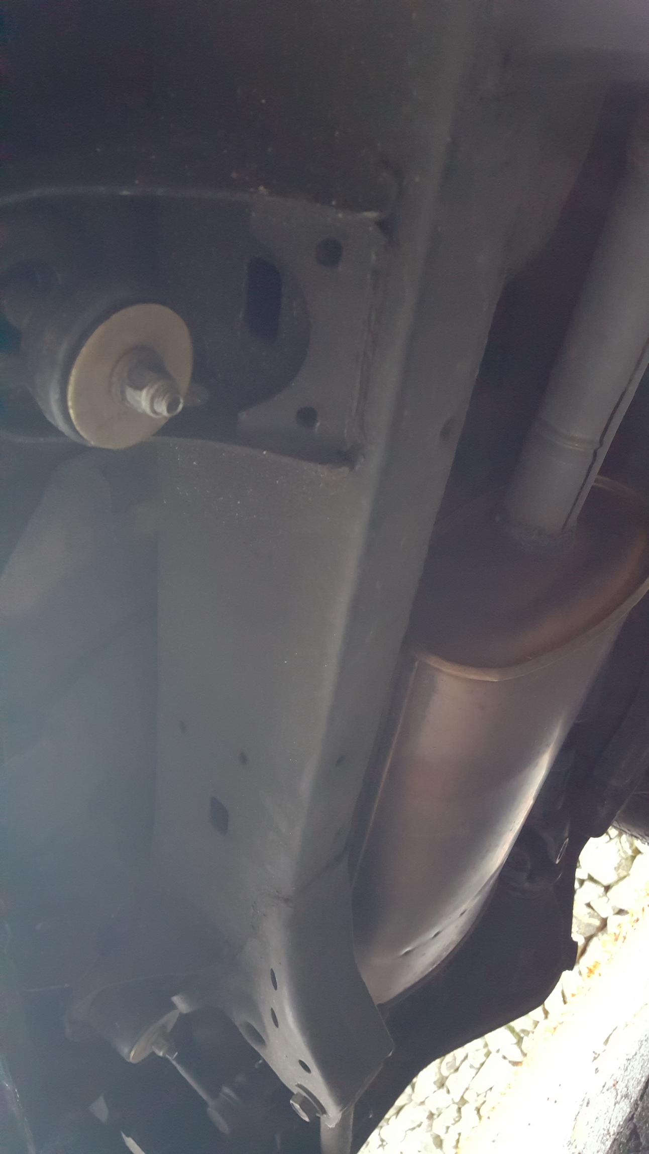

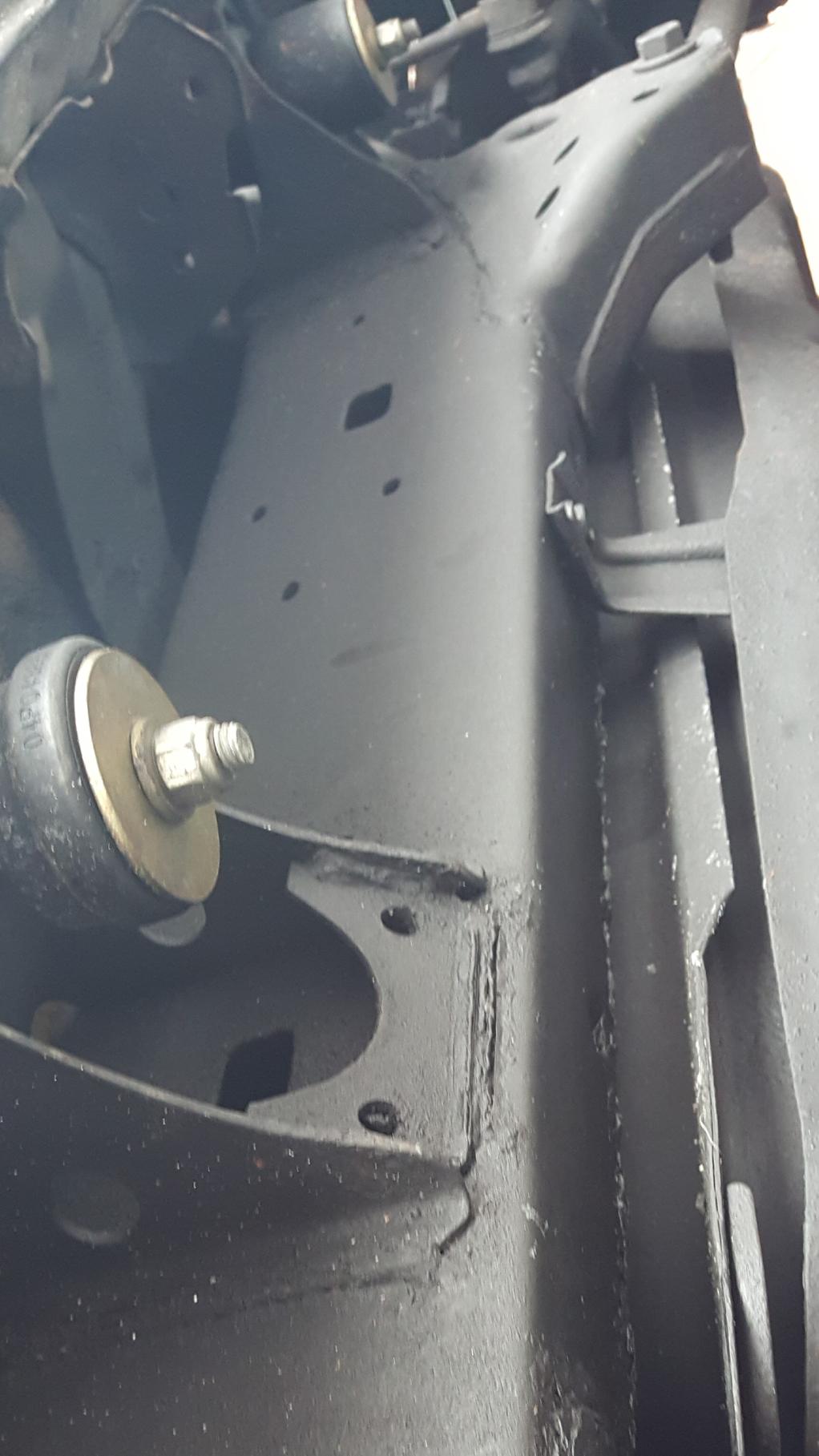

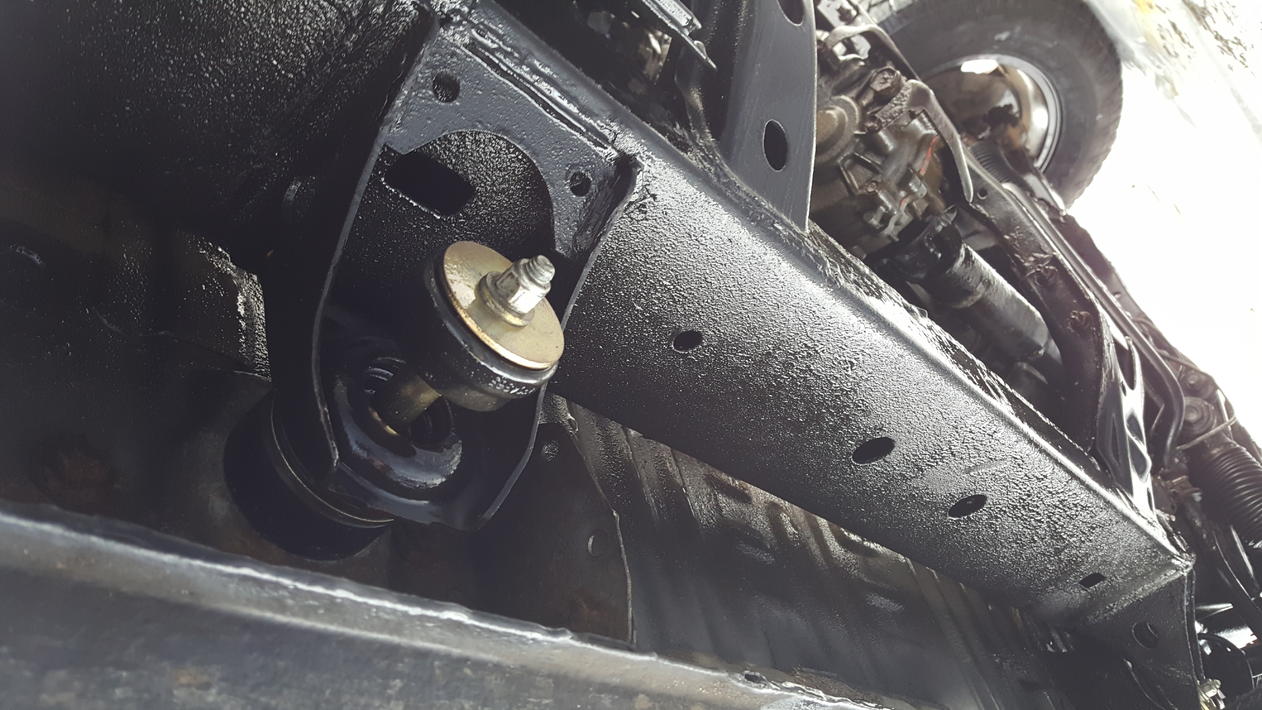

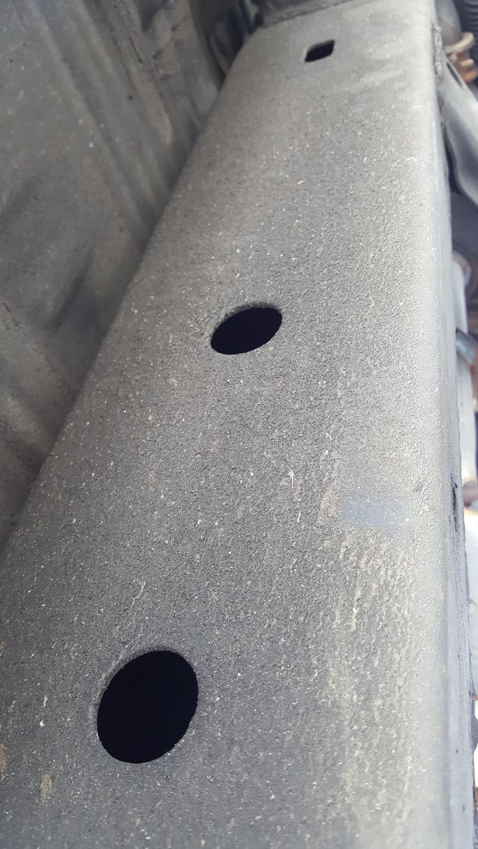

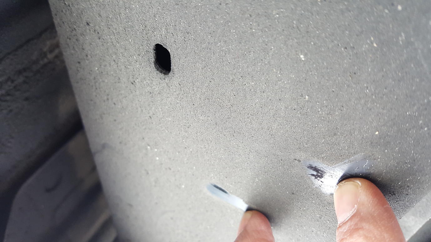

SEE THESE PICS - Notice my fingers rubbing on the frame coating yesterday this November from a coating that lasted all the way from last February, so you can see its stay put effectiveness. See frame grime. The underbelly floor is supposed to be grey, notice the blackish color. Anything I spray with WD-40 turns black over time. The wet black frame pic is right after I coated it.

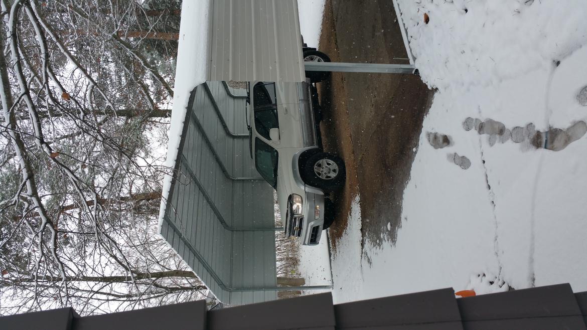

We don't have a garage to fit our vehicles but we just put up a 20'wx20'L Versa Tube car port a month ago and I was happy to have it the first time it poored rain and now the snow is here.

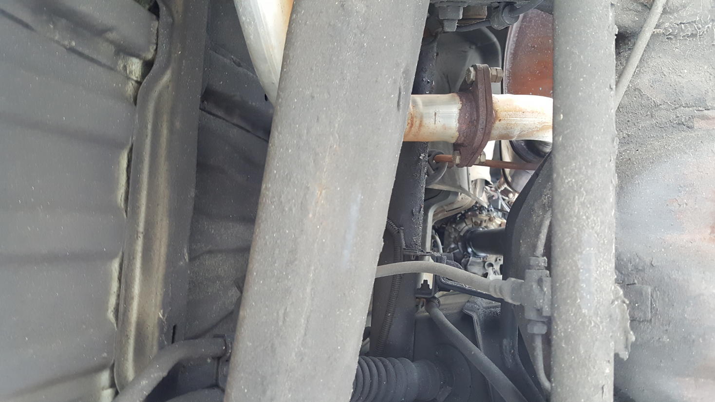

Follow up. Here's a frame pic 2 days after coating with evaporation and set up done. Will pick up some micro dust and dry out more and keep the grime barrier staying this way throughout the year. F'ing hate rust, not happening on my rig.
