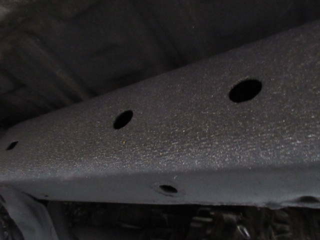

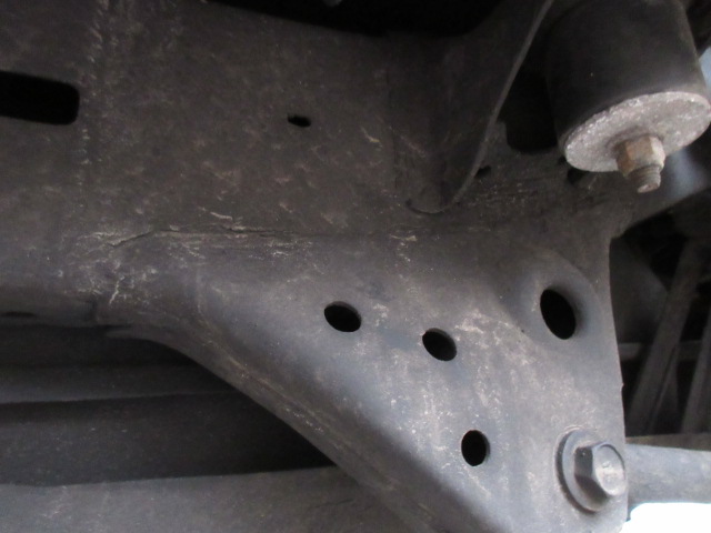

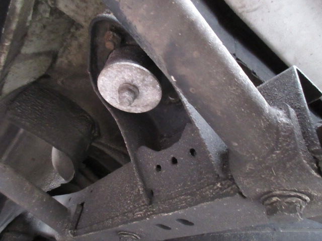

I consider mine pretty clean compared to most on here and its lived in New Jersey its whole life, bought brand new by mother back in 2001. Currently with 223,000 miles on the clock. Just gotta keep up with it that's all! I like fluid film too, but would definitely be interested in WD-40 as well.

Compressor maxed at 160psi, so its like a hurricane inside and outside the frame and everything else. I run the gun without a spray tip, never tried it with one, but I guess would be ok either way, but I'm going for the heavy drench spray.
NOTE : The film that develops is a grimy black coating, so if you want a crisp clean shiny undercarriage, not gonna happen with a petro type coating. If you're working on your undercarriage you'll get some grime on you. Its like an engine bay grime. It does work very good as a salt blocker, even over bare rusted steel.

Ok cool, read my whole application process at the beginning of this thread. Important never wash your undercarriage, and don't run thru a car wash with those high pressure jets. Just top wash and your coating will stay at maximum effectiveness and protect you thru the whole year.

My pleasure. Its pretty easy to prevent rust. I don't spend anymore than an hour per year for rust prevention. I think a lot of people probably think its too hard and time consuming to do. Overthinking it, in the end not doing anything. There are not that many 3rd gens on the road in my region, most fell victim to rust. Not mine.
You can spray right over rust, it with penetrate the scale and sets up a barrier. It will eventually turn black and it will be like a skin. When I first bought my rig, I did have some rust on my rearend and some other spots, but not too bad. I was halting the rust with the WD-40 until I could paint it. At this point I'm not even want to take the time to paint it cause everything is black and looks good with a barrier skin thats stopping all rust. I never would have thought it works this good, but it does. Others that do it that I know swear by it. Just avoid washing undercarriage with high pressure water jets as you would for Fluid Film or other coatings. The thing I like about it is the ease of application, you can spray it on everything, it makes any existing rust turn black in time, and it doesn't wash off, and its cheap. Very simple but effective, just follow my instructions mentioned at beginning of thread and you'll be good.

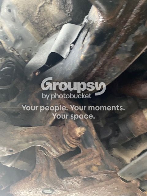

Thanks for all your detail! New to 4Rs, but not Toyota frames. Just picked up a 2006 Limited with 166k miles and a nice layer of rust, all NY driven. Did you end up painting it and if so, what paint did you use?
Planning on grinding with wire wheel, and then WD. Has anybody done this with jack stands?
This is what I'm dealing with, not a death sentence, but a war I want win with a good fight.
I'd hit that with a needle scaler. With a wire wheel, you're just polishing the rust. The needle scaler will remove the scale and get you to solid metal.
