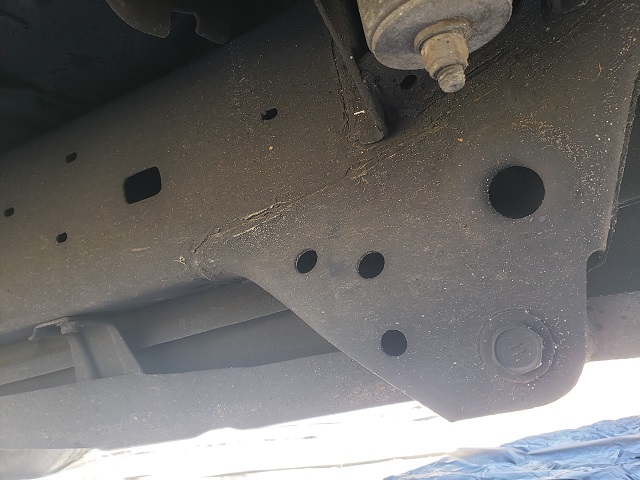

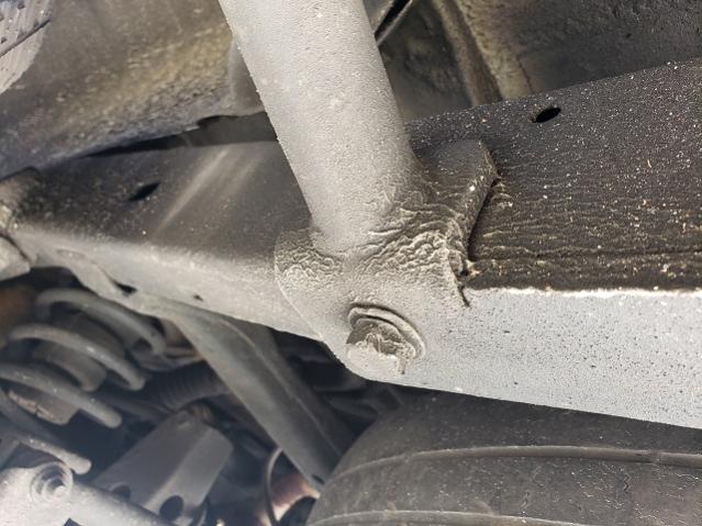

Updated pics and how its holding up. Here it is at 380K on chassis in November, just before I coated it for the season.

Can’t argue with those results.
An hour or two of work prior to every winter certainly pays off when your driving on treated roadways in the northeast.
Nice job and thanks for sharing the updated pics!
How does your inside of your frame look? Do you occasionally sneak a camera in there and verify the inner frame isnt rotting out from the inside?

another nice side effect of this, is that all your nuts and bolts are not all rusted. ( for future repairs) The underside of your car looks great knowing that you live in the rust belt. Hard to believe 330k+miles and almost no visible rust

Its all black and solid, I spray WD-40 inside the whole frame at 160psi with open spray head. Everything is covered in a protective grime. Noooooo F'ing rot or rust.

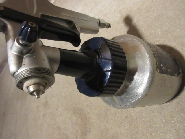

I run the gun with no spray head, not like a typical paint sprayer, so the droplets are bigger and more direct, more like a heavy dousing. I can blast thru a bottle fairly quick.

Is that a Kobalt spray gun you are using? Pretty sure I have the same one that I've been using for years.

Correct, that's a cheap Kobalt gun I got at Lowes.
