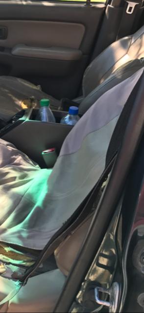

Im going to get new belts from the driver/passenger on my 98. My driver is literally patched together with another piece off of another car cause it doesn't even match the seat belt. Talk about a hazard waiting to happen.
