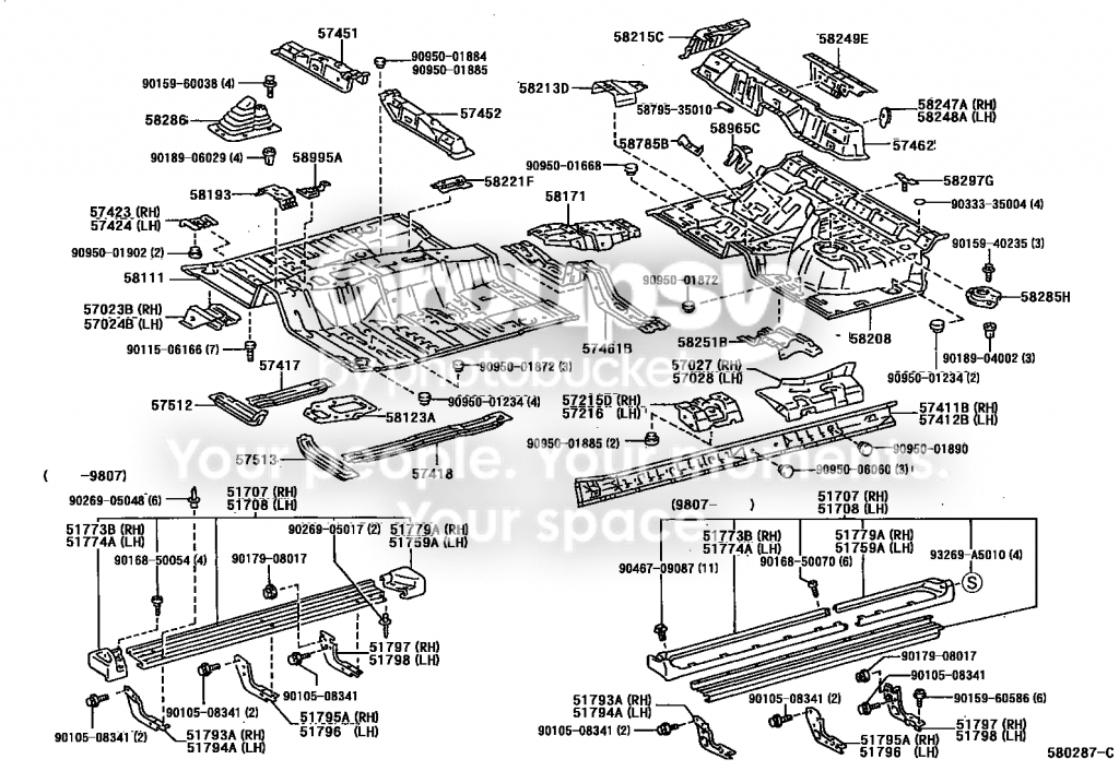

SEE part #57452 there are 2 black holes on ether side of the 45 ish degree slant on the front. those are the bolt hols and the nut is tac welded on the back side of there. Teachme you are saying the nut is lost. that is because it has fallen down and it is in that channel some where. it is there. (nowhere else to go or fall out of the car) its trapped between 2 pieces of sheet metal.

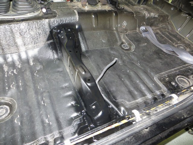

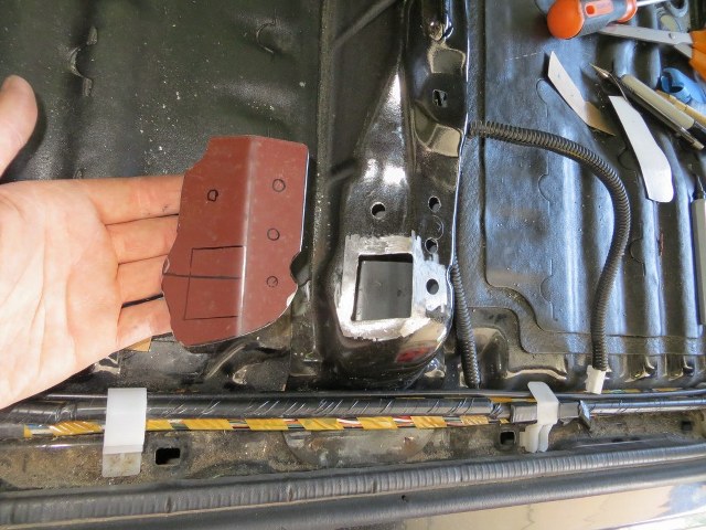

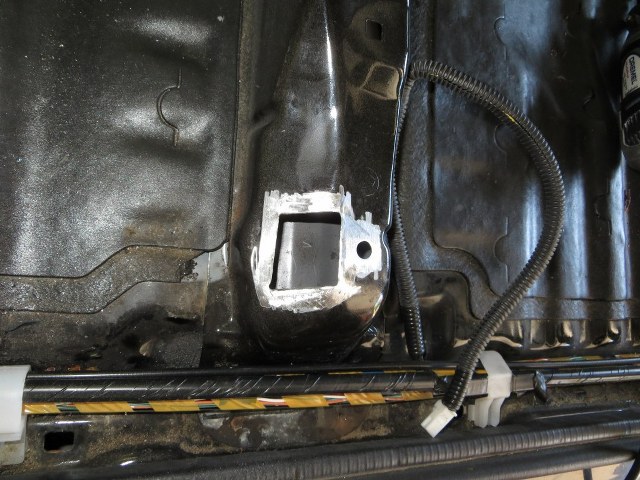

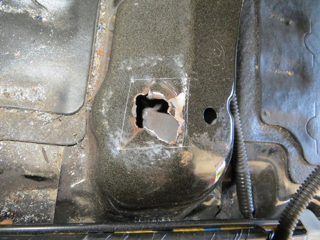

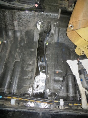

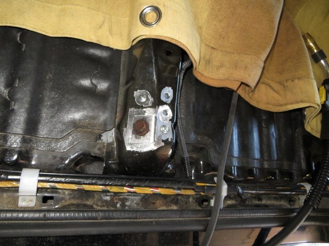

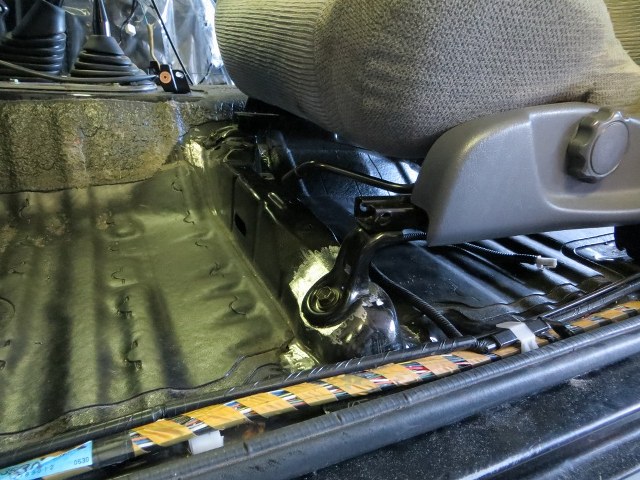

It is worthwhile to pull up the carpet and inspect the other spot-welds around the seat mount crossmember also. The nut for my drivers seat ripped thru, and I also found several cracked spot welds. Its best to fix this right the first time.
I made a patch from some scrap steel and welded a nut to it. I was able to slip it in from the opening in the back/middle area of the crossmember. Temporarily held it in place with a couple sheetmetal screws from the plug weld holes. Put a block of wood underneath, and used a seat bolt to push it up tight against the crossmember for welding. Weld, plug weld, grind, test fit, and paint.
Looks great!
