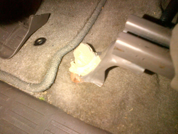

I ripped mine out (left front seat bolt on LH front seat) too - what I did was go to napa and buy a comparable sized bolt, matching nut, a large sturdy washer, and a smaller washer. I put the the large washer on the bolt and then wrapped a cable tie around the threaded end of the bolt and fished it through the hole in the back of the raised cross member and on up through the ripped hole, put the carpet back, the seat down and then through the seat bracket. Then I put on another washer, screwed on the nut and tightened it. Threaded end was sticking up high - so I wouldn't cut my heel (and have to cruise on back home) I put a piece of yellow terry cloth on it and fastened it with another cable tie:
If I ever get the right tool I will cut off the end of the bolt so I can put the plastic cover back on.
a hack saw can't be more than $10! Chop of the end of the bolt, then file (or sand) the edges. Easy, and much better than terry cloth!

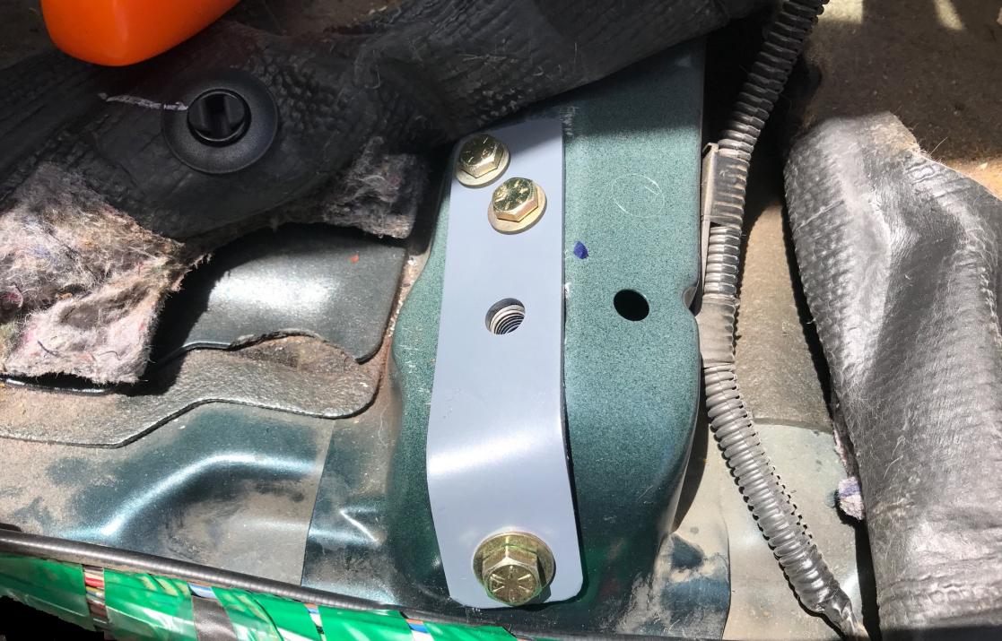

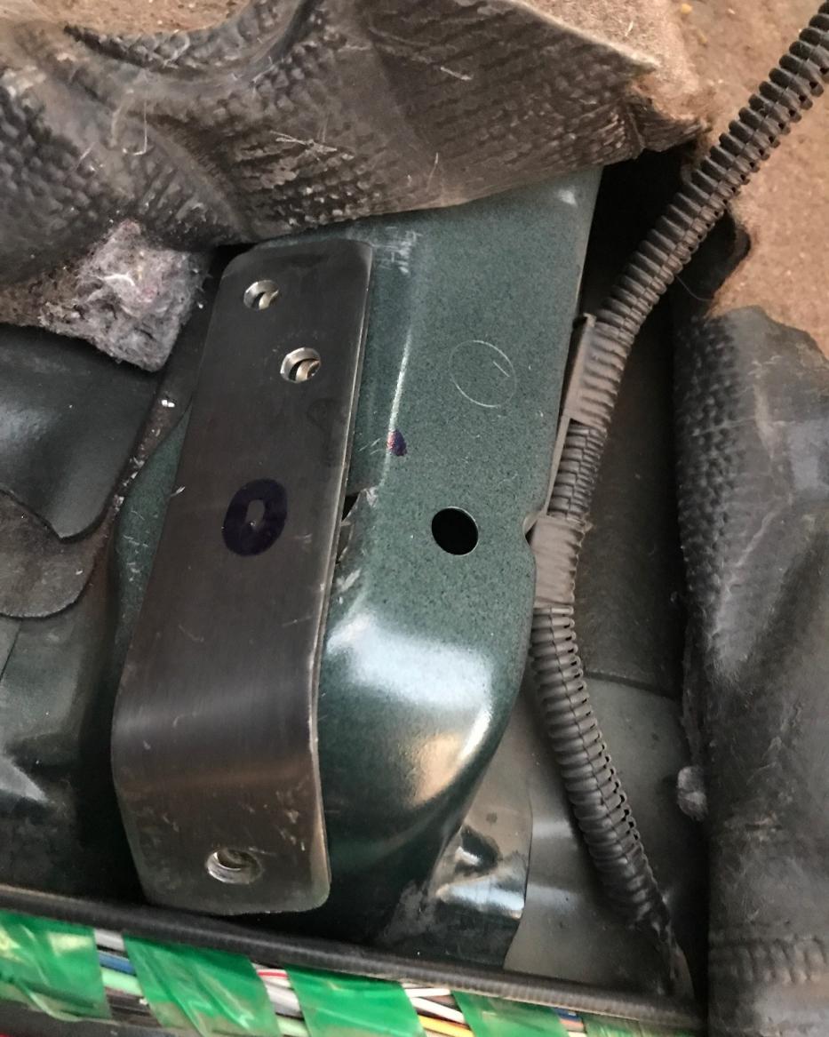

I ended up doing a pretty decent job repairing this. I had some 1/8" x 1" bar stock laying around so I fab'd (using a hack saw, file, hammer and power drill) a 4 or 5" long strip with a hexagonal hole to fit the nut. I just drilled the hole about the right size, then used "excessive force" to smash the nut through the bar stock.
Next I fiddled the metal behind the cross member from the opening in the back, then used self tapping screws to hold it in place. I was pretty impressed with the results. Would have done a much better job if I had access to a welder of some sort...

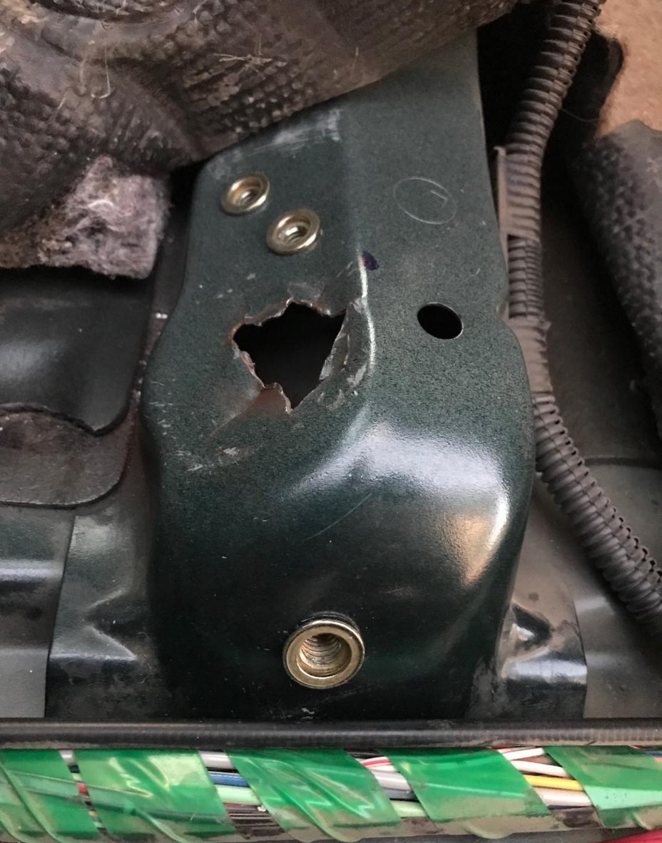

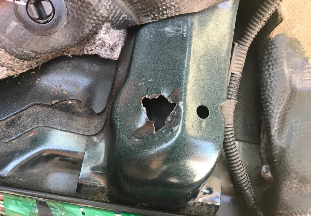

this is mine. Not sure if the previous owner wanted to see if his new ice pick worked, but this was absolutely destroyed. the nut was still in the hole though thank goodness. need to cut out a bit of metal, and weld in some new stuff with the nut welded to the back of it.
and as the picture shows, the nut is not in the bottom, but in the sheet metal welded to the floor.

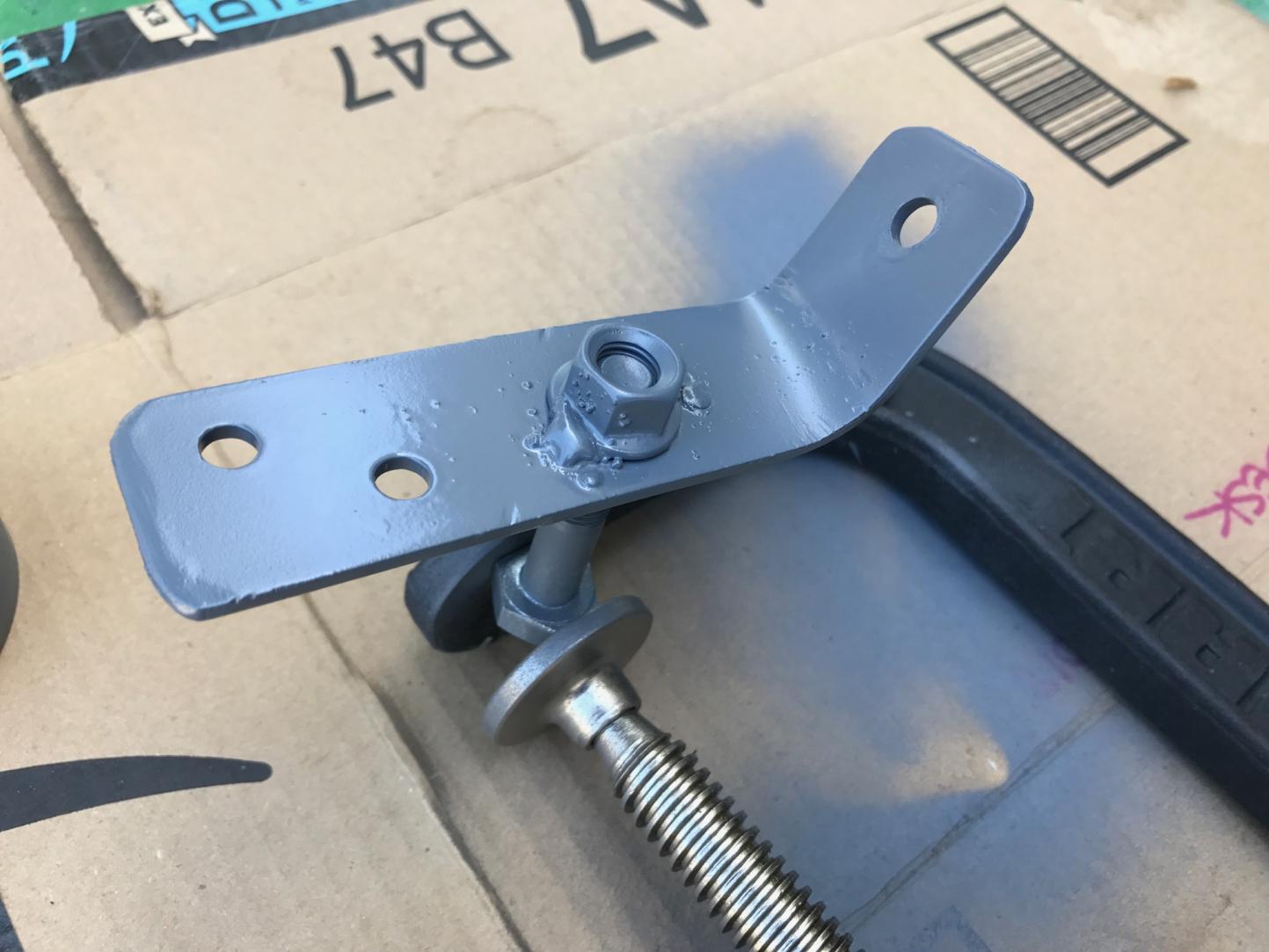

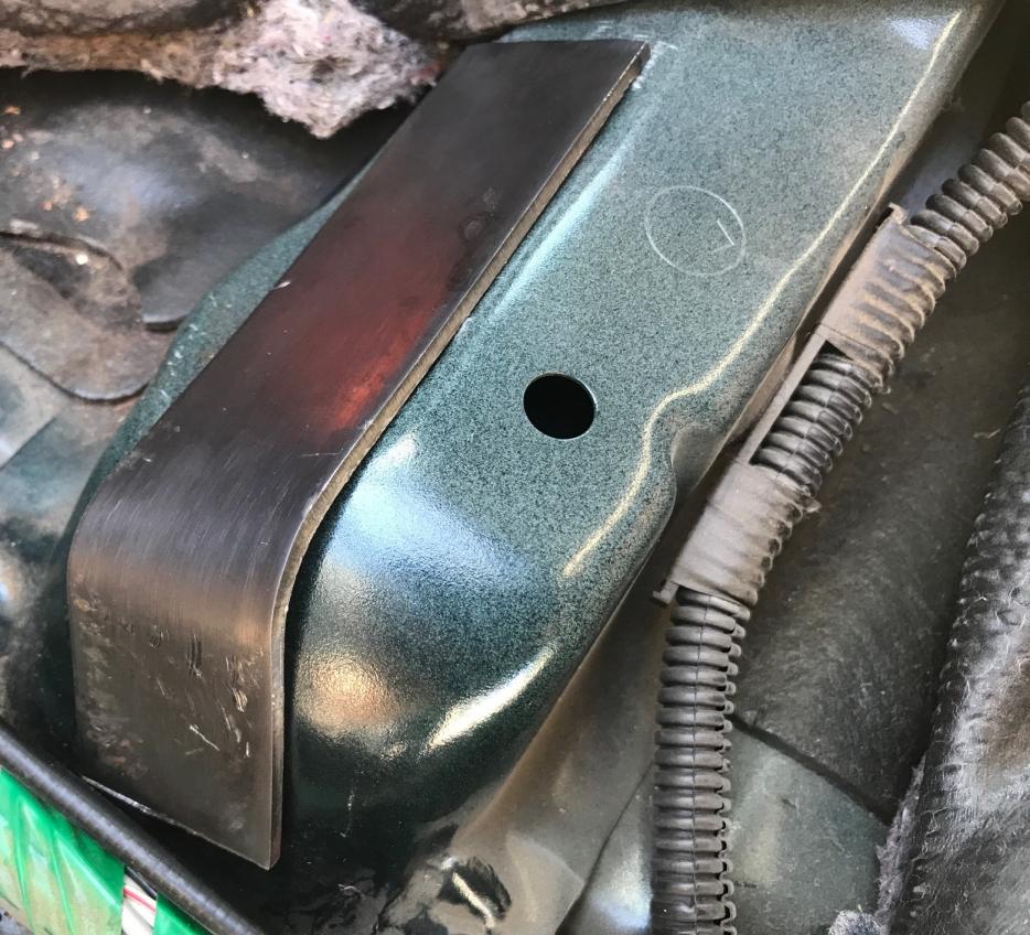

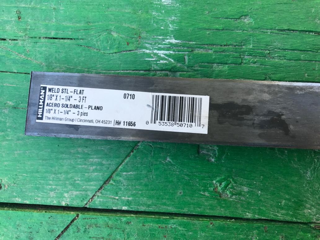

My version
Just thought I'd throw in how I fixed mine. Used some 1/8" X 1 1/4 flat stock, formed it, welded the nut to the backside and added rivnuts to the mounting area.
