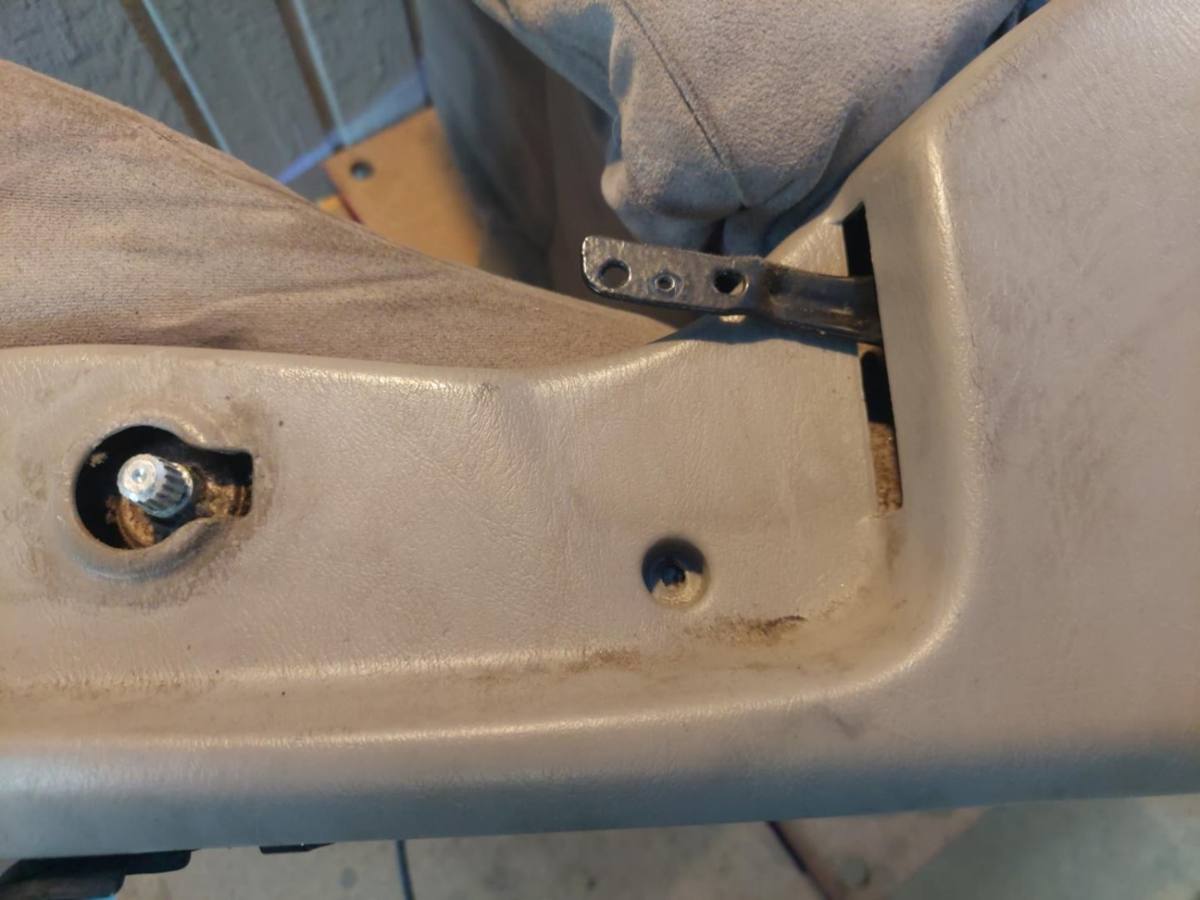

For anyone removing the plastic side shield on a 1996–2002 4Runner manual seat:
After removing the adjustment wheel and any retaining screws, don't pry the shield straight outward.
The opening around the adjustment-wheel shaft has a notch that allows the shield to disengage from its retaining point.
Slide the entire plastic shield forward to release it. Once it clears the retaining point, the shield can be removed without forcing or breaking the plastic.
I've attached a photo showing the notched opening.
