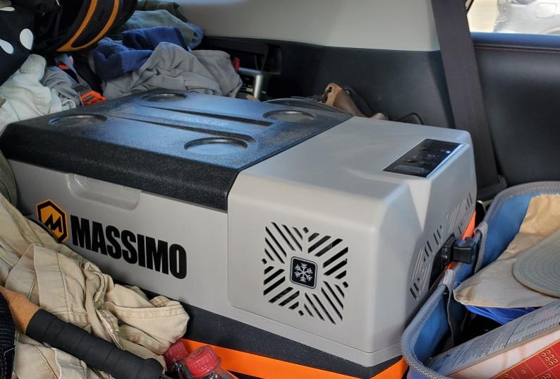

Wow! That is a pretty awesome setup. I had planned on writing up a short review of the Massimo fridge we used during our Western Rocky's road trip. I like your setup as it creates more space by deleting the seat we don't use anyway. Our set-up has issues lol.

Thanks! Yeah, the driver's side rear seat seemed like a great trade off for this. The top level of the platform is offset towards the door a couple of inches to give as much room as possible for the middle seat in case someone had to sit there. When not camping or traveling, I undo the two seat mount bolts and remove the platform to put the seat back in.
