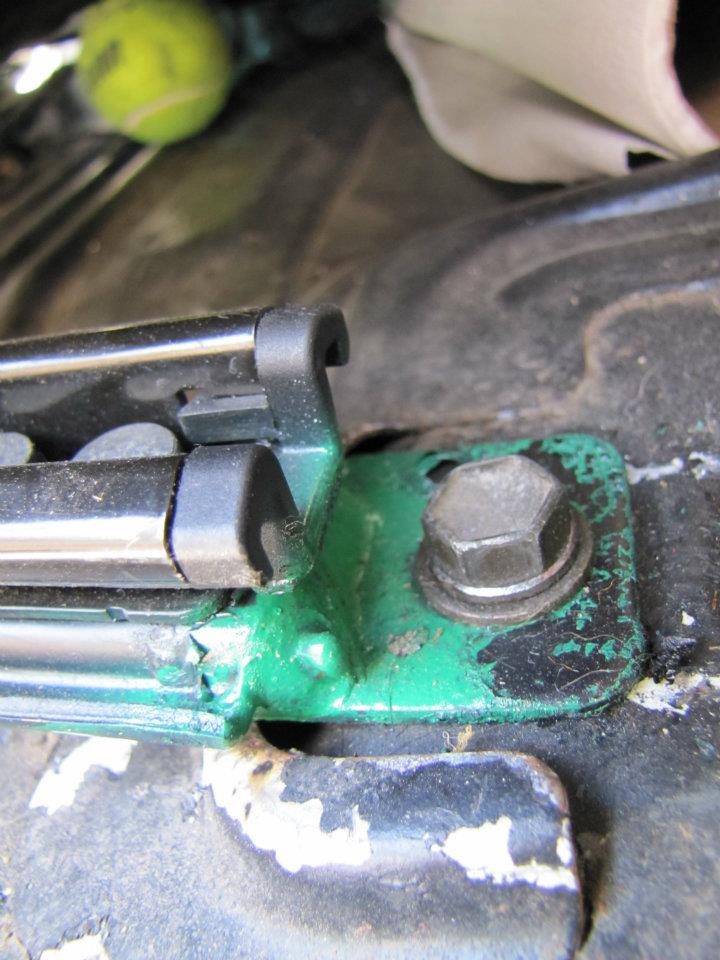

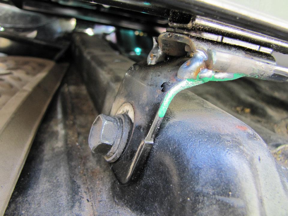

Put Hyundai seats in my '85 4runner and had to modify mounts. I was wondering if any welders out there can tell me if they think this is safe to ride in?

just going from those pics .. I would say no .
I see no "burn" on the inside of the front support ..
looks like a "blob" of metal to me
Grind that down smooth then notch where the two pieces meet. Turn your welder up one setting and try again. This time, when you're making the bead, let the puddle determine the speed of your weld. Keep the nozzle of the welder (or wire) in the forward 1/3 -1/4 of the puddle and walk the puddle forward.
Your welds look like they were too cold for the steel and you moved forward too fast before you had any real penetration.
OK, I will go back and try again. I am very much an ametuer welder. Thanks for the input folks! Next time will be better.
I would hate to fly through the window, or bash my face due to my ****ty welding skills!
Why not get some scrap steel and practice? Get some 1/8th strap and weld the edges together both flat and 90*. If you can get the basics on 1/8th, then move down to some 16ga and do it again. Then move down to 18 ga. Welding the thick stuff is easy, it's the thinner stuff that's harder.
