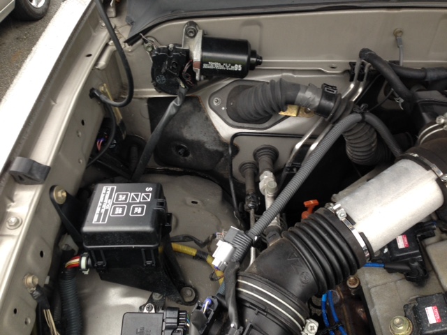

Hey guys, i have spent some time (only about 3 years) looking into and dreaming of running an auxiliary battery. I just received my dual battery kit and am deciding on a final resting place. I have seen all of the setups where they run them side by side where the original battery location is but all of the dual battery trays seems to be custom fitted for an optima or are $200+ .. I noticed a big void in the top left corner (passenger side closest to firewall) where on all my previous runners the abs lines were. It looks like i would just need to relocate the fuse block and i could look at getting a relocating kit for a little cheaper (or have a guy weld a little platform there) and set it up. Here is a pic of the area i'm referring to. Anyone tried this or see any issues? thanks

I have a 4cyl so I cant go look, but from the pic that location looks ok. it should be an easy job to weld a little plate for that spot.

I think the concern with that location is heat as the headers are right there. I've seen people with air compressors in that location, but had issues with the compressors shutting off due to high heat coming from the headers. Not sure if that's a concern with the battery. Just something you might want to research.
I run an AGM in the back, I thought of moving it to the exact spot you are talking about since i have no ABS either, but my battery is wayyy too big. So it stayed in the cargo area. I'll be running my Compressors there instead when the time comes.
I have a small AGM battery that fits perfectly there without relocating that fuse block. There is a oval sorta hole where this threaded stud will get a nut on the underside as well as a matching hold down bracket with a threaded hole in the fender itself. There will be a small platform as well to sit the battery flat, purely for aesthetics.

What about where the airbox is? You'll have to do something different with the filter, but otherwise big flat spot just like the one on the other side...

I thought about the airbox area.. it would be almost too perfect i wonder if i could re route the hose and airbox but would it not need to remain where it is in order to get fresh air? IIRC it connects to the fender where it draws the air from.
What about a heat shield for the battery?

I'm pretty sure I've seen others put the second battery where the airbox goes, replacing said box with one of those intake tube/air filter set-ups. You'd have to chase that tail yourself, if you're interested. I also saw a dual battery build that put the batteries under the truck, rather than in the engine bay. Have also seen people put the battery up on that right side fender as was originally mentioned.

I'd say reroute the intake to where you were thinking about putting the battery make a box for it, and just go into the fender there. Boom intake silencer removal mod and a perfect spot for a second full sized battery.?

I've actually done the intake removal already and just did some quIck measurements.. It doesn't look like the airbox would fit in that area. The box is a little too deep to make it. I guess if I were to make it work I would have to do the deckplate mod since the hole to draw air in would be right next to the headers.
I could look at running just a short ram intake with filter but it would have to be custom and I'd have to find a way to attach the MAF sensor to it..

I'd say straight pipe into a box with a cone filter and a straight pipe into the fender. So it pulls air from the fender.:noidea: just a suggestion.
