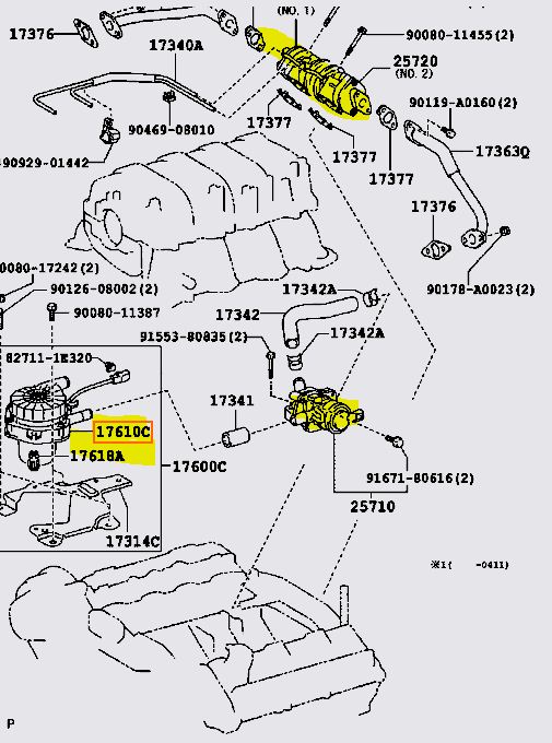

Here's a quick rundown of the failure and how they function along w/ potential fixes:
The following is copied from the AIP bypass page on Tundra solutions forum:
SAS Failure:
If you are not familiar with the Air Induction Pump Or Secondary Exhaust Valve problems on the Gen. 1a and Gen. 2 Tundras consider yourself lucky.
Although Toyota extended the warranty on the 2nd Gen tundras to cover replacement or repair of the system plenty of us have been shafted and stuck with only 2 options to remedy the problem: pay several thousand dollars to replace/repair the AIP secondary emission system or go to lengths to bypass and eliminate the system all together. The AIP system simply pumps air into the exhaust on startup to help get the catalytic converters up to operating temperature faster and thus improve emissions. It does not have any affect on performance unless the system fails. Two modes of failure are common. The air induction pump fails or the exhaust valves get stuck open or closed. I encountered a pump failure on my 05' Tundra DC XSP a couple of months ago, since it is not covered by warranty and the quote I received from my Toyota dealer was $3400 to replace the system I began working on an engineered solution to disable or bypass the system. Disconnecting the pump will disable the system but cause its own engine code. If your exhaust valves are stuck or leaking you will also need to install exhaust block off plates to prevent exhaust from flowing back into the system and causing "limp mode" even if the system is bypassed.
You have a 9 year old truck and you experience a problem, now you want it covered under warranty when it expired 4 years and who knows how many miles ago?!? When they don't you say," I will never buy a Toyota product again", even though you like it, until the possibility that you had to put money into it. Unless of course they give you something for free LOL.
This is borderline crazy, put any other product into the place of your 4runner. Not many companies are going to willingly replace something 4 YEARS outside of the original warranty period.
Listen, most of the times this is an easy fix, and can be done in a few hours with hand tools for NO money 90% of the time.
The inlet pipe for the air pump has a foam filter, which over time with engine heat cycles,starts to deteriorate. When it does it gets sucked into the pump (occasionally damaging some fins in the pump, generally not enough damage to cause the pump to not work), and push the little bits of chopped foam straight into the valves. This causes them to stick.
Snatch off the intake, remove the foam filter, and blow out the pump with compressed air. Remove the valves and use a power probe (or a jumper wire from a 12v source, IE your battery) to actuate the valves and remove any pieces of foam stuck. Then reassemble and you're done. Iv done this to countless tundra's and 4runners and have had VERY few need actual parts replacement, although occasionally it is necessary.
