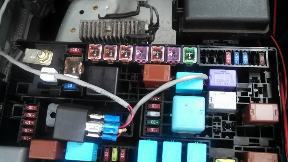

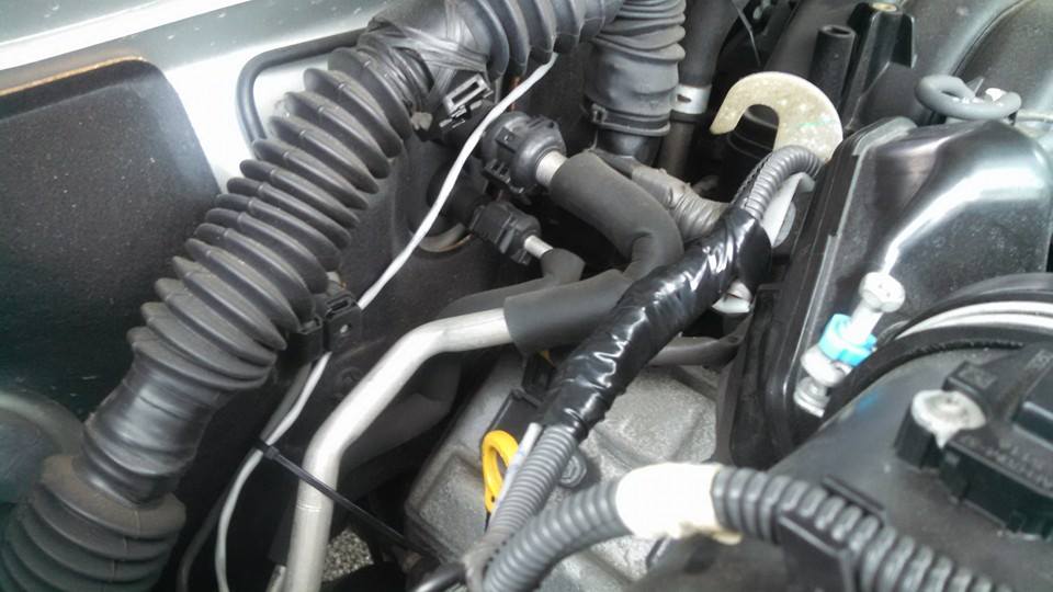

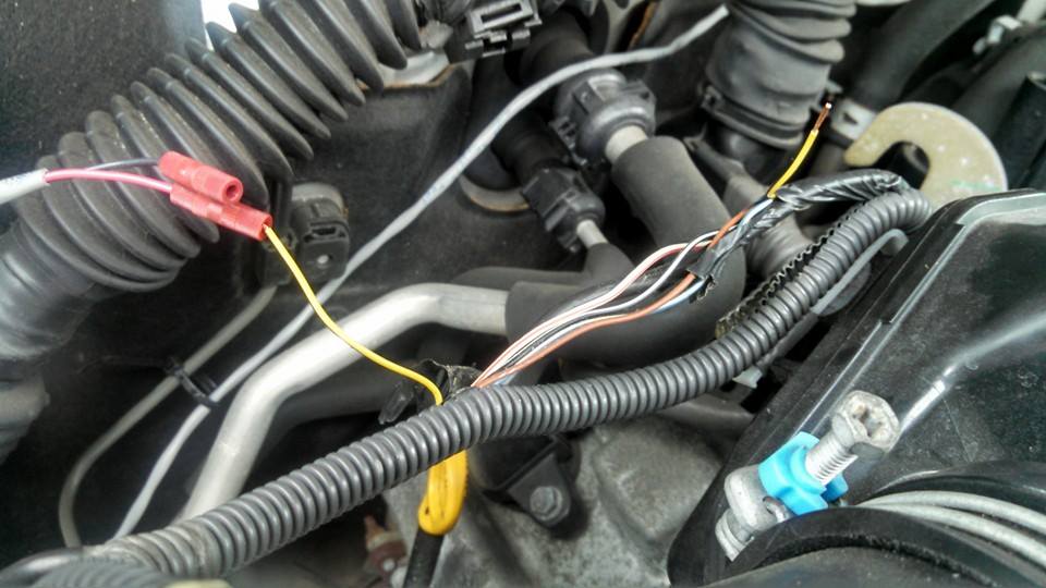

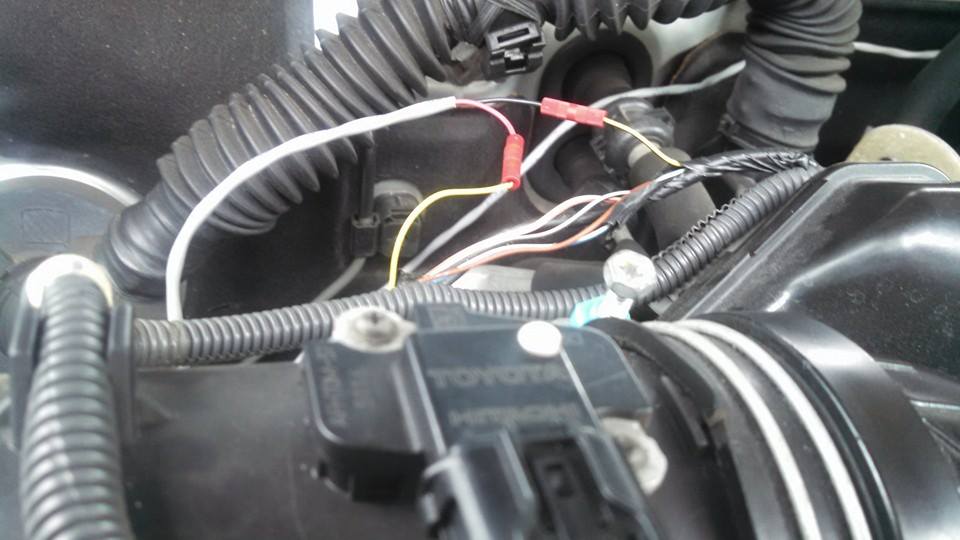

Today I have installed SlyFox's ST relay kit. Extremely easy to install. I know I should have done this a long time ago but I needed to go through the motions. Slyfox, thank you for the quick turn around on the order.
