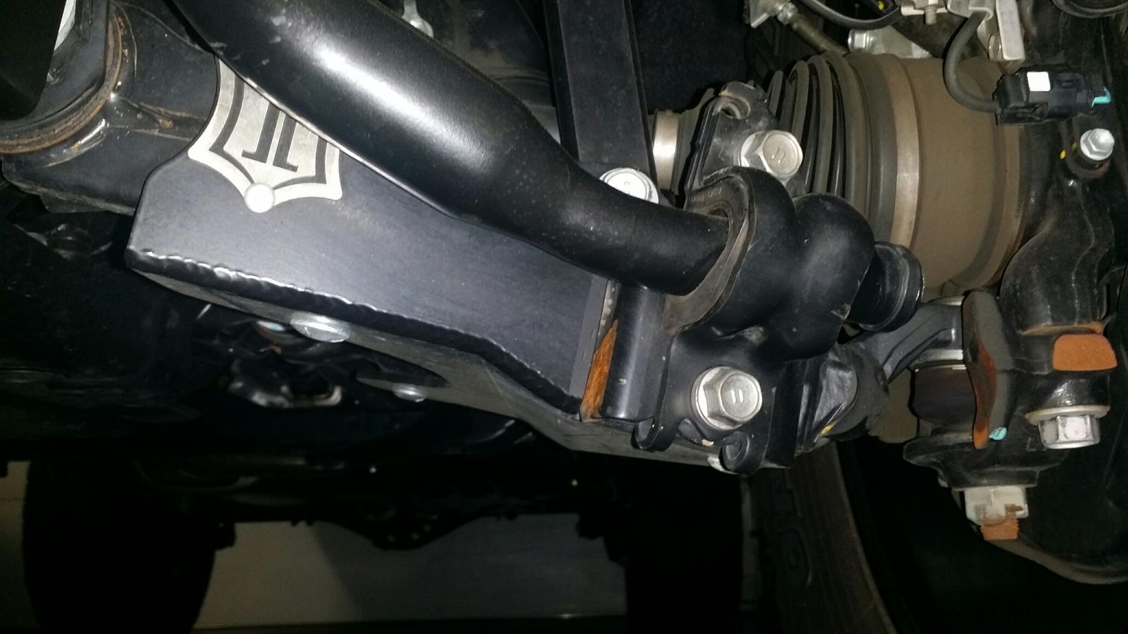

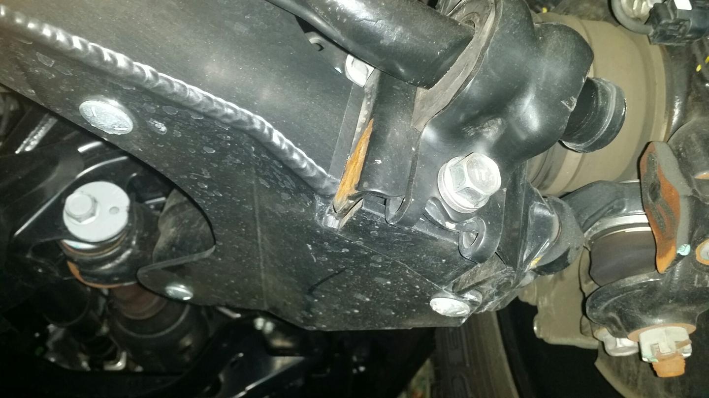

It may not be compatible in the sense that the skid plate occupies the same space as the end mounts.
A simple fix is to notch the plate.
x2, take a look at the mounting of ICON's S2 setup for the skid plate and see if you can just notch the skid plate. Otherwise total chaos has a LCA that will work. skid plates are cheaper lol
