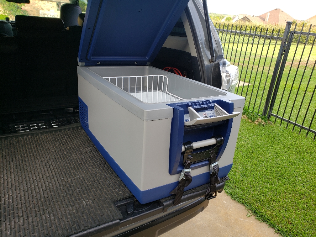

1. Whats the simplest way to secure it, if I want to be able to take it out of the vehicle when not in use?
You can just use ratchet or camlock straps through the handles on the fridge to the tie down points in the front and rear of the trunk area

I secured the fridge with these floor grips (I’ll have to find the link). No issues with it moving. Before that used a ratchet strap.
