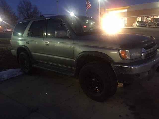

2001 4Runner SR5 4x4, Thunder Cloud Metallic/Gray (everyday driver)
290K miles. I bought the SUV with 75K in TX. I am the 3rd owner, first owner was in CO. I am in MO. Under carriage is pretty clean but some surface rust.
Timing chain/water pump changed at 150K.
Replaced O2 sensor (Denso)
I had to replace the catalytic converters. with NOT OEMs which were welded in place.
Replace transmission fluid at 150K.
Replace struts and shocks (Monroe) at 220K
Ran Mobile 1 synthetic since 75K and changed every 5K.
Plugs changed a few times with Denso plugs. Factory wires.
Changed the radiator at 250K
November: 4Runner was hit while stopped at a red light by someone texting. Slightly bent rear bumper but little damage. Transmission problems started after this. Mostly not crisp shifts.

QUESTION: Do I replace the transmission or sell the SUV as is. A rebuilt Toyota transmission is $3.3K installed with 1 year/12K miles warranty. I keep going back and for on this. Engine burns a little oil but overall seems healthy. Check engine light P0420 comes on every once in a while but I attribute that to NOT OEM catalytic converters and just reset the reset check engine.
I don't have the time to change the transmission.
