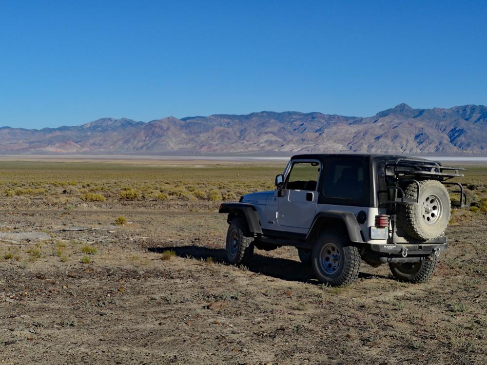

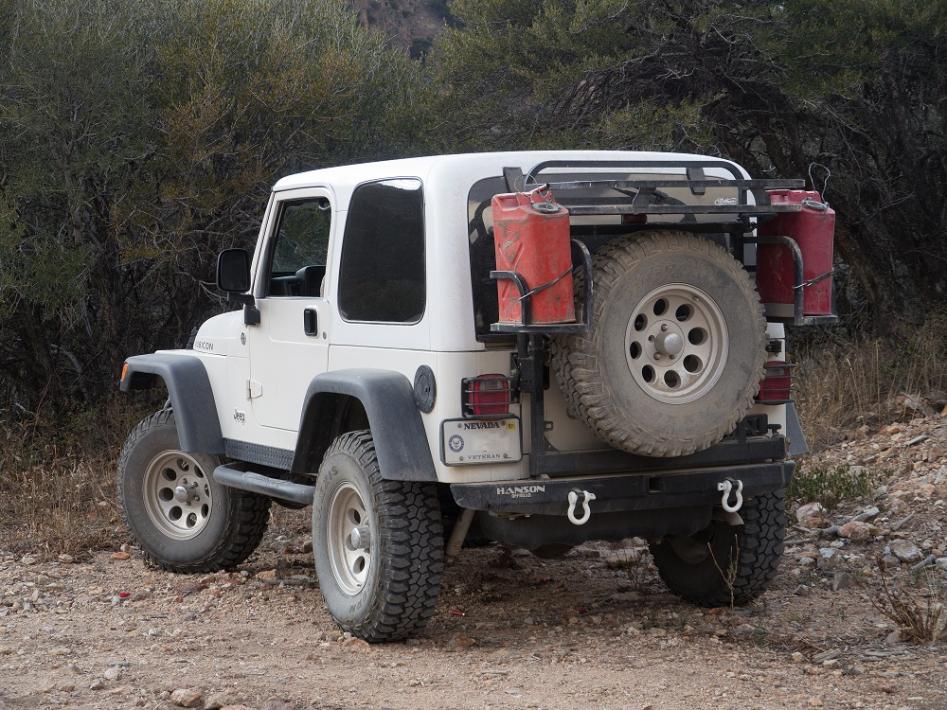

Like most Jeeps, the roof on mine was black and I hated it. In the Nevada sun in summer the heat absorption was awful. So I painted it...took 7 cans of Krylon Fusion Colonial White Paint. Thing to remember when rattle can painting is to prep the surface well (must be very clean) and put down many thin layers of paint and not try to change the color with just a couple sprays. Mine still looks good after 10 years:
