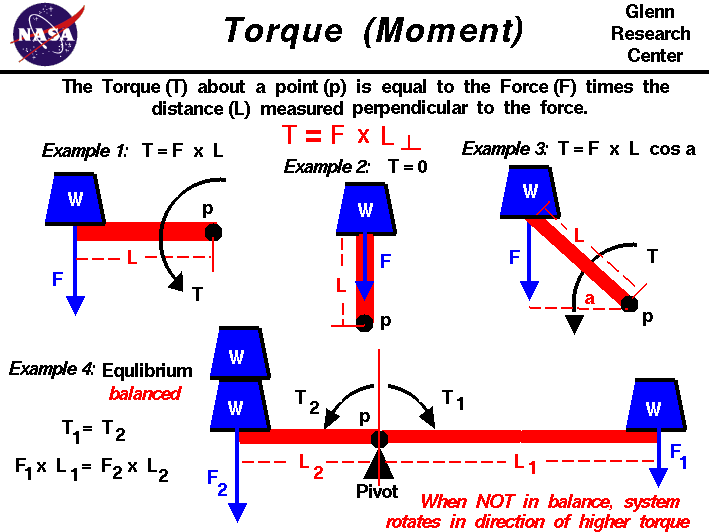

It may be a semantics issue, but I would disagree with your first statement. Torque is a rotational force. We just happen to use linear terms (lb-ft etc) to measure it or specify it.
Semantics be dammed. The engineer in me will not back down from this one.

You are both correct and this argument of torque is a force or torque is a moment is mostly semantics. Or, maybe from a scientific standpoint, it is a matter of relativity.
Torque is the rotational analogue of linear force.
Linear Work = Force x Linear Displacement. Rotational Work = Torque x Rotational(Angular) Displacement.
Not all force is torque, but all torque is rotational force.
All squares are rectangles, not all rectangles are squares.

For semantics of torque we are all saying the same thing but I think it’s still important to note that:
torque = force * distance = moment = “rotational force”
Torque ≠ force
Ft * lbs ≠ lbs
Both are vectors but bodies can be under both force and moment and it’s important to distinguish the two during analysis.

I agree mostly with El Dusty. Perhaps it is all in nomenclature and semantics, but torque is a rotational force; a force is a force, no matter whether your push in a strait line, or twist.
