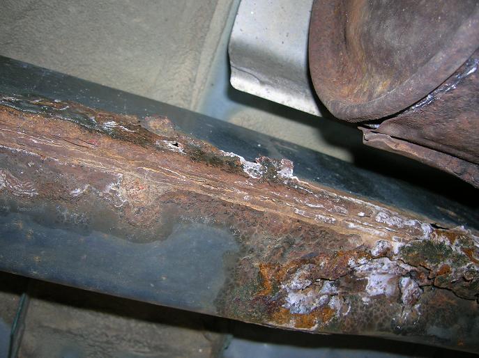

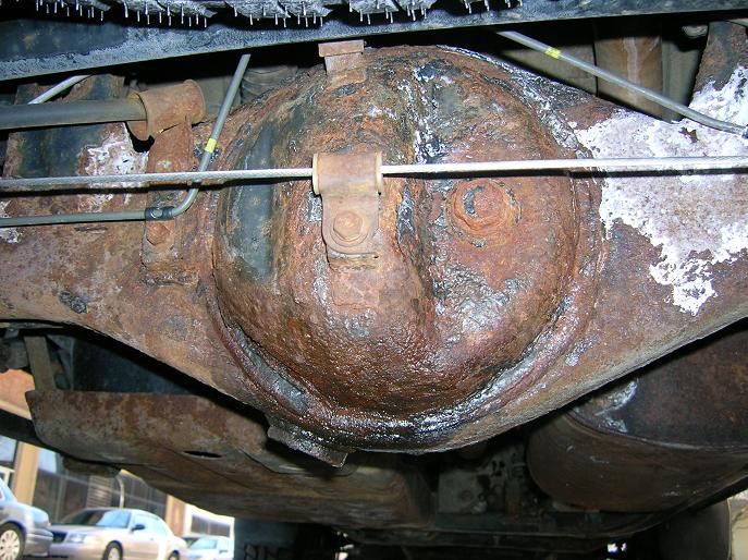

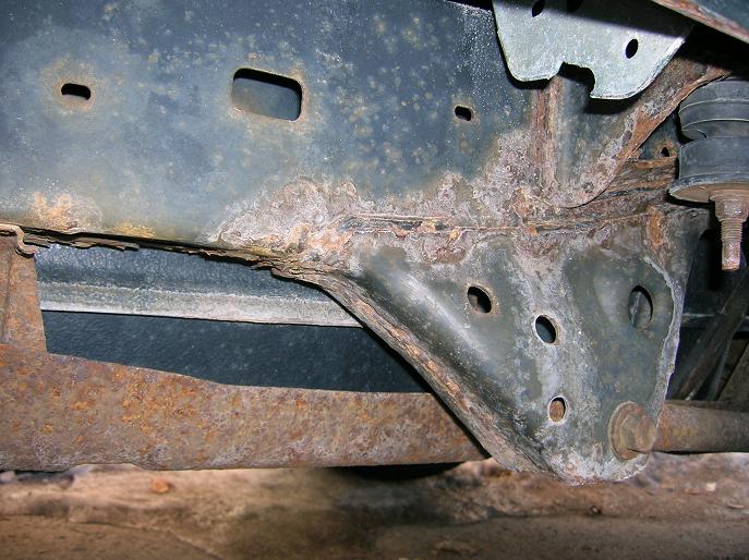

Okay guys, here are some pictures. This is the only spot that was bad. Actually, the rest of the frame looked pretty good. This is the inside flange of the chanell. The outside flange looks good and so do the top and bottom flanges. They all should obviously be cleaned up and treated.
What do you guys recommend that I do?

I see worse than that every day in Nova Scotia. I don't know how one would fix something like that, though.
Wow, looks terrible to me, but I do live in the south and started freaking out when I saw my first patch of surface rust! Hope you get it taken care of!
Sh!t, thats land rover rust status.
You fix it by patching it, many land rove folk cut sections and weld new bits of metal in, and i would suggest this cause the replacement frames aren't readily availble for 4runners.

We'll see how this works. I'm hoping I stopped it in it's tracks. As for yours, I would do the same to all the areas I could get to that were still in decent condition. As for the areas that are rusted through, good luck. The suggestion of cleaning the areas and having steel plates welded on to span the holes may be the only real fix.
You fix it by patching it, many land rove folk cut sections and weld new bits of metal in, and i would suggest this cause the replacement frames aren't readily available for 4runners.
Yeah, I would suggest finding a local welding shop and talking to the guys there about how to fix it. I may be wrong about this, but I think an actual welder would be much better to talk to than a mechanic that welds. These old guys in weld shops are gold mines of experience, much more so than a young mechanic whose primary job isn't welding.
You might also ask about making symmetric repairs (e.g. if you weld a patch on the inside of that member, then do the same on the other side whether it needs it or not) in order to avoid generating asymmetric stiffness in the frame. You likely already have that because of the rust, but that can cause unaccounted for stress risers, especially if you drive the vehicle hard, or off road in it. They may say you don't need that, which is fine, but it comes to mind as something to ask (especially for as big a patch as you will need).
Another thing to ask a welder about would be stress relieving the welds. Usually this entails cooking the whole frame after welding, but obviously you can't do that; but they might have some tricks to help relieve stress in situ.
Anyway, I am not an expert on welding, but it pays to ask some thoughtful questions, and get the guys talking. They will usually teach you a bit of what they know, and you will understand the situation much better. Just go in humble and teachable and most will be happy to talk to you.

Ok, you are beyond the point of "what to spray it with", you actually have wirebrush the rust off (as much of it as possible), and then you should cut the jagged sections off, and then patch it with new steel.
Once you have the rust off and the jagged pieces cut and new pieces on, you then coat the frame in POR-15 or Wax-oyl, they are 2 well known rust prevention coatings.
I would suggest fixing the frame sooner than later, as the longer you wait the worse this progresses, and the more dangerous, and costly it will be.
I will not suggest you use galvanized steel to patch it, as welding galvinized metal is fairly bad for your lungs.

here is a run down of different rust treatment chems, from restoring old rusty vw's that are from the 60's-70's i have a fair amount of experience with this sort of thing, first thing to do like said above is to wire brush everything you can reach off back down to shiny metal, once there see how bad the steel is pitted,weakened and all of the rest, check the general condition of that beam,
if it looks as if it's far more then surface rust, i.e. there are cracks,holes, gouges, ect in the beam you have to weld it, like others have said go to a welder, this won't be cheap, if it looks like it's surface rust get as much of it out as you can and then use a rust encapsulater, followed by an inhibitor these do different things and you must do them both and in that order ,otherwise like others have said it will start to rust underneath the rust-o and whatever else you throw on there and then you have a even bigger mess on your hands.
