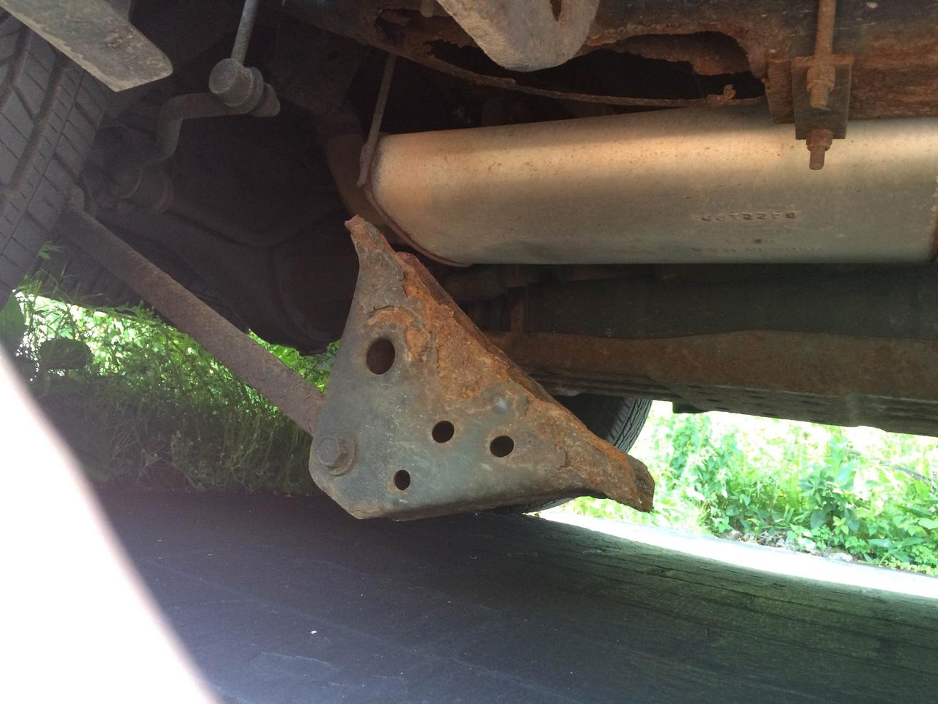

I've been trawling the Forums here for a couple years since I bought my 3rd gen 2000 SR5 w/5speed, but this is my first post. Not to "revive" this thread from the dead, however I have a genuine issue.
The other day while driving home, my passenger side rear suspension linkage disconnected from the frame, leaving the transfer case floating. This happened due to the fact that the frame has rusted completely through, as you'll see in the picture.
I'm the second owner of the vehicle, and unfortunately the first owner did not take proper enough care of the frame and underbody (as I also have pumpkin/rear diff issues and have rebuilt it, however that's another story).
As of right now I'm upside down in the 'Runner as I still owe just shy of $1200 on it. I really love the truck and am not sure what do do with it.
I was quoted ~$800 to repair the issue I've posted, however I need to get under it and decide if it's worth keeping when I get it repaired (as that's the only way to obtain any sort of trade in value for it and not take an immense loss imo) I need to call my insurance company, now that I think about it and see what, if anything they have to say.
Opinions welcome. Those of you who have done the weld repairs, (Wallace) how are they holding up? How much did you end up spending in entirety on the frame welding jobs? I absolutely love the truck and don't want to lose it, however there comes a point where I need to cut and run, so right now I'm deciding if I'm there or if it's salvageable.

no first hand experience here but I know others have successfully re-welded their rear lower arm mounts. Passenger side is like the most common rust point on our 3rd gens. There should be a plenty out there that have had similar results!
:bump: anyone?... Buehler?
You're going to need to inspect the frame. With ripping the mount completely off you have some substantial rust on, and in the frame. Get under it with a brick hammer or something to poke with. Start poking around to so how far the rust goes back, and how far it goes forward. For less than $800 you can buy a welder, metal, and fix it yourself. I've had to cut a section of frame out for repair, and plan on cutting out more after this winter. I would just be concerned with the amount of rust you're going to have.

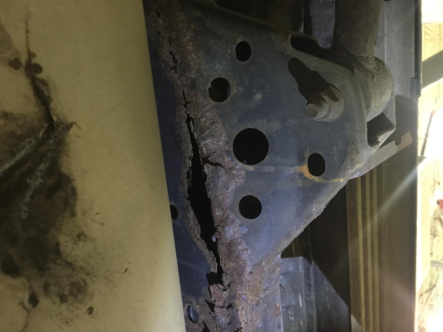

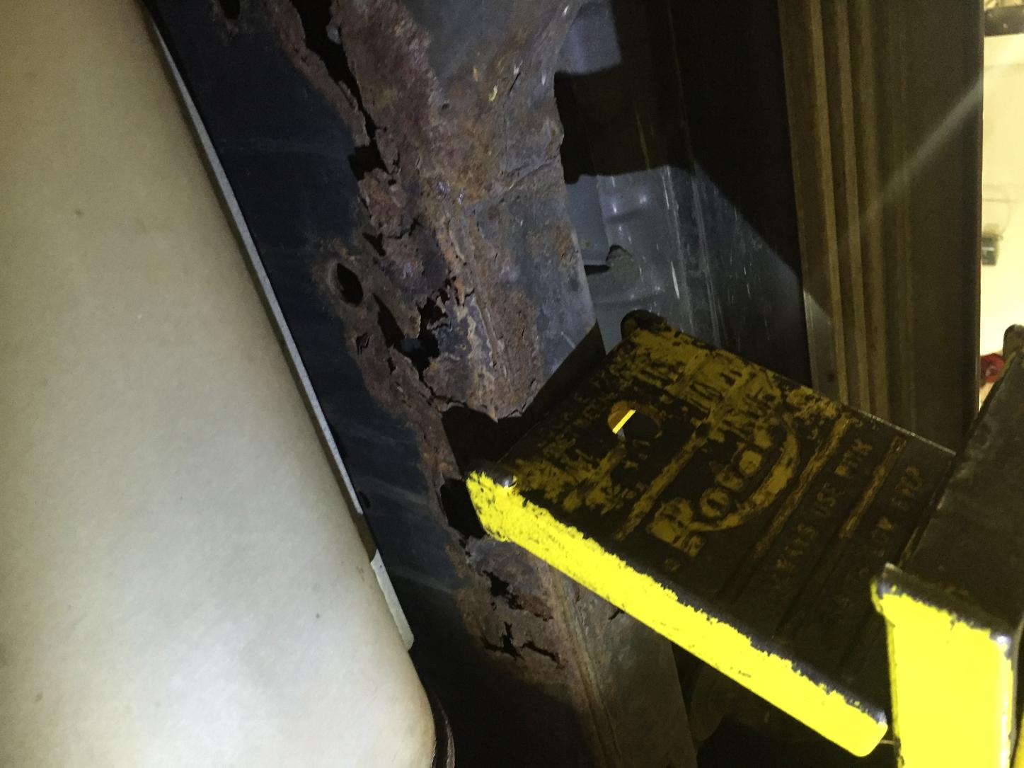

First time poster, long time reader.
I have an 01 Runner with some rust on the frame (back right passenger side just in front of the wheel)....Pictures attached.
My questions is does anyone know a good place to get this fixed in the Kansas City OR Atlanta, Georgia area? I know those places are far apart!

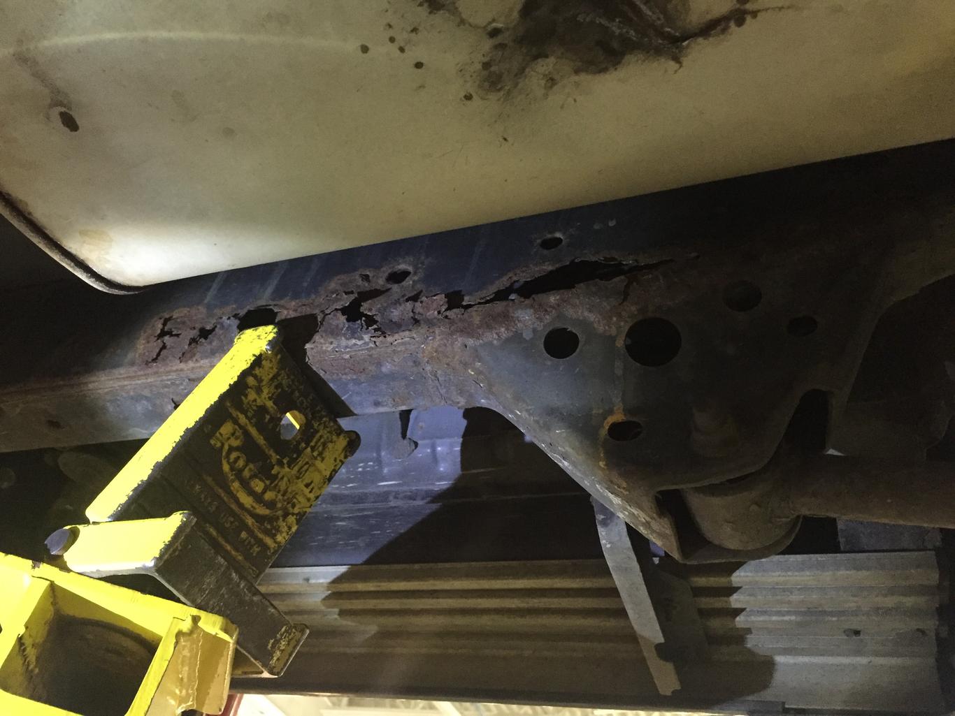

Frame rust nightmare
Hi all. I'm new to the forum. I bought a 1992 4Runner with 138k miles on it. I'm nervous to admit it's the first vehicle that old that I've ever bought. I didn't do my due diligence in inspecting the vehicle.
The frame is rusted so badly on the rear, driver's side that the shock mount and the spring are either broken or bent so badly that two welding shops have said it's unfixable.
Are there frame sections for sale that I can buy and I'm just not finding them. I can weld, and weld well, but I'd rather put it in the hands of someone who does it everyday and has the facility to do so.
This is my only means of transportation and I'm pretty desperate to get it repaired and done correctly.
