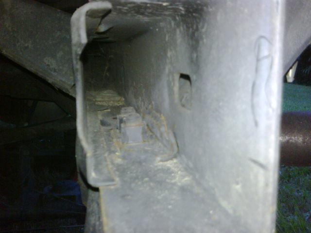

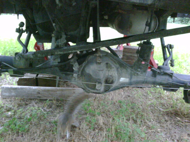

X2, I still have the '96 that NelsonMD got the rear axle from. The rear frame looks good. I'd have to look to see if it got bent any from the roll over. I know the front did.
Here are a couple of shots I have on my work computer showing some of the frame and not seriously rusted up. The truck is from south florida, so there is some light surface rust in spots from being near the beach. Of course, the axle is under Nelson's truck now :)
The squirrel is my buddy and he was coming over to say HI.
