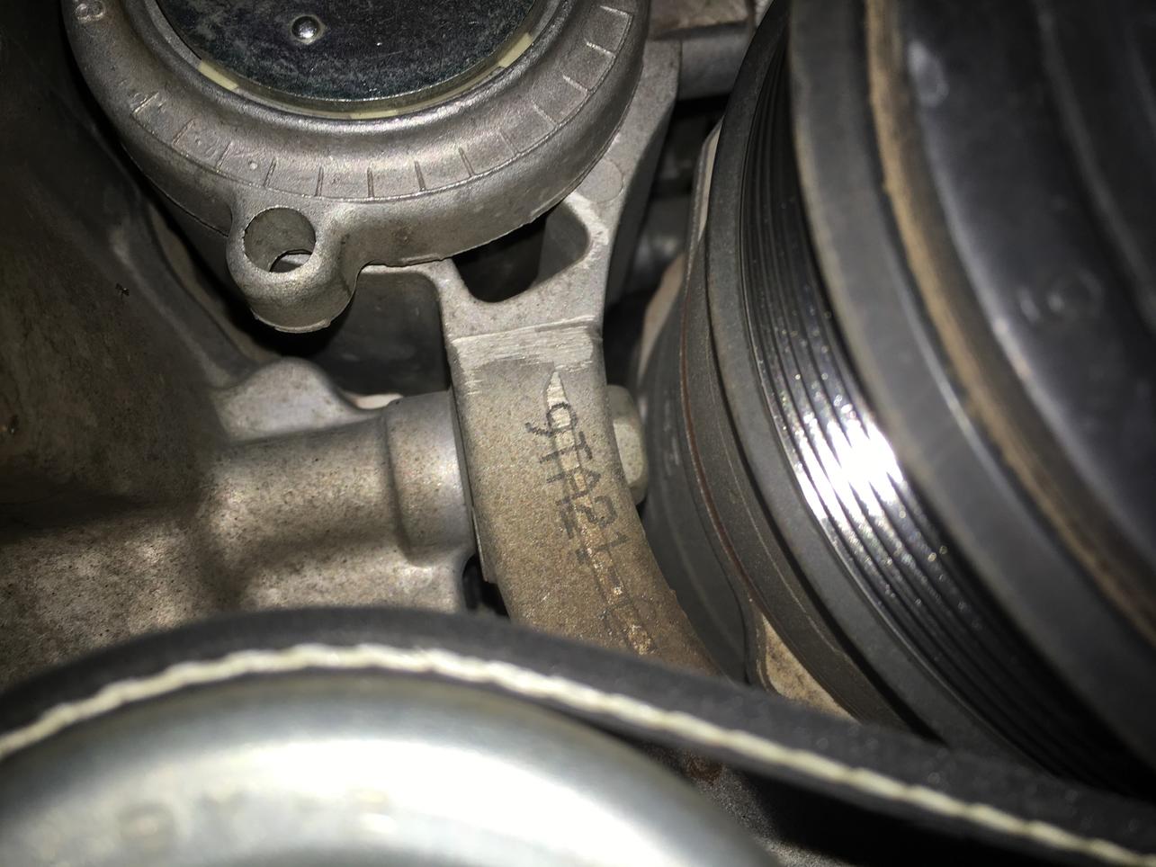

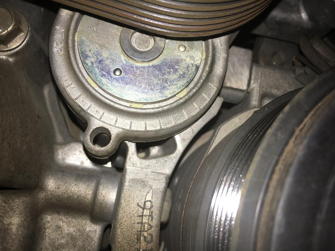

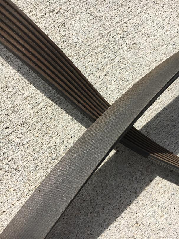

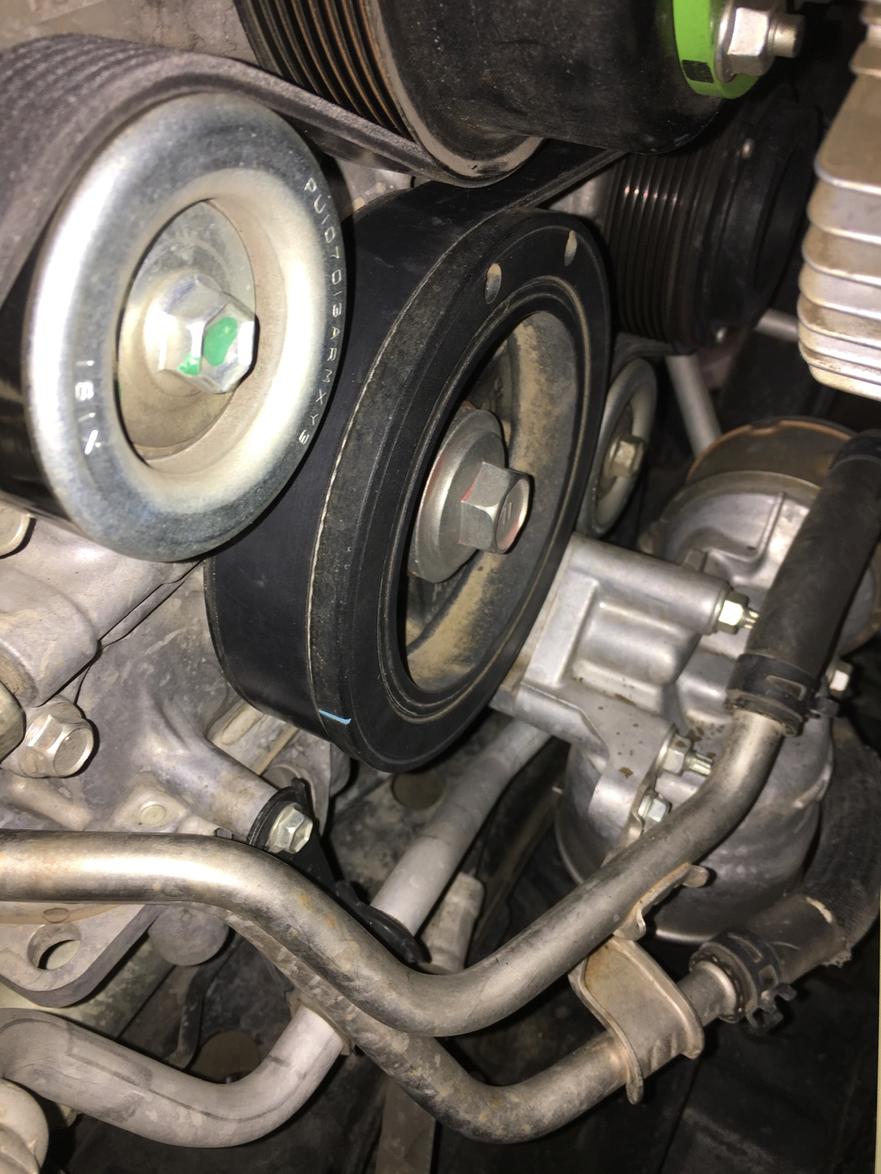

Did mine today while I was waiting for my front diff to drain. Was pretty straightforward, the hardest part was feeling around to find the hole in the tensioner that locks it back. Like trkymfns said, most of the time is spent checking the routing is correct. The Bando replacement looks to be better quality than the OEM I took off. Judging by the before and after pics of the tensioner, this belt is larger by one tick mark. My 2010 is an early build, they may have changed the spec to the 2150 at some point early in production.

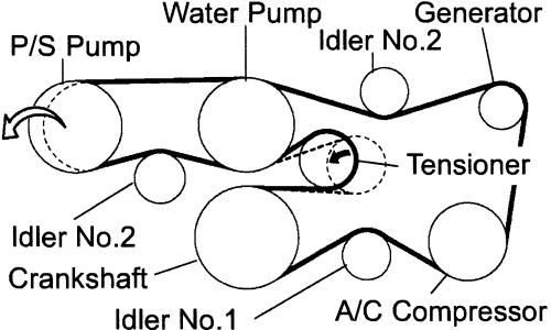

See the diagram. Several idler pulleys. The other accessories also have bearings. When you take off the belt you can spin the pulleys with your hands to see if they turn smoothly. Replace if they’re bad. They’re expensive, I wouldn’t replace unless necessary. They will usually give you some warning but I just had a friend who had one go out while up the mountain and he drove 20 miles on a frozen one. He said it cooked the belt and made a hell of a noise but made it without breaking.
A couple of notes, since I just did mine:
- I have a 2010, and I'm fairly confident the OEM (unmarked) belt was a 2145, based on length, so that's what I used. It sounds like they may have switched at some point.

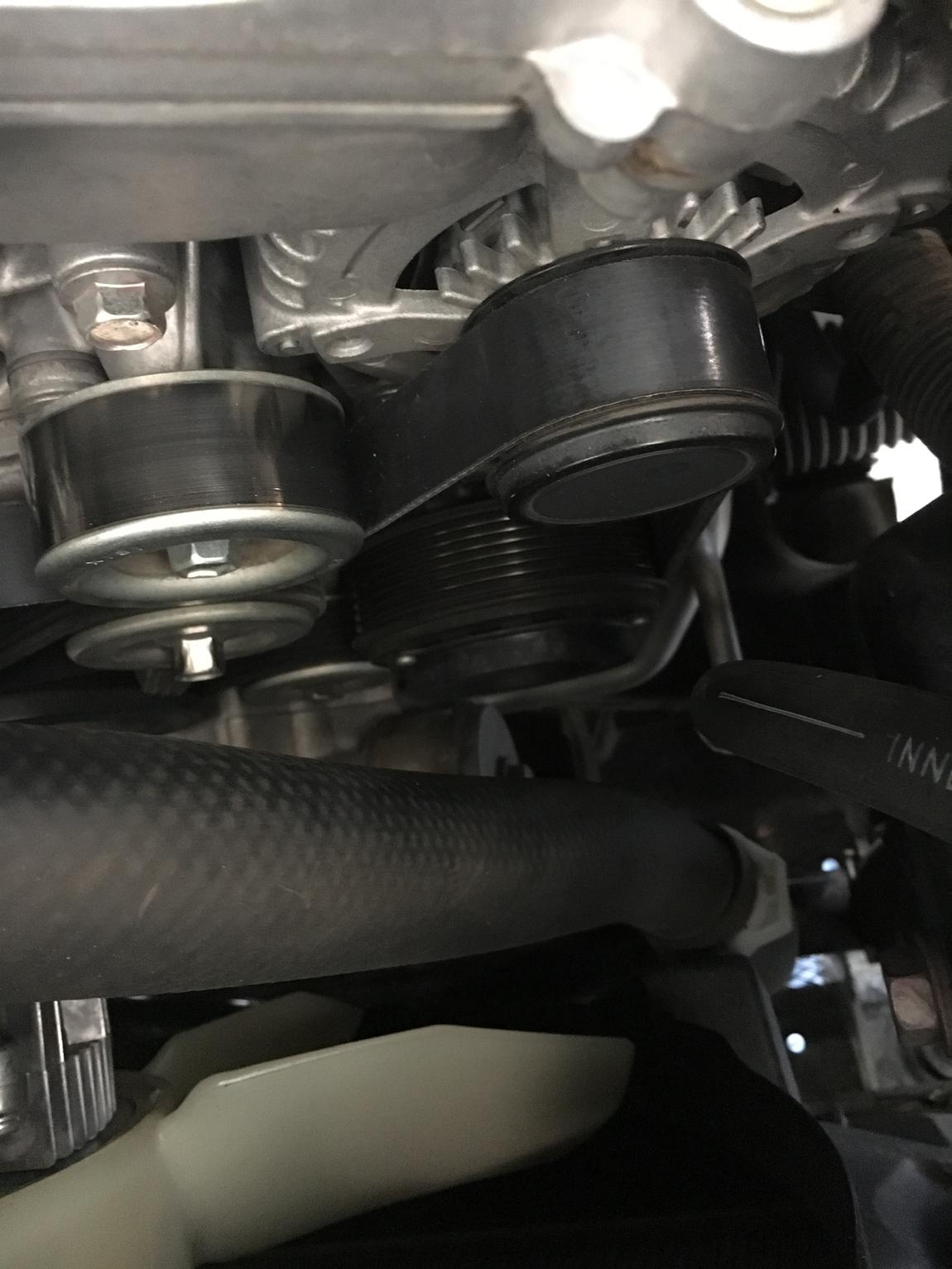

- The hole in the tensioner was much lower than I was expecting - even though the pictures do show this, I thought it was part of the tensioner pulley when in fact it's part of the assembly below the pulley.
- I had to use a 1/2-in ratchet (with an extension, but then a short socket) to get enough leverage to move the hole into the next "section" that it grabs on. The ratchet has to go between a hose and the fan, so getting the right length tool is important.

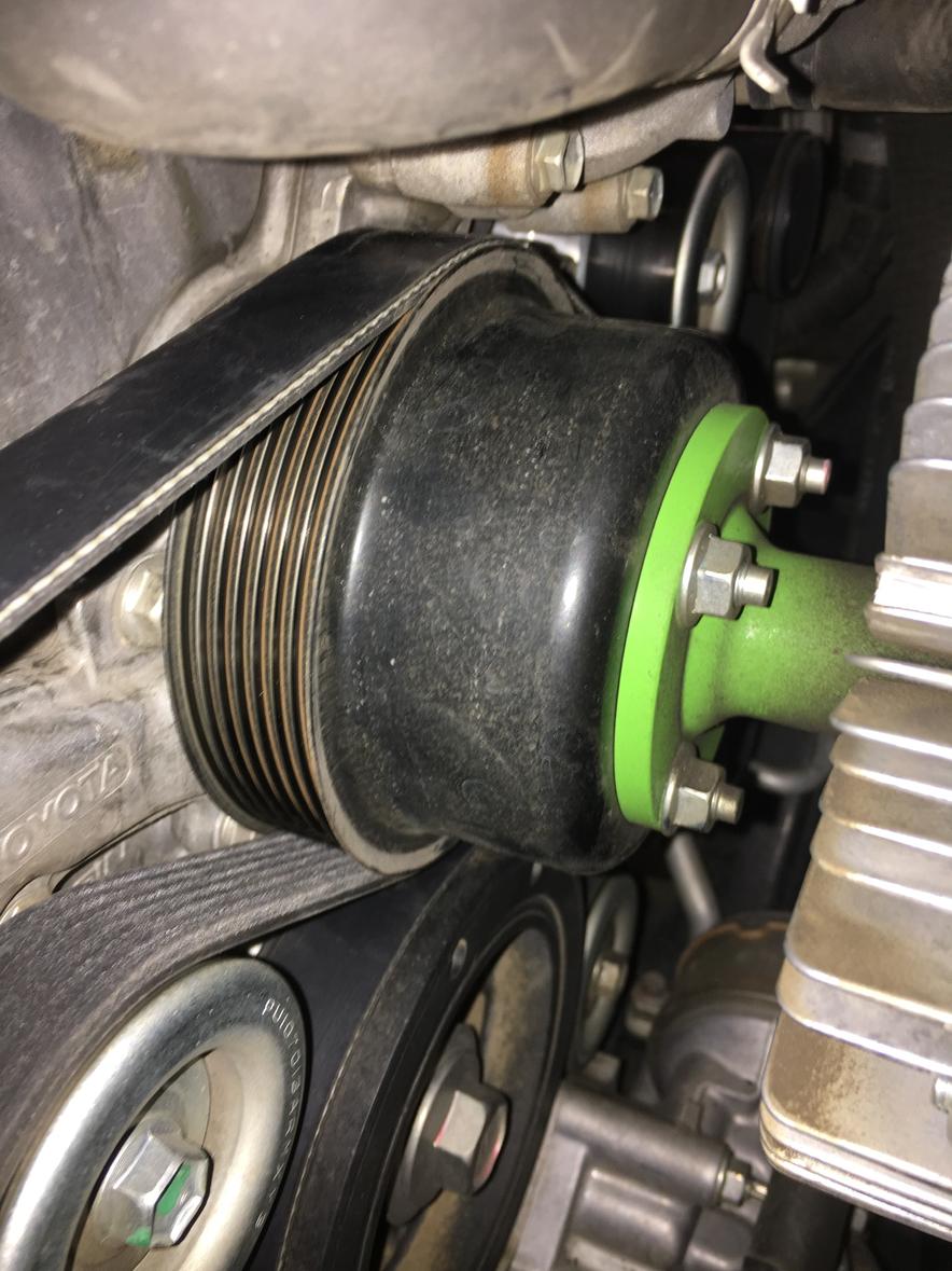

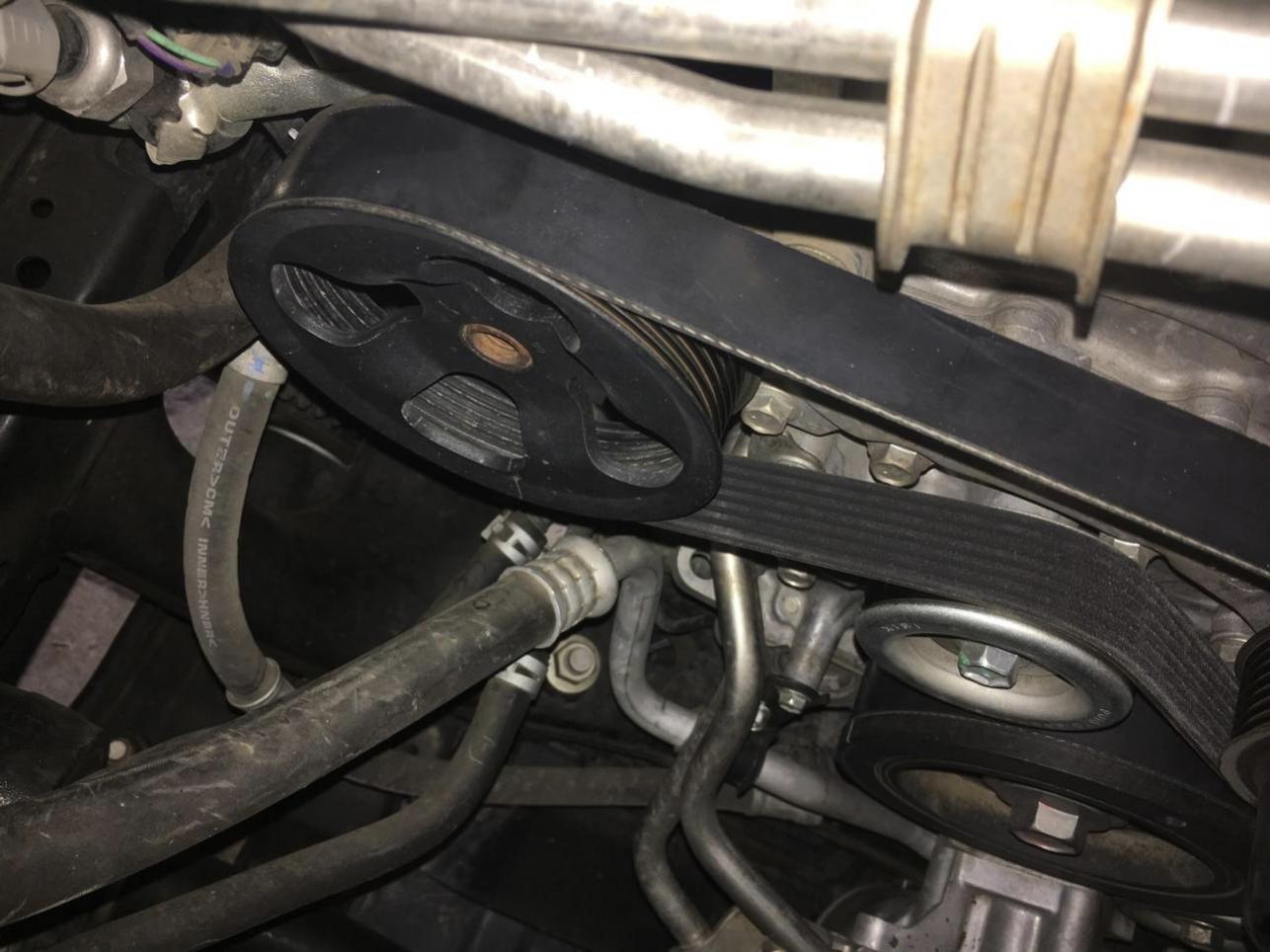

- This may be a "duh" thing but at first inspection of the diagram I thought the belt would end up pulling out on one side or the other of the water pump/fan shaft, but that's not the case. You have to feed the belt around the front side of the fan to get it out.
- At first I didn't think the 2145 was going to fit, but the belt wasn't properly seated in the crankshaft pulley. I put it back onto the tensioner last, which was nice because even loosened it was snug, giving me some guarantee that I had threaded it properly.

Overall easy job. Couldn't find the hole to lock it back but an 18" breaker bar with 12 point 14mm deep socket made the job easy. Hardest part in reinstallation was getting it under the fan pulley cause the clearance was so close.
