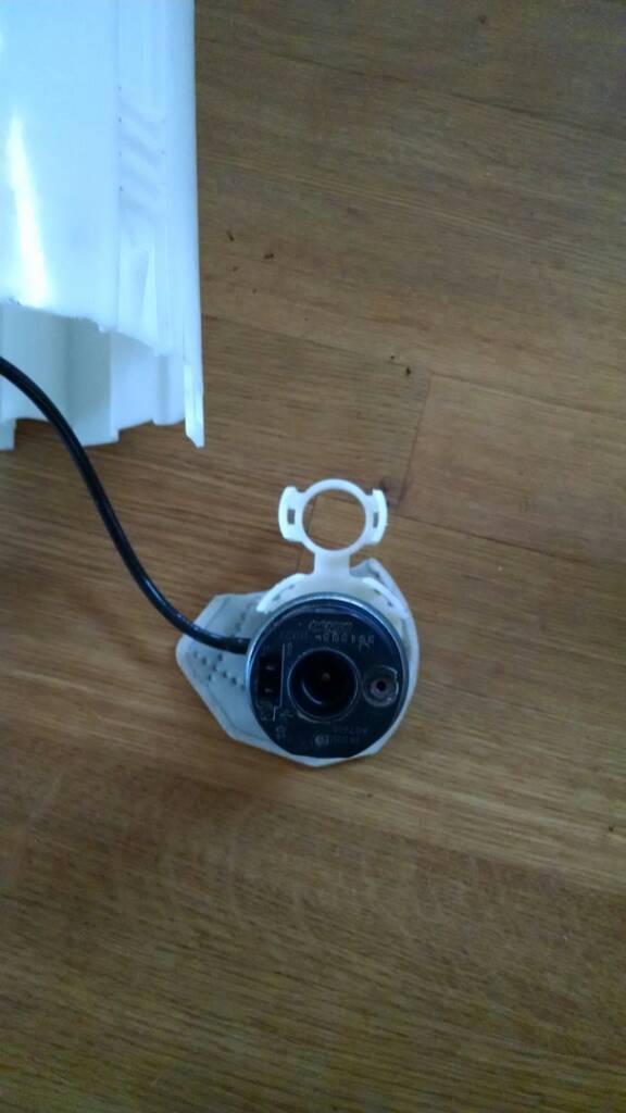

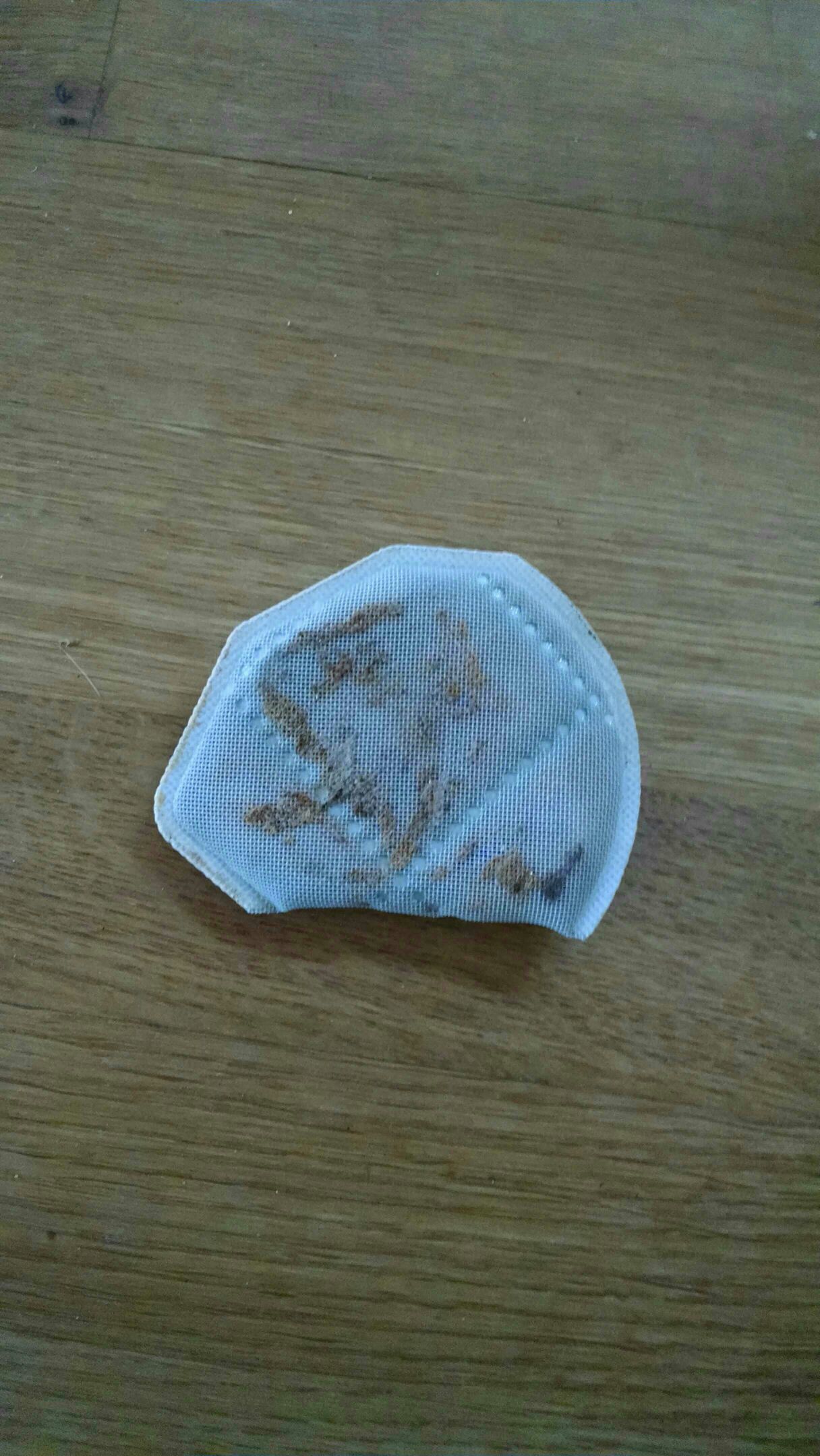

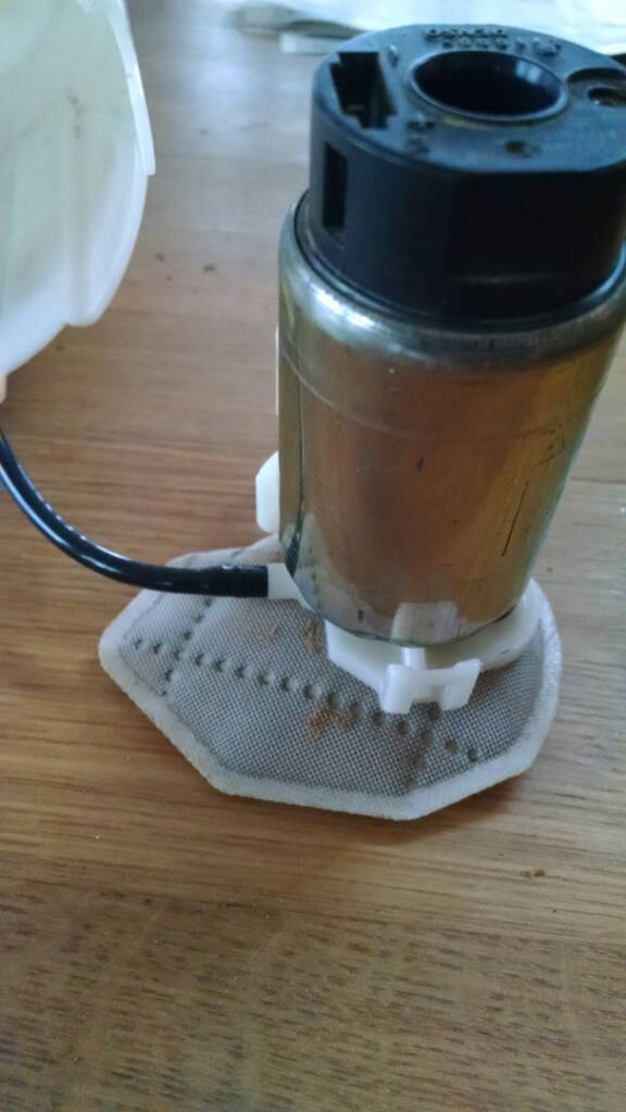

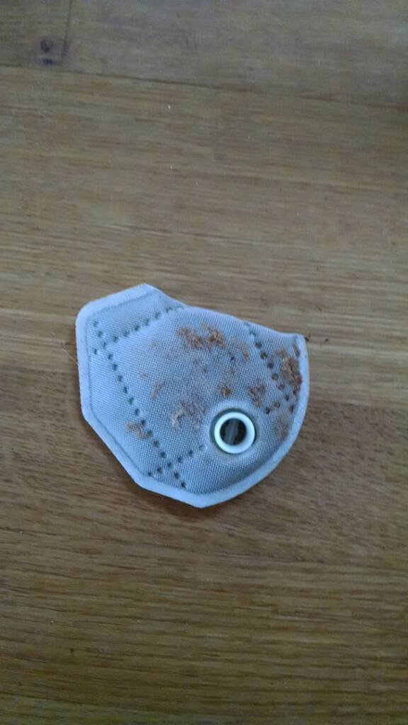

I agree but given that the main filter at the fuel pump can't be purchased separately w/o purchasing the whole assembly, I'd like to know if an alternate filter exist that will snap on to the Denso pump? Just trying to save some coin by not having to purchase an entire fuel pump assembly.
According to Find My Part | DENSO Auto Parts, part # 950-0206 is a fuel pump + strainer.
When you click on "buy now", this link comes up with a pic of the pump, strainer and couple of tubes:
Denso - Search Results: 950-0206
My pump has the following number 291000-0021 so I need to figure out if the pump linked above will cross ref this part.
I guess you can get the fuel filter separate?
23217-50100 Seems to be the part number.
Oddly enough either the prices on the fuel pump assemblies has gone way up or I could have sworn getting a replacement factory unit with housing, pump, gauge sensor, ect. was sub-$300... some reason all I am finding is $700~800 range!
I gotta wonder if toyota also sells the fuel pump with the strainer since that seems to be the normal packaging, according to the Densoparts link on my previous post.
Thank you very much for the part number, it seems a little different from what came out of my 2008 4 runner but it may still work.
That's a V6 strainer but let me see if I can modify it to fit my V8.
