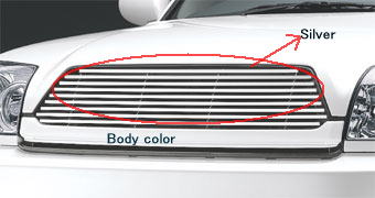

what grill dose ru-kichi have? Is that the Shuei grill? where can i find that in the states?
Hi,
Black Surf's one?(Taro's surf)
This is JAPAN TOYOTA General OP grill,
That is only color "Silver" but he self painted to black!
It's cool!!
http://toyota.jp/hiluxsurf/dop/package/index.html

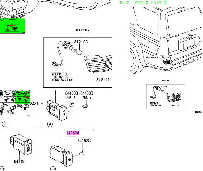

Rear fog assy(R)
81580-35011
Rear fog assy(L)
81590-35011
Rear fog SW
84165-35010

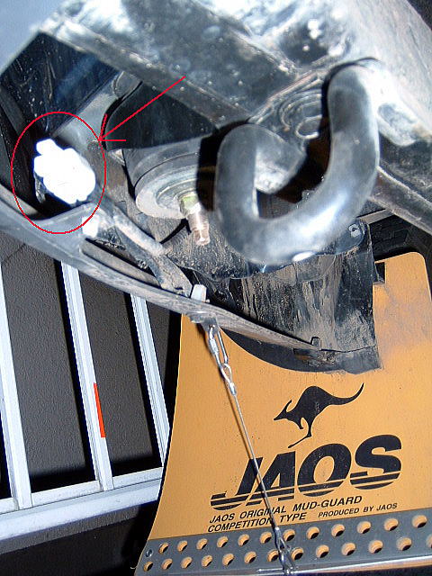

RXvedub said:
i want to know where that wire connects to, behind the bumper
Here!
My Surf '04 First half model,
This models although not used, But there is wiring.
'04 Second half(2004/7~)~'05 models Rear Fog connects nothing,
Factory made only!
Did I make myself clear?

Rear fog SW
84165-35010
Thanks, sharivan.
Now that we have that information, I have some more questions.
How many watts is the 8121OC bulb?
Where is the Rear fog SW (switch) mounted?

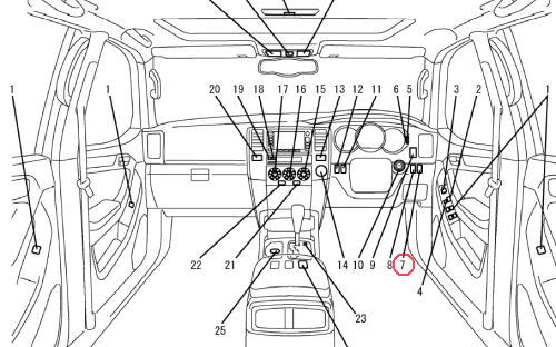

81210C rearfog bulb wattage is 21W,
Rear fog SW mounted No.7(red circle),
Japan Surf's small side lights is Turn signal,
Clear lens & amber bulb 5W,
This is Japanese regulation(Side turn signals)

hey you guys have switches on both side of the steering column. we have 4 on one side
do you have a seperate switch neer the rear fog switch, for the front fog lights? or is the switch on the headlight switch?
