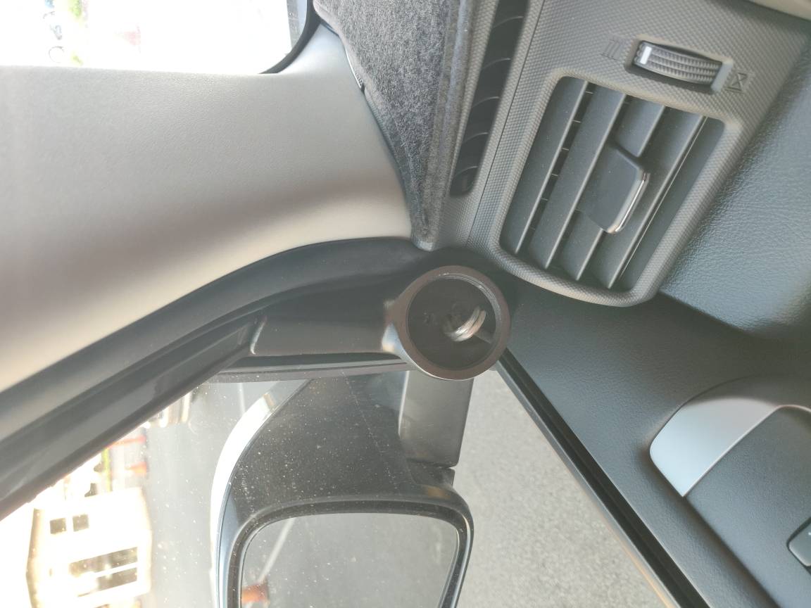

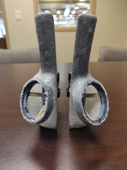

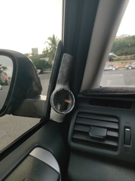

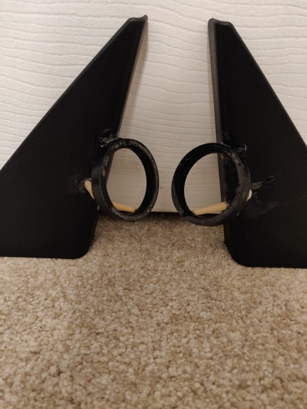

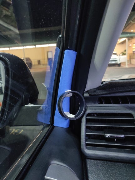

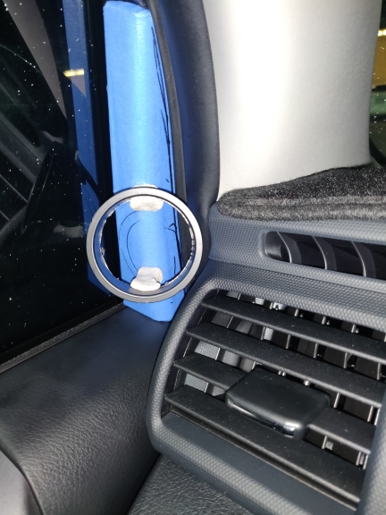

Tweeter mock up. Damn Toyota and your small sail panel location. Not going to be as easy as I originally anticipated. Was trying not to glass, but probably have to....
Sent from my ONEPLUS A6013 using Tapatalk

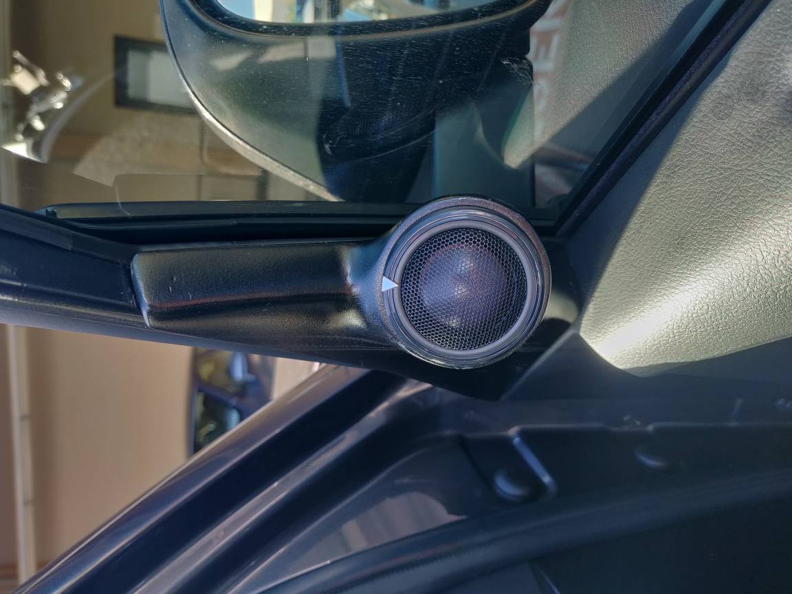

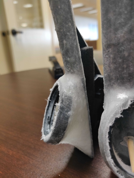

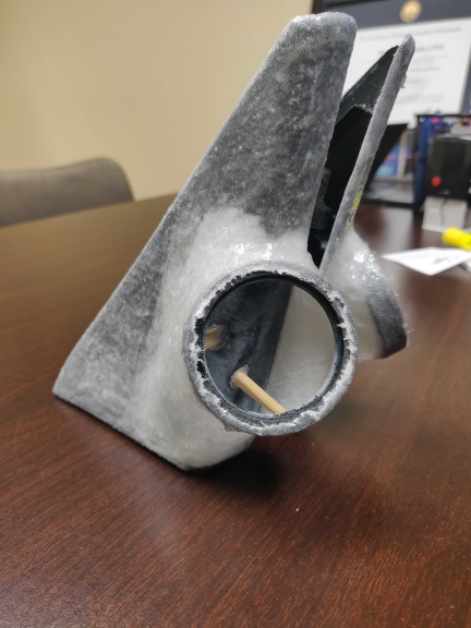

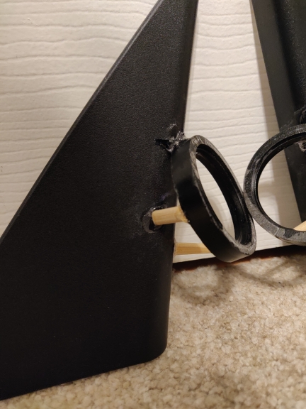

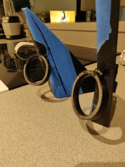

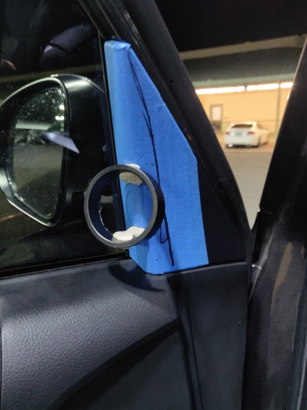

More test fitting. Cut the final bezel rings. Another test fit and alignment in car. Need to cut holes, make reinforcement legs....
Little more progress. Gotta clean up, prep surface and try wrap tomorrow

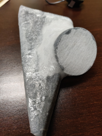

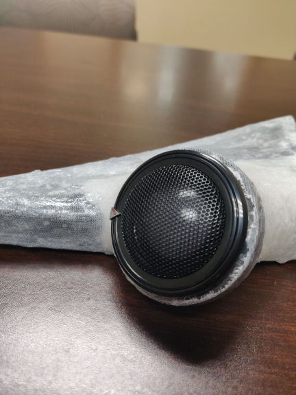

CA glue tweeter pods. Looks like it was doable. First pass. Couple more layers and some filler to go, but promising

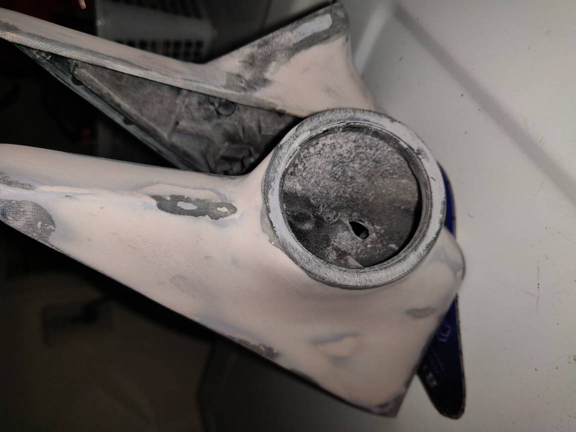

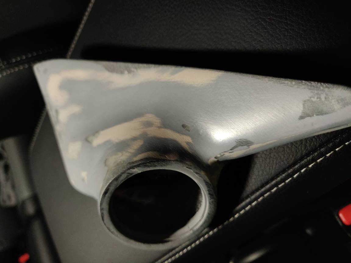

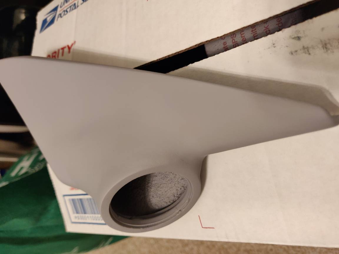

First round of high build and sanding done.... Should have done a skim coat, but was impatient. Shot second coat, too tired to continue. Tomorrow it is IMG_20191122_002251.jpgIMG_20191123_004203.jpgIMG_20191123_012014.jpgIMG_20191123_012118.jpg

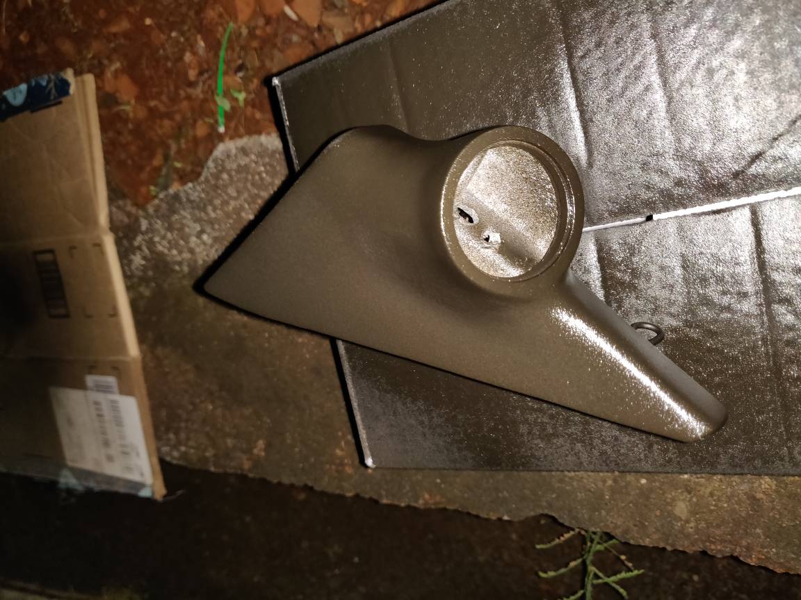

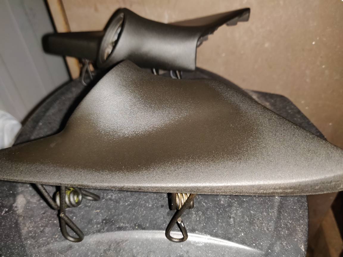

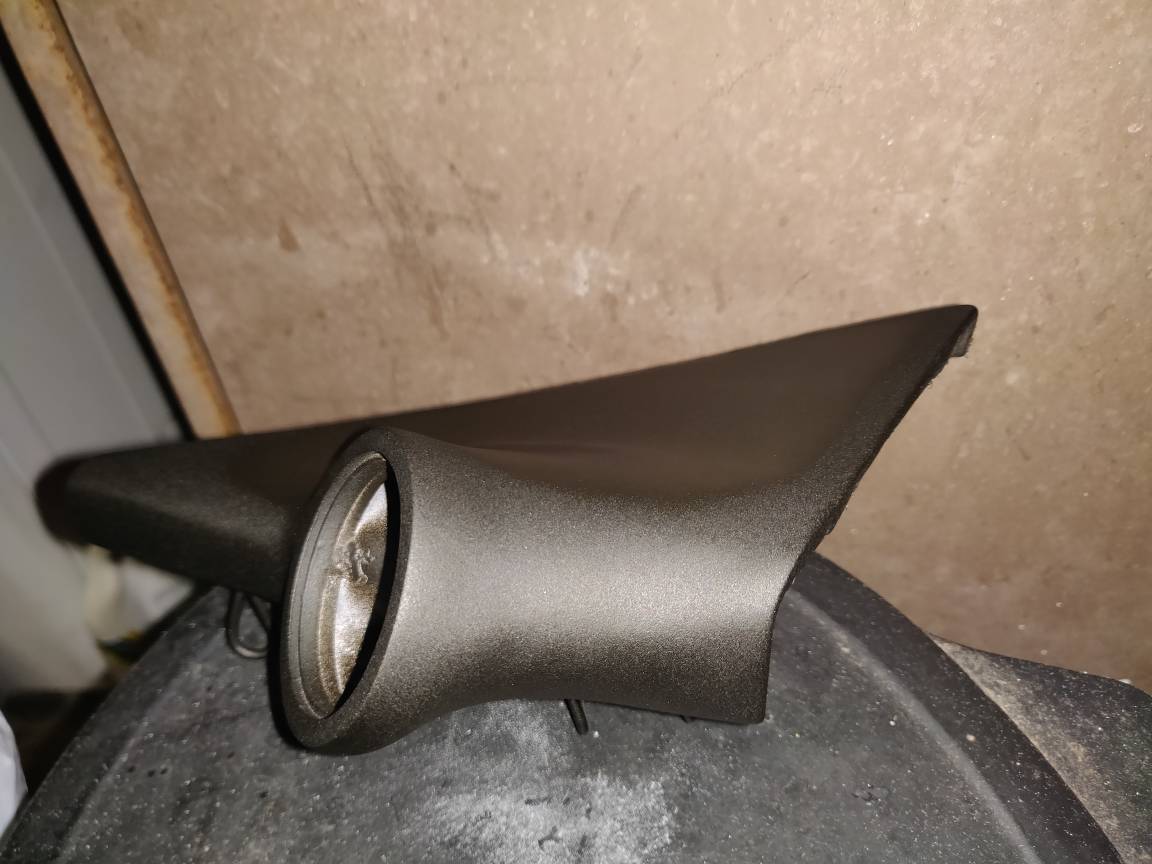

Not quite dry yet. Trying some alternative methods to texture. Undercoating. Hope they come out ok. Waiting for this crap to dry sucksIMG_20191124_002328.jpgIMG_20191124_005314.jpgIMG_20191124_005337.jpg

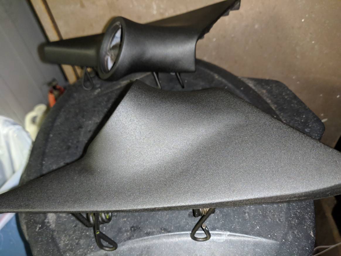

Well... 80% happy with the texture. 50% happy with overall result. Feel like scrapping and stripping it down all over again.IMG_20191124_105723.jpg

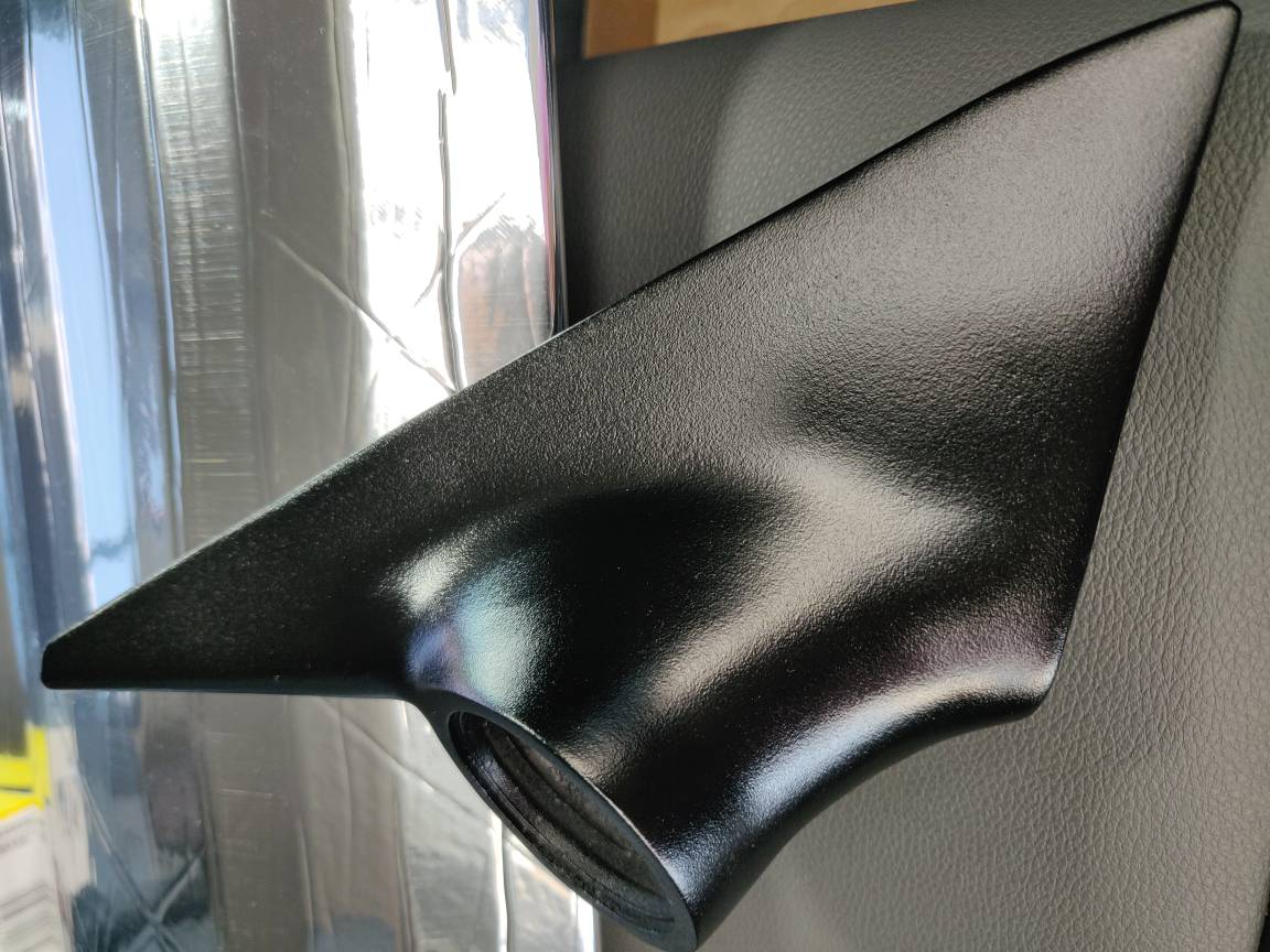

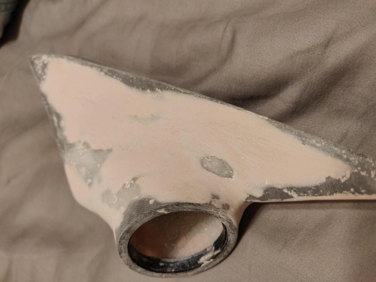

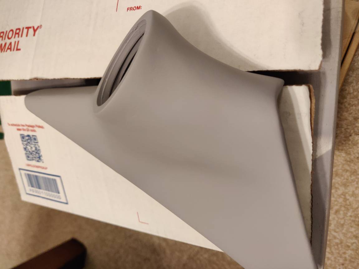

V2.... Stripped. Filled. Sanded to 320. Waiting for vinyl to get in. Gonna try wrapping itIMG_20191125_234359.jpg

I think paint is always going to be the better option. Vinyl shows EVERY little perfect under the surface where-as a textured paint would hide that. Finding the right texture may take a bit, but I don't think you're going to be super pleased with vinyl
Well if comes out like crap, I'll bite the bullet and get some SEM texture and color. Vinyl should be here in next couple days. Says at local post office but yet to be delivered
