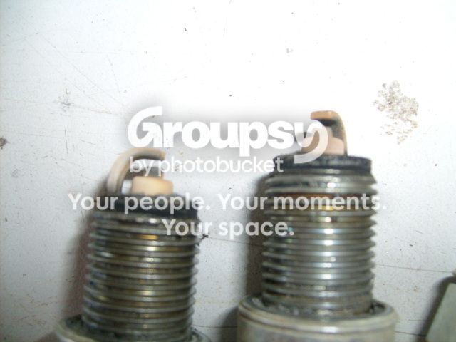

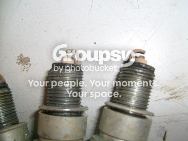

I took a picture of my spark plugs. They are a hotter burning NGK plug. From what I can tell on my plugs is that I am not running rich or lean, the cylinders are burning as they should.
#1 and #2 Spark plugs:

#3 and #4 Spark plugs:

looks like your getting uneven burn which will cause power loss.
