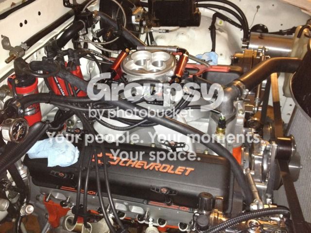

Oh and blingidy blang!

Nate, your blazer is looking sweet!!

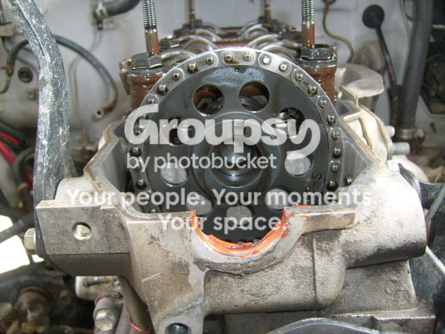

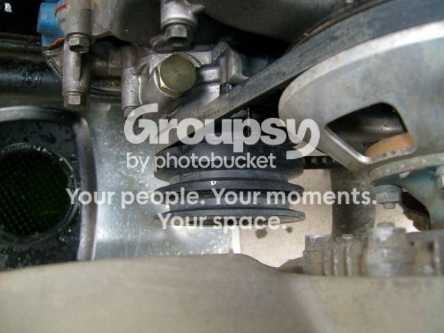

So I have everything taken apart with the exception of the head bolts. I did just find out that either I put my timing chain on wrong or it jumped a tooth. I'm going to assume that I put it on wrong because I don't see it jumping teeth this early in its life. With the crank at tdc, the cam is also at tdc when it should be at the 1100-1130 position.
S6300747.jpg~original
S6300746.jpg~original
This would explain a little bit of a loss of power but not the ascending compression numbers not the horrible leak down test especially when I'm able to move the rocker arms when testing that associated cylinder.
I'm taking the head off soon and will take a peek at the head gasket and the pistons/cylinders.
