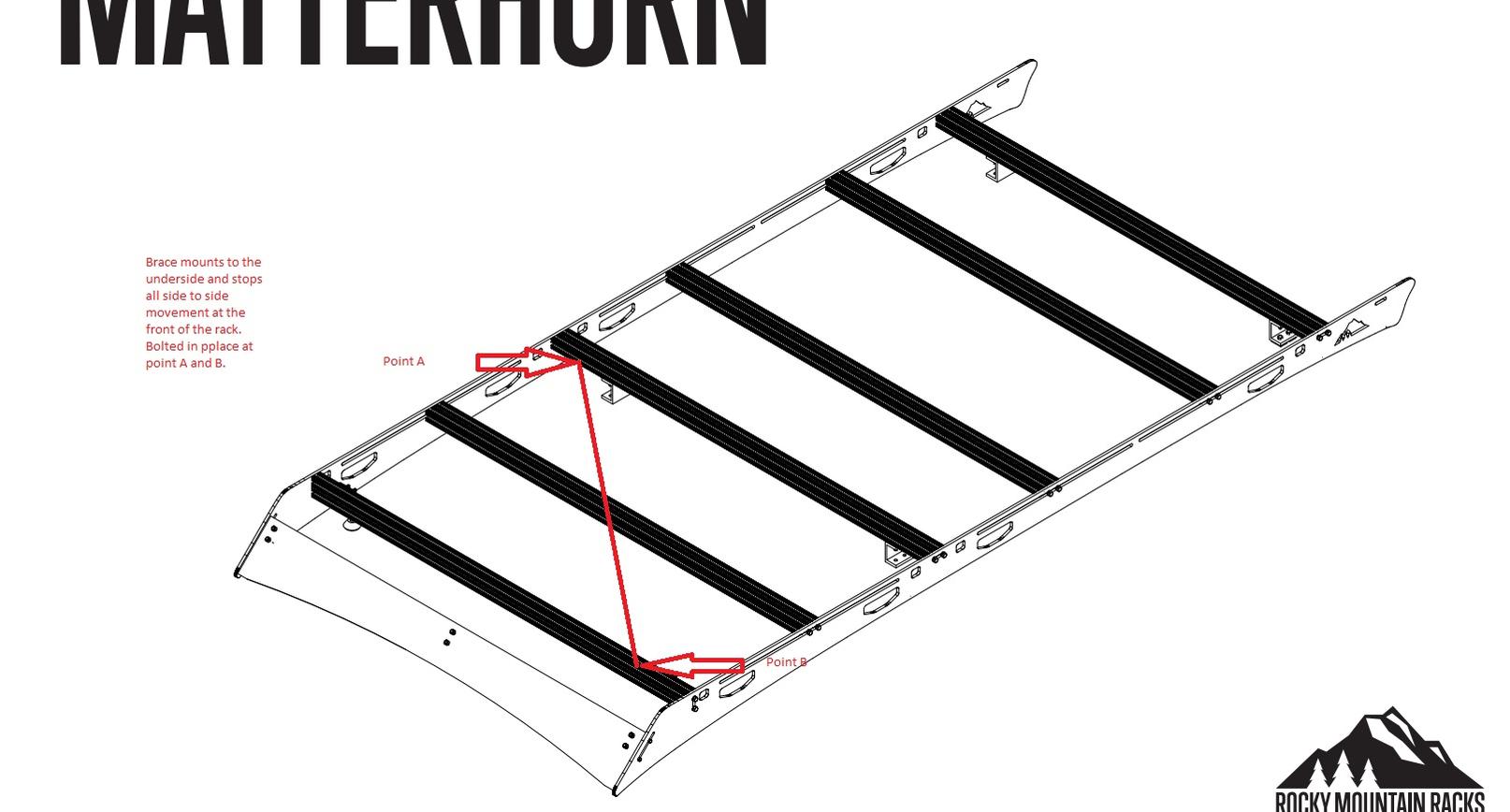

IMO the sides are on the thin side. I can flex the sides by pulling on them. Either they need a brace ran the length of them - thinking a 1/8" thick piece of 3/4" aluminum angle ran from front to rear or thicker material. Weight savings is great but if it damages my rig it isn't worth it. If the sides are reinforced where they do not deflect up/down and side/side then an additional cross brace should not be necessary. But as it is right now the sides are a significant weak point.
*just priced 3/4"x 3/4" angle 1/8" thick and it is a little over a dollar a foot. Looks like I will be doing this sometime before Thanksgiving when I go to Big Bend with my RTT. As much as I have into this rack already a couple pieces of angle and some rivets are not much more. Will check with an engineer friend of mine before moving forward though. I suspect 1/2" angle will do more than I am looking for and is $13 for a 16' stick.

On the note about our side plates, 1/4" aluminum is about as thick as possible within reason. Prinsu uses 3/16" side plates, so in comparison, we are going overkill. We don't see the need for any support along the front like you have mentioned. This isn't to say that it wont make your rack more sturdy, it will, and it may help resolve your issue. With proper pressure on the front feet, you should have no issue without having to add the aluminum angle iron.
As mentioned above we are working on switching from a 5052 Aluminum on our side plates to a 6061. This is due to us receiving unusable rack side plates from our waterjet supplier that arrive warped beyond acceptable use. This is due to the manufacturing process of the metal. Yes, 6000 series is stronger, especially when not used for bending etc, but it is not the cause of your deflection up front, nor would it fix the aluminum from being prone to deflection side to side.
Overall, what I'm trying to say is that I think the feet may have been too loose on the racks that have had issues, and I think an easy solution until we find an adhesive that holds much stronger is to be sure that the pressure on the front feet is adequate to stop access movement at the front of the rack.
