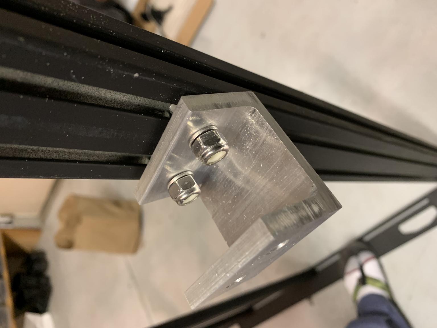

Having trouble tightening the nylon nuts, they just keep spinning. Any suggestions? Excited to put this thing on the 4Runner

It is possible, yet unlikely that the nuts were cross threaded causing the carriage bolts to be over tourqed and spun in the crossbar. It does not look like that is the case though. Are you able to take the nuts off still? If not try sliding the carriage bolts out of the crossbar and see what is going on.

Hard to tell from the pic but it looks like maybe those are hex head bolts and not the carriage bolts? The hex heads are metric, carriage standard.

Took all the nuts off. I'll have to pull the bolts out and see if I used the right ones.
This may be the issue. I'll take a look tonight. There were a bunch of carriage bolts left over when I got stuck here...
