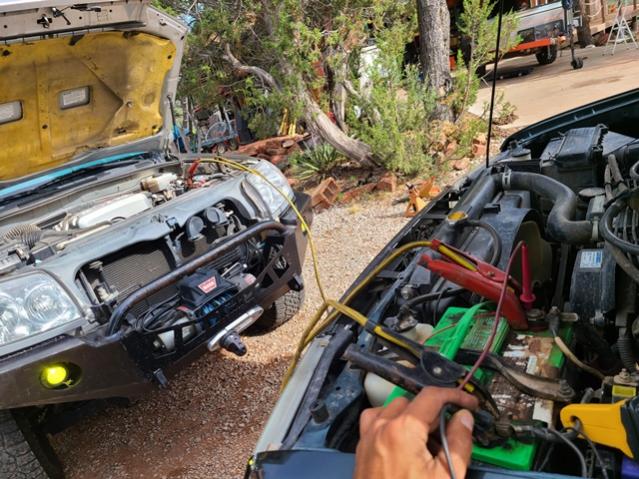

My daughter came over last night so we ran some quick checks before the monsoons hit and we ran for indoors.
Here's a video of the starter pulling 400 amps :shocked: My normal DC clamp is only good for 100amp max, so I had to pull out the big gun which is 400 or 1000 amps. In the video I mistakenly said 400/100 amps.
Anyway, as you can see, the starter still cranks slowly even with a second vehicle giving it lots of juice. Charging voltage is around 13.5ish but that starter is drawing down a one year old battery quite a bit.

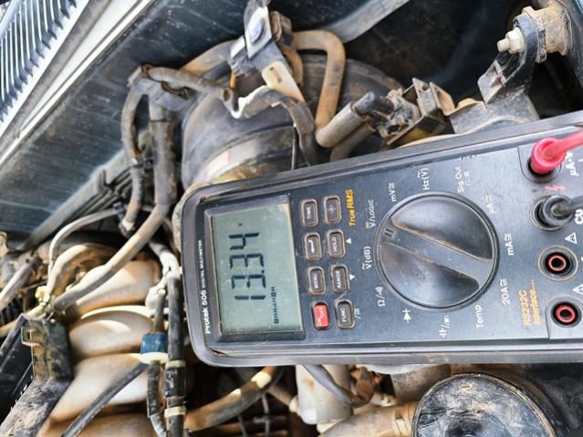

With a hot engine and the EFI fuse pulled it started out at 190a and went down to 130a after a few seconds of cranking. Did it twice for at least 5 seconds.
Any electronic motor starting will surge. That's what I would expect. :)
