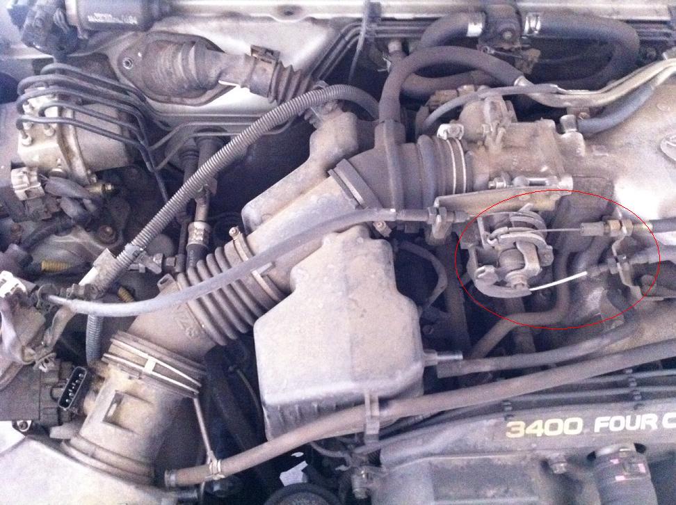

Shot in the dark because this is not my area of expertise, but maybe check the throttle and kickdown cables (circled in red below) to make sure they are not loose or broken.

thats not a kick down cable. its a pressure cable. If you dont believe me pull it out and ziptie it or something and put it in gear like a cheep shift kit
The A340 transmission thats in the 4Runner is electronically controlled by the engines ECU. It uses the throttle position sensor and the speed to calculate what gear to put it in. So as said above Check Engine Light would go off if there was something wrong detected. If ya really need to you can always down shift by hand.
