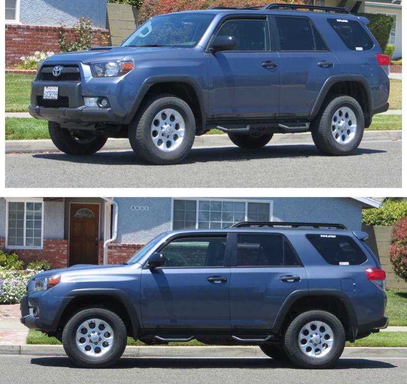

I did 0.85 on the front 5100s to get a more level look. I added Airbags for when I pull a trailer to keep it level.
Is that front shock setting for a level height? I’m getting my Bilsteins installed Tuesday and want to just level my SR5 out….
Looks like this with 0.85 I was afraid to go with 1.5 and get a negative rake. Did not want to add a spacer for the rear.
