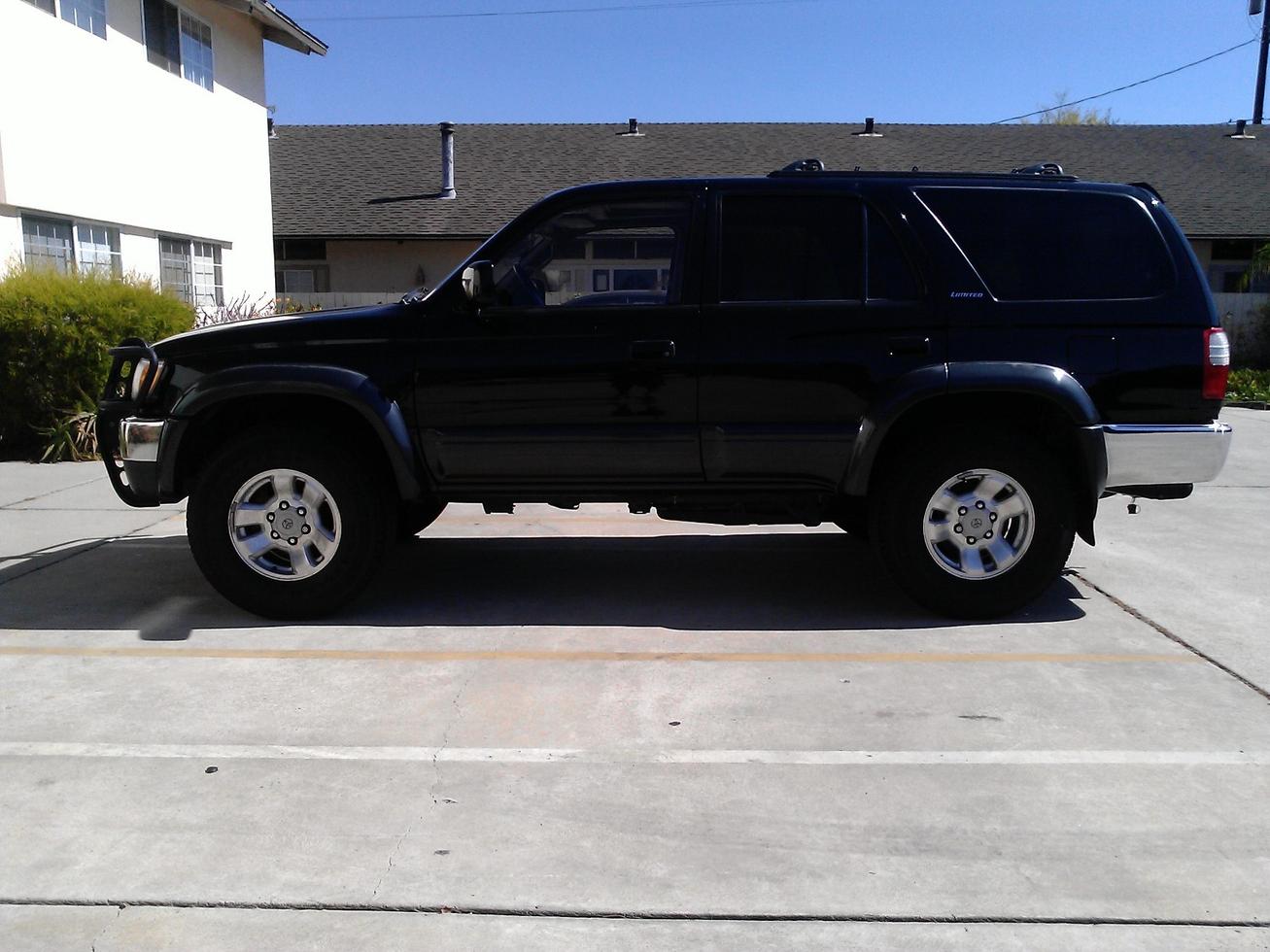

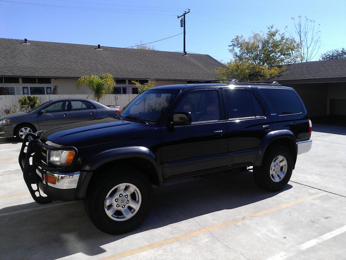

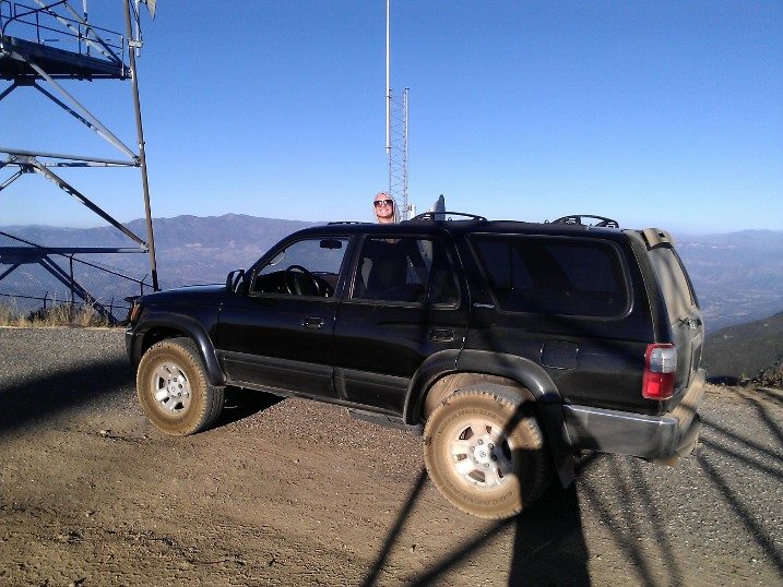

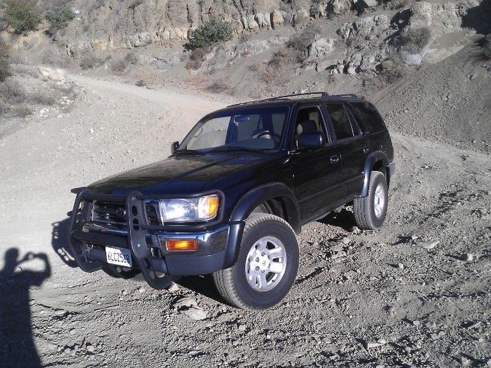

I just bought a 97 T4R Limited 4x4 with a locker and 157k in September. I bought it because my fiance and I are planning to take a 3 month surfing/overland expedition through Baja, Mainland Mex, and Costa Rica in the summer of 2015. It is my first truck/suv. I just installed a B&M super cooler to eliminate the pink milkshake and am now looking to upgrade the suspension. I have looked all over this site including the FAQ lift link and expeditionportal.com but have not found what I am looking for. This is my daily driver so I do not want to lift it 3 inches, lose mpgs, and wear out other components, especially since we will be spending time in Mexico. Reliability is #1. That's why I bought the 4Runner.
We do some light wheeling in Santa Barbara where we live and I want to explore Baja off the beaten path. The truck has preformed great so far and I love it but the rear is sagging just a little. It has a bull bar on the front and I will be adding a big cargo box in the back and a roof top tent. I was planning on the OME shocks and springs but a lot of people didn't like the stiffness of the ride. The future wife needs to be comfortable for me to enjoy this trip and won't let me spend a fortune. I am open to just about everything. Thanks for the help. Also has anyone else on here done this trip? Surfboard security is a major issue for me.
Here are some pics so the thread isn't "useless."
