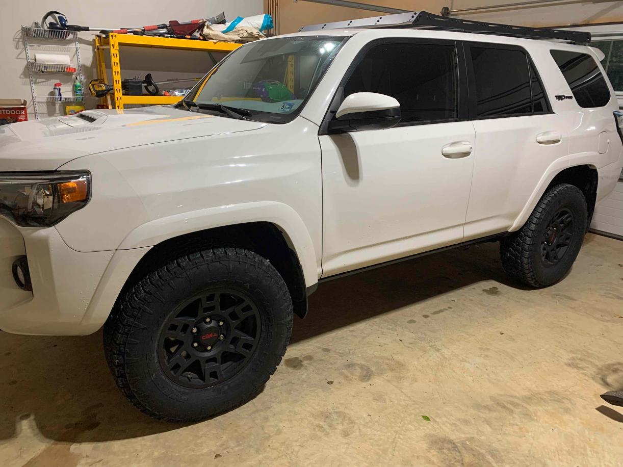

I ordered 265 70 r17 tires. Went to pick up and thought they looked a little big. Checked when I got home and sure enough they installed 285s. Double checked paperwork and I ordered and paid for 265s. Not sure what to do. They look great, but I have some rubbing at full turn. I'd love to keep them, but not sure I want to go down the road of modding to make them work. sigh.

Well..... that's an interesting problem to have. Are they P-metric of LT tires? Judging by the picture, they might be p-metric, which wouldn't take a bunch of mods to make fit, just a little fender liner trimming and heating/shaping.
I suppose it really depends on what you intend to do with your 4Runner. The larger tires would have a slight negative impact on fuel economy.
If it were me, and my intention was to keep it near stock, i'd likely bring it back to the tire shop and have them put on the tires I ordered. If you have any intention of adding a small level, lift or anything, then I'd keep em.
You may need to trim the bottom edge of the front fender, push the liner forward, and remove the mud-flaps. If it still rubs you may need to hammer the bottom 6-8 inches of the pinch weld. Plenty of videos available.
I run 285s on a modified rig. If you want to keep yours fully stock, avoid all rubbing, and aren't looking for off-road clearance, you should consider going back to the 265s.
Maxp0wer, I've 285/70/17 with no lift or any other clearance mods. While slight rub at full lock when backing up is present it is a non issue. You got free upgrade for which most of us paid. Keep them and keep on rocking!
I'll at least remove the mud flaps and see if that helps. Hard to test full turn + full travel.
Also, they are LT 285s and almost $100 more per tire than what I ordered.

We ran 265's for a year with no issues, it's a good size, but I'd want a lift with 285's otherwise you're probably gonna be rubbing all over the place.

lol at the comments "you need a lift to fit them" full compression is the same regardless unless you extend your bumpstop to limit uptravel but carry on.......
