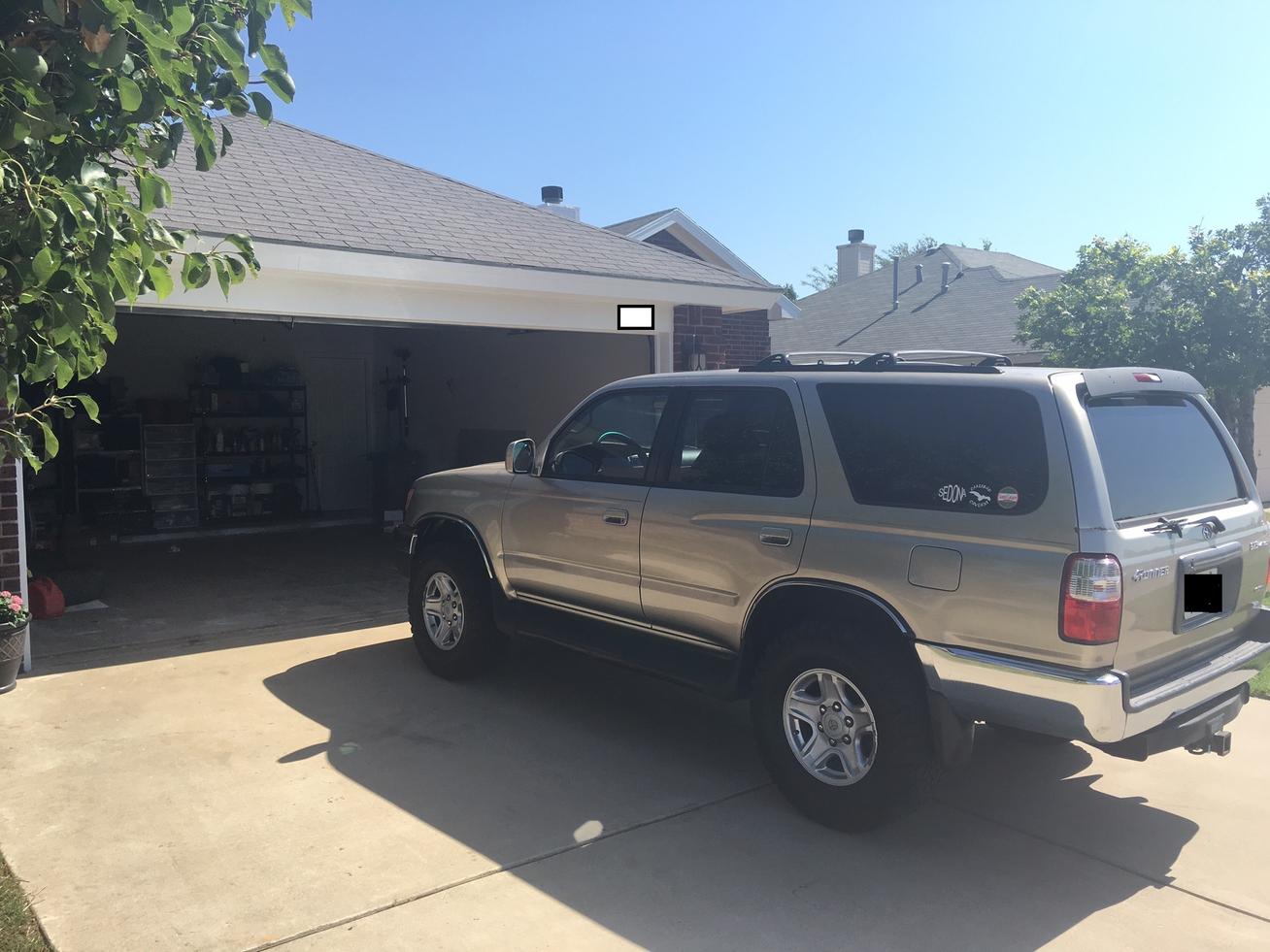

So I've been looking at lift options for the truck I just bought. I think I've decided that the lift springs from OME seem like the way to go for me. I'm leaning towards the 881/890 combination. The truck has 222k on it so I'm thinking I should replace the shocks as well? Or is it possible that I could get away without doing that now and maybe doing it sometime down the road if it becomes necessary? The picture shows how it currently sits on 265/70/16s, any advice is greatly appreciated!

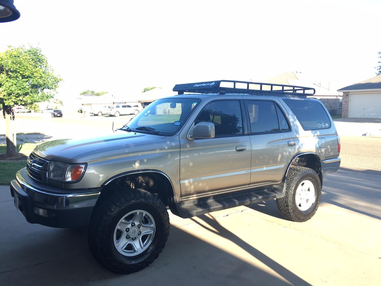

Do it once and do it right. Here's my set up

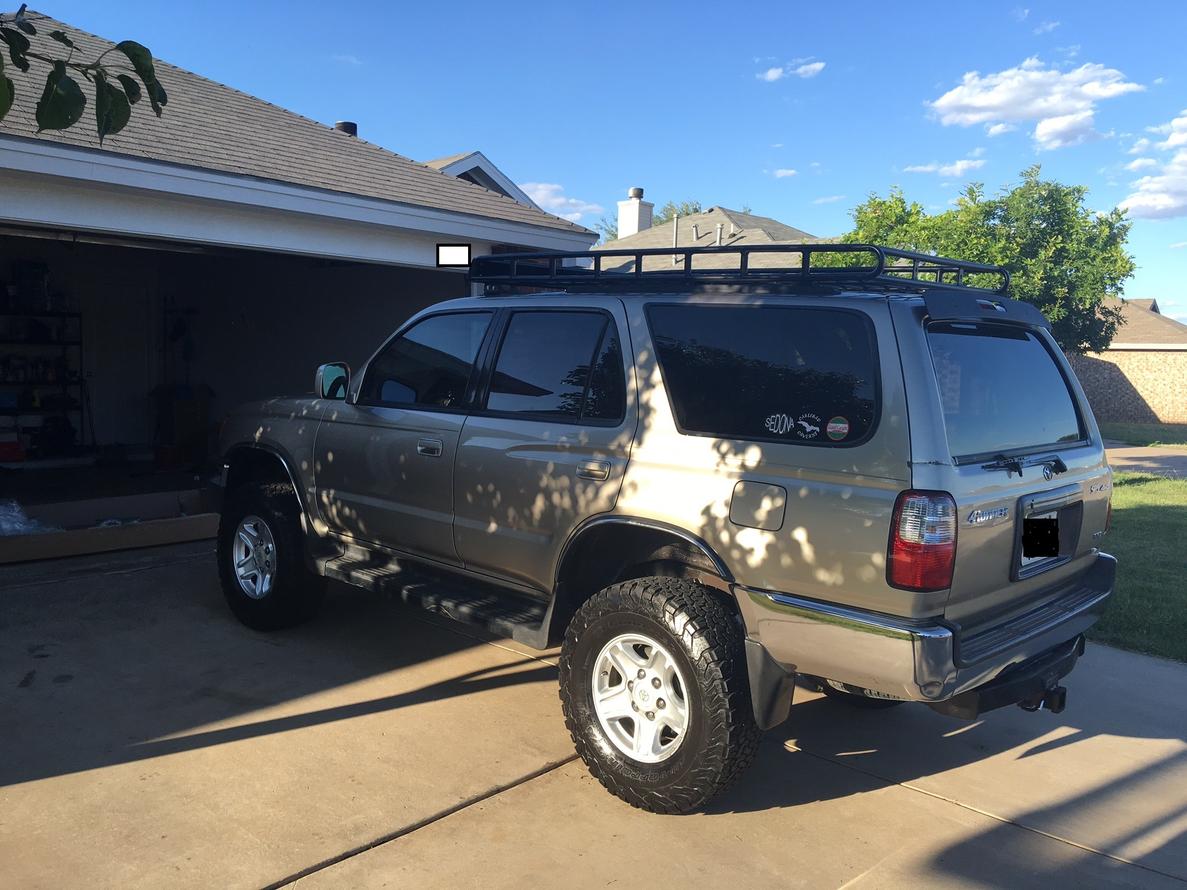

^^What he said. I don't haul enough around to get the Ome shocks. I have 881s and 890s on Bilstein 5100s all around. Front is on the 2nd perch. Love the setup. I've always liked Bilstein so I went with them. I don't regret it. Here's a pic to show you what it looks like. I'm on 265/75/16 though.

I like this but the front end sits a little higher than I thought it would. I just really want to achieve the right stance. I don't plan on wheeling it hard or loading it down with a bunch of overland gear very often it will serve as my daily driver and I'm honestly more worried about getting it to sit right and look how I want it to. My 2nd gen always sat just right and I loved it. I ran 32s on it and everyone assumed it was lifted when it wasn't. So with this I just want it to sit a little taller and make room for a bigger tire but also improve the suspension while I'm at it.
Yes I agree 100%. It is on the 2nd perch in the front. Believe it or not it is still about 1/4 inch taller in the rear. But 3rd Gens need rake to even look level. I had a 3/4 inch rake when it was first installed. And now that the rear has settled quite a bit I will either be dropping it down to the bottom perch in the front or be doing lc coils in the rear to raise it a little bit. More than likely just dropping the front. Because I do like the ride of the omes. Especially when loaded. I would like maybe an inch of rake. I think I could achieve that on the bottom perch.

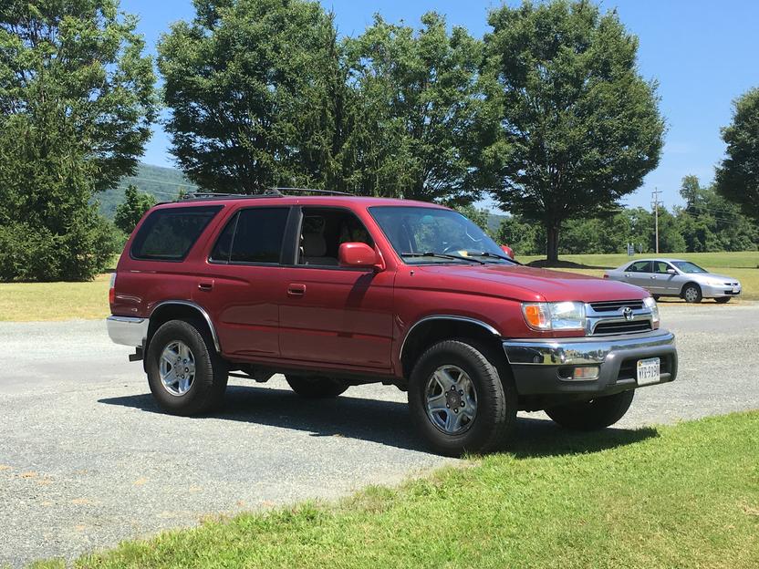

I just replaced my whole suspension with the Sonoran Steel 1.2 Kit.

Don't listen to this guy, he still has his running boards on.
Just kidding. Truck looks awesome.
The Sonoran Steel lifts are awesome. He has put a lot of R and D into them. Probably the best complete lifts you can buy for our 4Runners.
